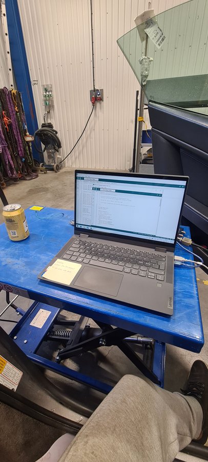

So, managed to get the CAN readings to work.
As of now I'm using OBD2 protocol instead of pulling right off the CAN bus. I'll do some test to see how often I can pull the data I need from that protocol, if it's not good enough I can fall back on trying to decode the manufacturers CAN pid's and calculations.
I recon about 4 readings /sec should be enough, but some trials will see if I'm right.
My setup. PC with Picoscope oscilloscope to look at analog voltages and actual CAN data.
The MCU with a prototyping board strapped under it for DAC's and CAN module. It sure as hell is not pretty but I can lift it up out of the way for the pedals when doing road trials. Used hot glue to make sure every connection stays in place on the board.
Next step is to do some trials with the OBD2/CAN data, as well as some mapping of engine speed versus road speed for different gears. Depending on air in tyres and tyre sizes this relationship will change so I'd like to have a function in the software that automatically calibrates these values as the car travels in different gears. Will have to do some tests to see how/if big effect turning has on road speed readout too, as different wheels travels at different speeds during a turn.
On the other hand, might not be a problem at all and I'm just blowing up this issue. More updates to follow...
EDIT: Another quick update, takes about 10 ms to read engine rpm with OBD2. That's way better than I thought and will suffice.
