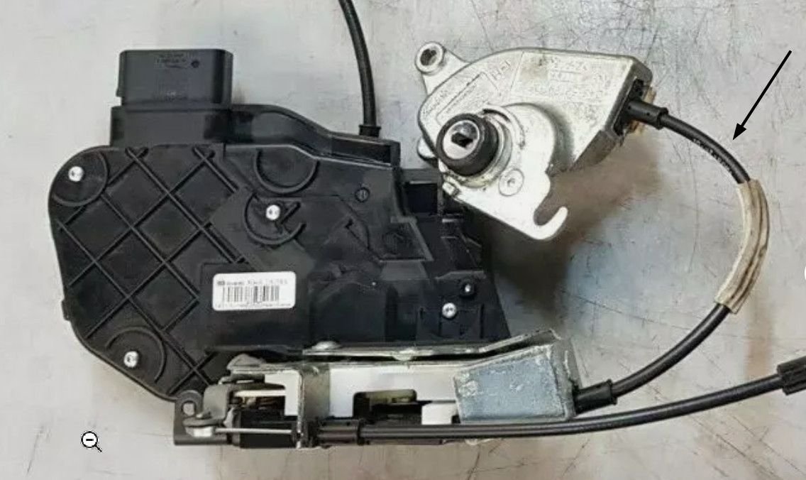

I’m guessing that the cable is either broken or separated from the latch. So it can pull the cable but when it pushes the cable the conduit moves away from the latch rather than pushing it as it should

I went to the dealer to have my tibbie key cut from my VIN and I am having the same issue of not being able to unlock the doors.
The locks at 1st were VERY gummed up so i am suspecting the cable (as mentioned above) is at issue, which seems like a whole lot of work to get to.
Has anyone been into that area and worked on the locks that could share a little perspective?

If there was an issue with the cable itself, could we still open the doors by using the handles? Whether we lock/unlock by the Tibbe key or the fob?

Judging by his photo it appears that you can. The key lock cylinder has a dedicated cable and the door handle handle appears to have its own dedicated cable as well.

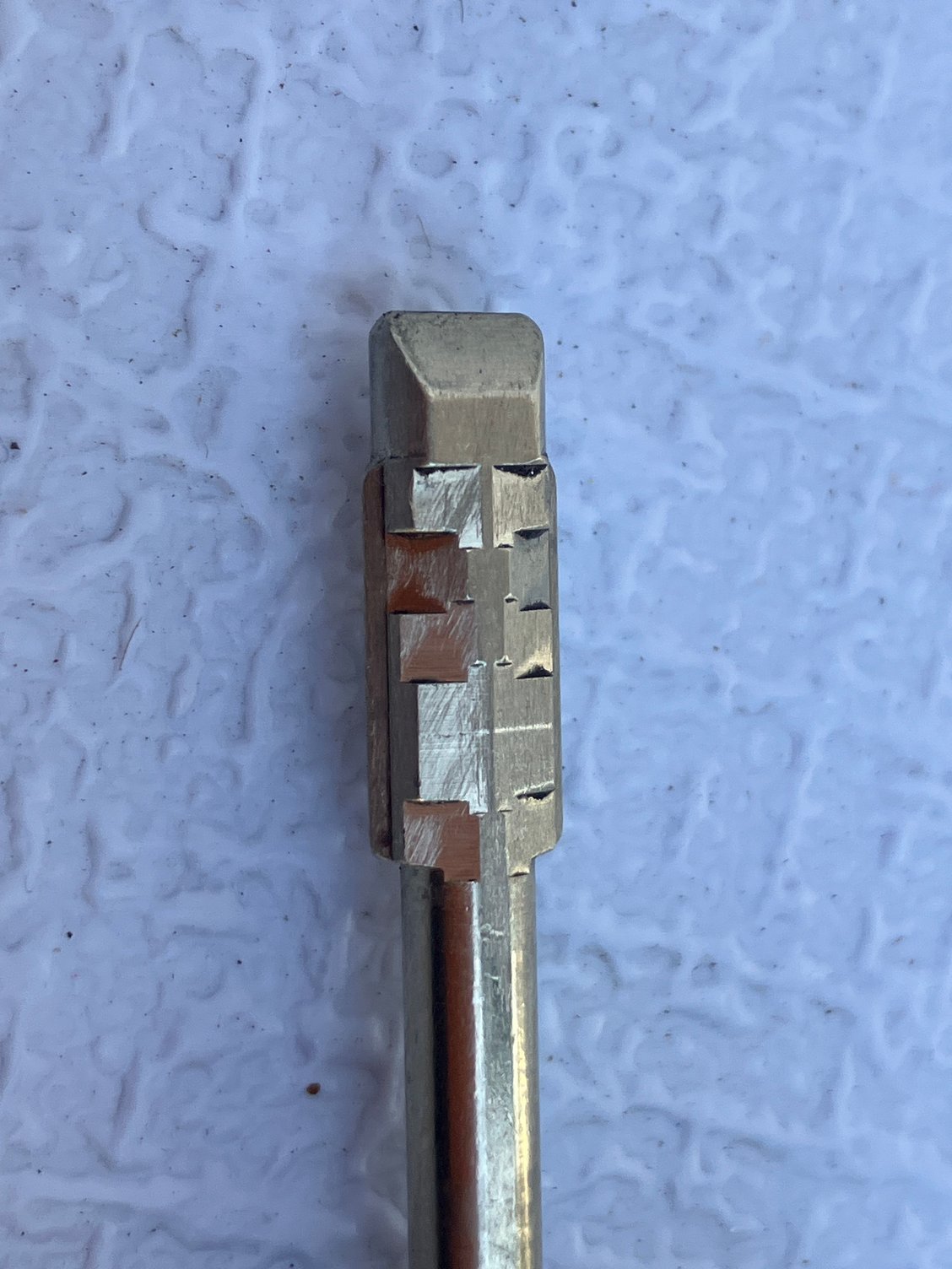

I am starting to wonder if the locksmith didn't cut the key in the reverse order?
Do you guys see a 322342 or 243223 code on this key?
Old Oct 19, 2024 | 08:44 AM
  #43
J doubleU's Avatar
Joined: Mar 2013
Posts: 2,425
From: So Cal
Rep Power: 262
J doubleU Is a GOD !J doubleU Is a GOD !J doubleU Is a GOD !J doubleU Is a GOD !J doubleU Is a GOD !J doubleU Is a GOD !J doubleU Is a GOD !J doubleU Is a GOD !J doubleU Is a GOD !J doubleU Is a GOD !J doubleU Is a GOD !
322342, the key code starts at the back of the key as that would be #1 on the face of the barrel.
Thank you for confirming, now I can rule out the locksmith cutting the key in the reverse order...
