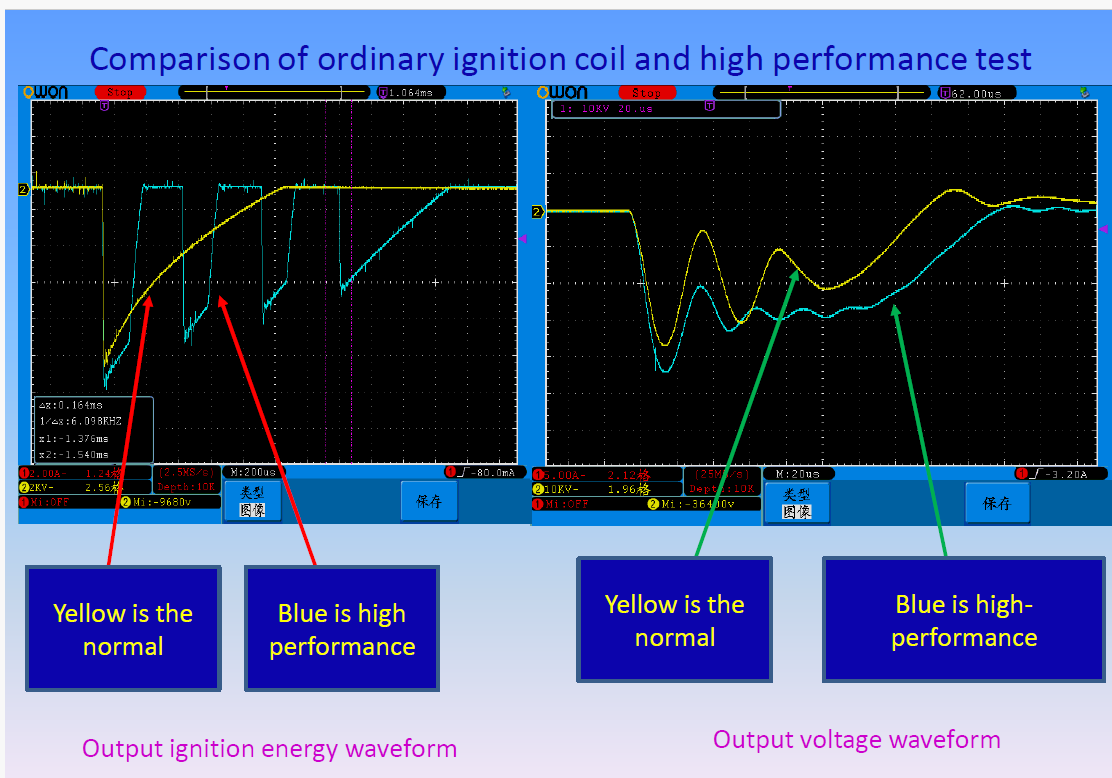

Hi all, is there any of you already order and use DMCOIL performance coils ?

Those red ones are not the same than the black ones , internal coil is upgraded for " performance" as the vendor said , but i don't want to break the engine .... that's why i hope someone can provide feed back on those red ones

Apologies for the late reply. I am not sure what they mean by "performance" but they could have corrected some of the inherent weaknesses of the coil design. Can you please email DMCoil and ask them to compare the red ones vs the ones here?
https://www.aliexpress.com/item/1005001523231768.html?spm=a2g0o.productlist.main.1 .acf6sXVjsXVjvJ&algo_pvid=fda7ae93-a31b-4d17-869e-19e808914577&algo_exp_id=fda7ae93-a31b-4d17-869e-19e808914577-0&pdp_npi=4%40dis%21EUR%21249.99%21249.99%21%21%21 253.08%21253.08%21%40211b61a417349081575005256ea2d 5%2112000016462229431%21sea%21GR%212808392563%21X& curPageLogUid=kibYQtK2rHrk&utparam-url=scene%3Asearch%7Cquery_from%3A
The black ones are very good and sturdy. I can post an unpacking video if you are interested. They are heavy and well made and I was very positively surprised as they do not differ from the original ones. I suspect the red ones will be even better but better for DMCoil to tell us what they did with the new design. The black ones work flawlessly though and I have heard about people who put a lot of miles on them with no problem!
The red DMCoils are 50% more expensive than the black ones by the way!
