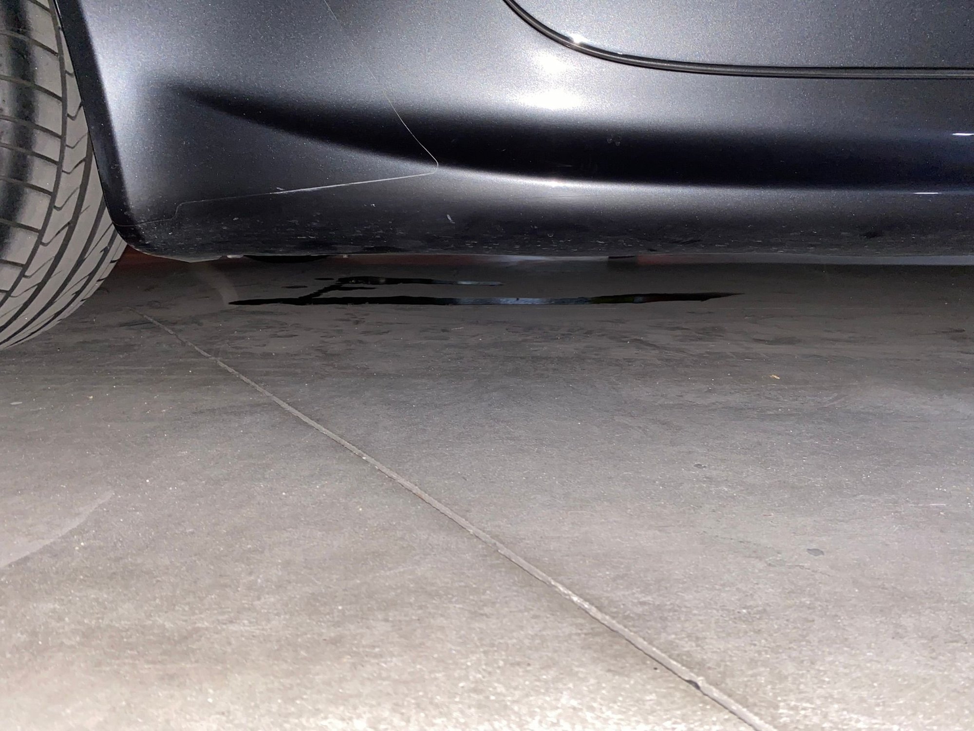

Hi everyone,
I’d like to share a recent issue I encountered with my 2013 Aston Martin V8 Vantage Coupe 4.7 Sportshift II, in case it helps others who might face the same frustrating situation.
🔧 Context:
After performing the annual service (oil, filters, fluids, etc.) and having the car parked for a while due to work, I went to start it to take it for its annual inspection (MOT). Suddenly, the dreaded message appeared:

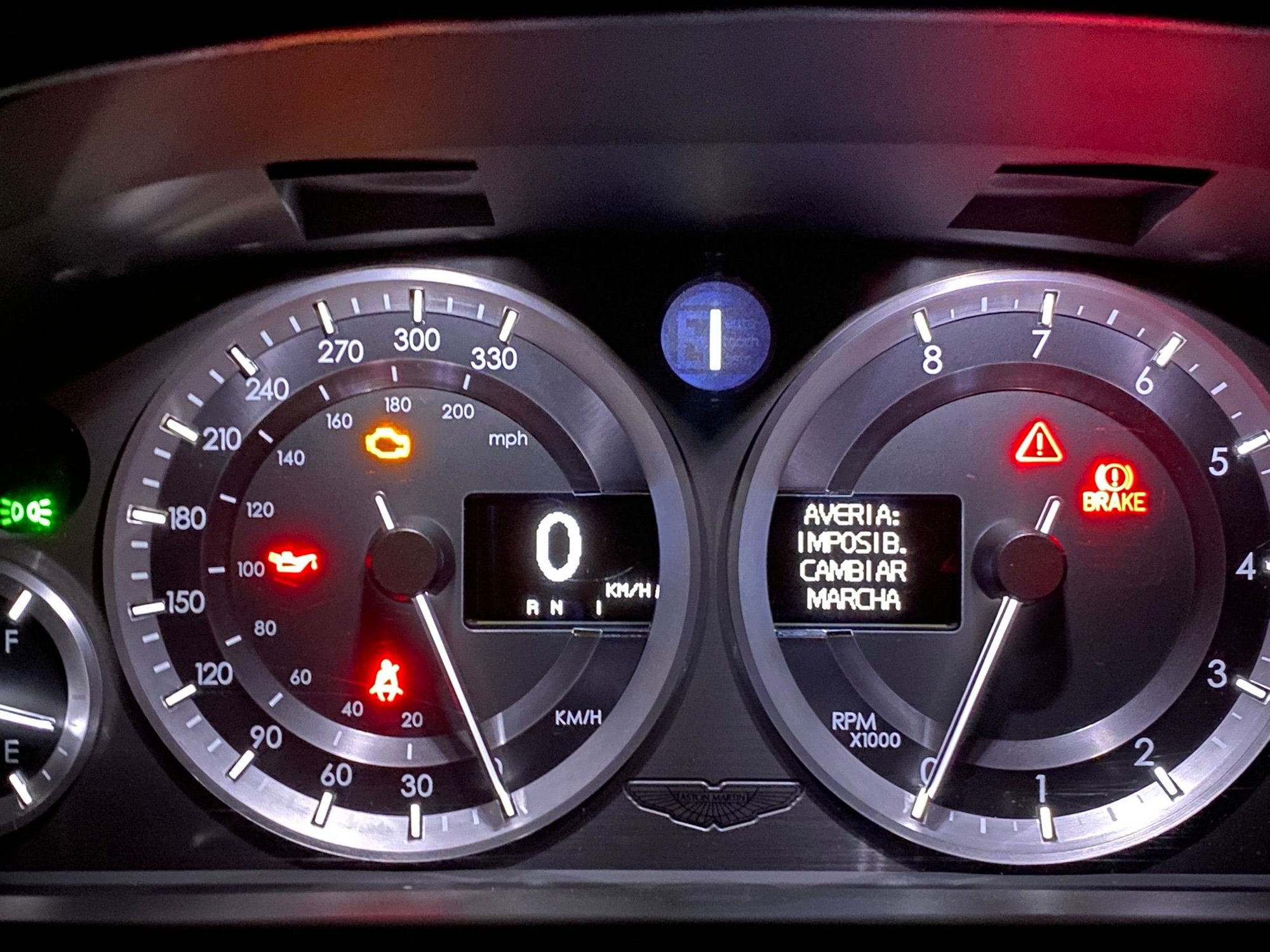

“NO GEAR CHANGE POSSIBLE”
The car was stuck in 1st gear, couldn’t be shifted into N, and therefore wouldn’t start (as we know, this model only starts in neutral).
I could hear the hydraulic pump running continuously as soon as I opened the door — that usual pre-start noise — but it never stopped. Based on what I read on forums, I checked:
  • Battery: OK
  • Fuse 8 (30A) for the hydraulic pump: OK
  • Tried manual override combinations for neutral (as per the manual): no response.

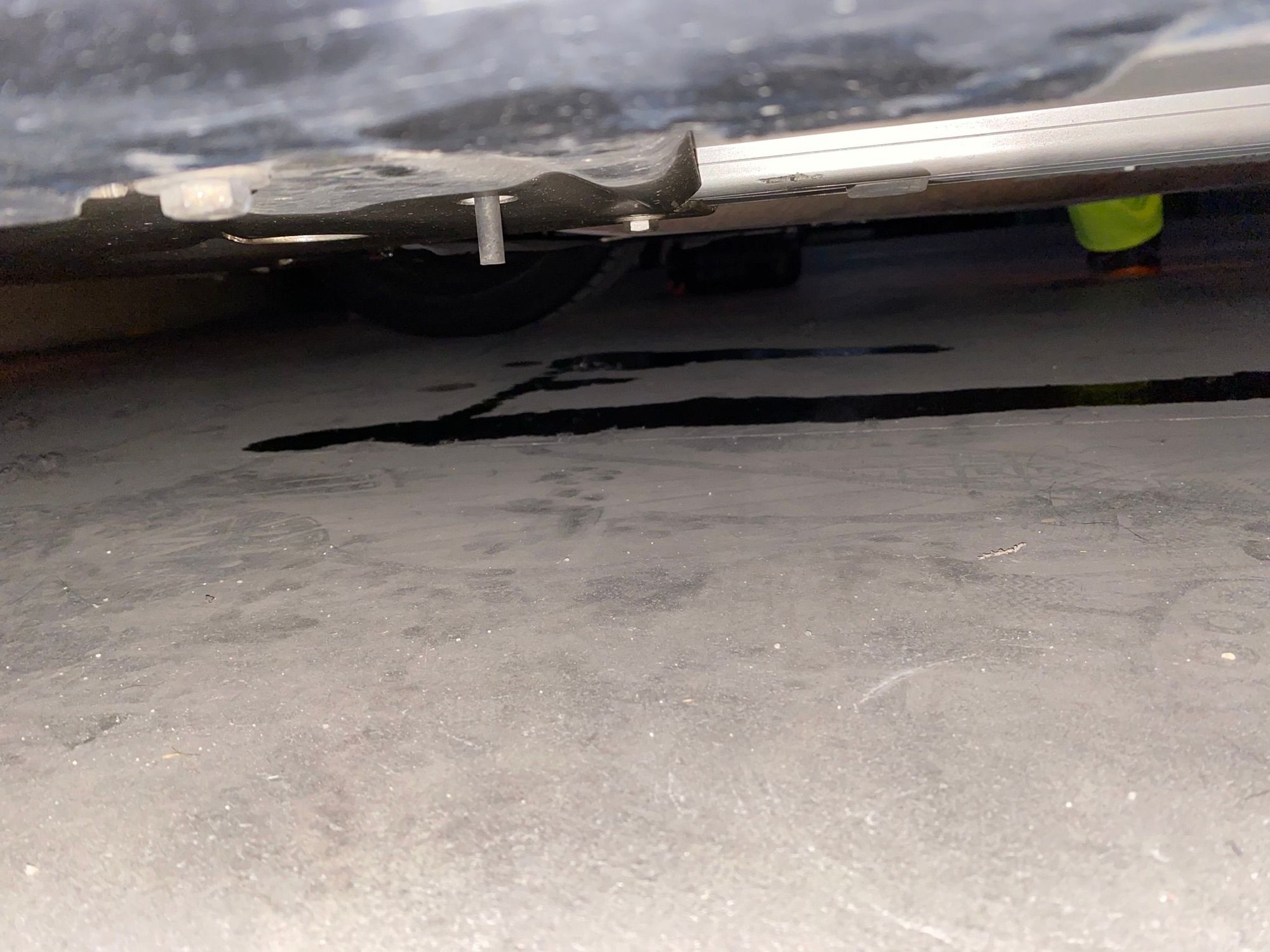

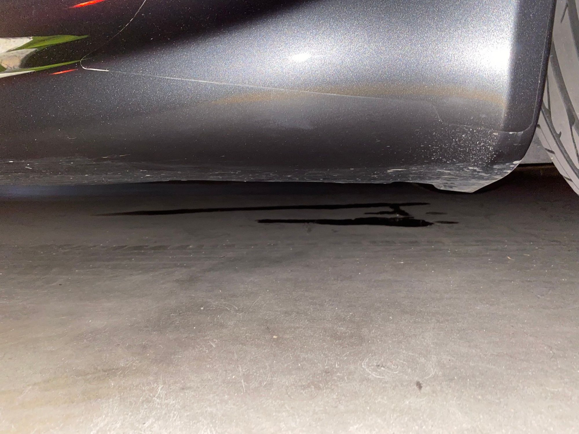

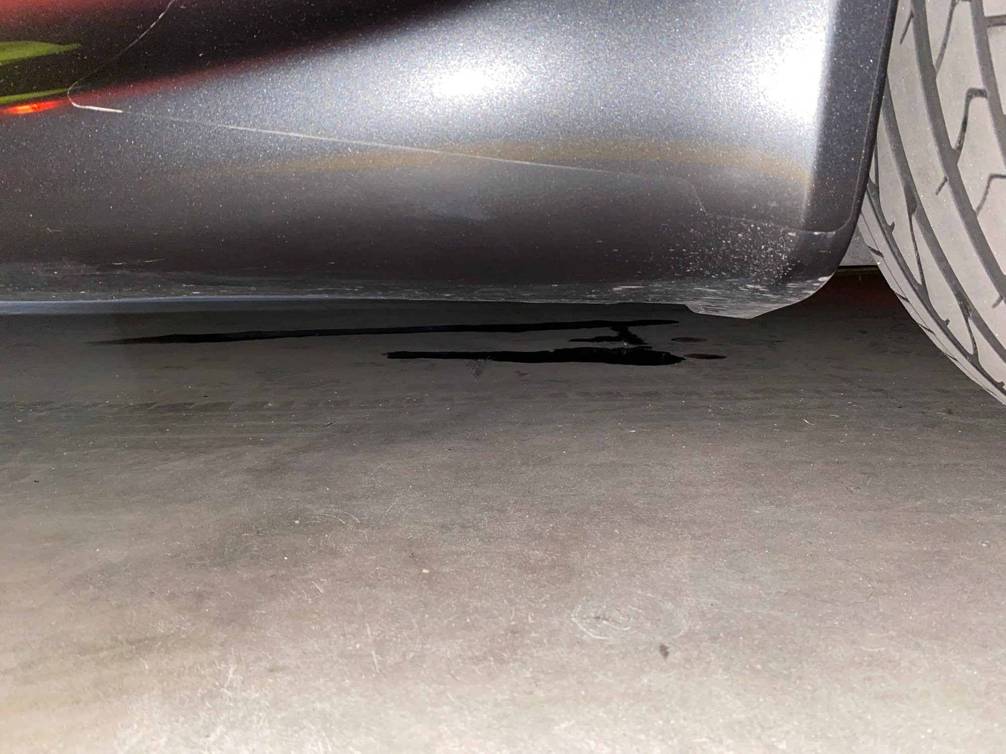

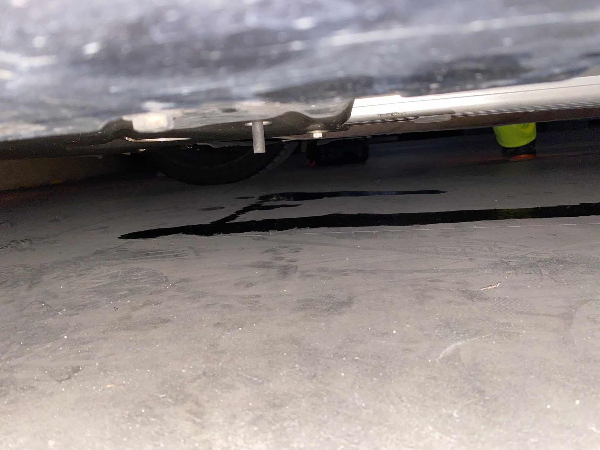

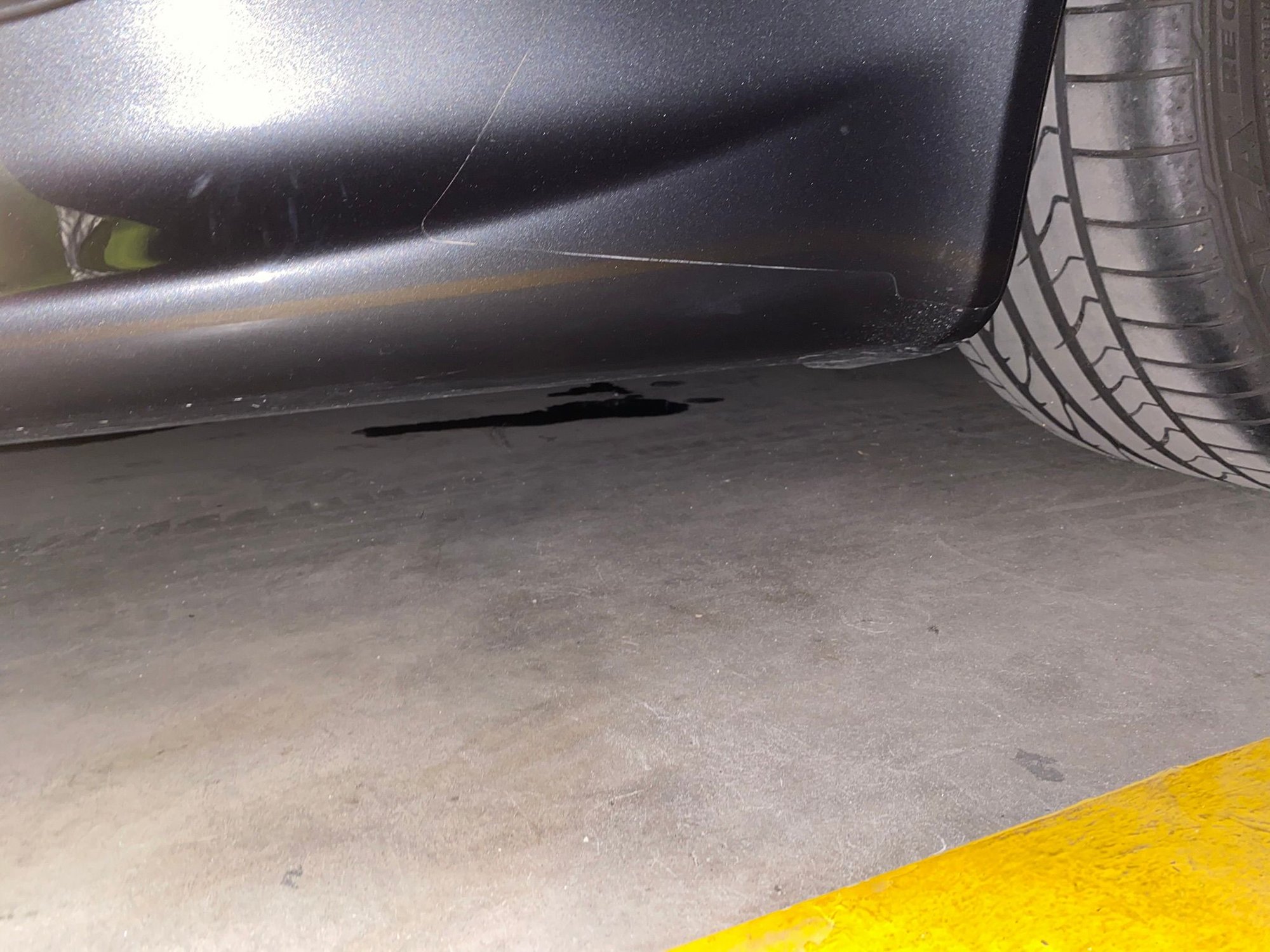

Then I checked underneath and saw fluid on the garage floor, right between the seats and the rear axle. That’s when it clicked: a hydraulic fluid leak in the clutch actuator line. The system had lost pressure, couldn’t disengage the clutch, and therefore couldn’t select neutral to allow startup. The pump was running dry the entire time. (See attached photos: leak in hydraulic line.)
🛞 Recovery challenge:
To make things worse, my car was in a shared underground garage, so the flatbed couldn’t reach it. With the car stuck, no engine power, and the steering extremely heavy (no power assist), I was considering putting wheel dollies underneath and pushing it manually up the ramp…
But then something unexpected happened — a real stroke of luck. While trying to push the car manually with the tow truck driver, the system suddenly managed to engage Neutral, and the engine started. Still no gear changes possible, but at least it was movable.
Once the car was running and steering assist returned, we pushed it up to the garage exit. From there, the flatbed was able to tow it by attaching to the front tow hook, using a cable trolley system ("festoon") for proper alignment.
🧪 Workshop diagnosis:
The dealer workshop told me that although they had performed the recent service (the car had done less than 40 km since), they couldn't have predicted this failure because the rupture started from the inside of the hose and leaked outward.
Frankly, the explanation felt weak — the hoses were clearly deteriorated (see photos). Still, no option but to fix it.
🧰 Repairs performed:
  • Replacement of full hydraulic hose set:
    Part No. BG33-7H394-AA
  • Hydraulic fluid refill (OEM Aston Martin fluid):
    Part No. 6G33-19H373-BA
Parts source: Eurospares – Aston Martin Parts
💶 Total cost (labour included, with 21% discount):
943€
