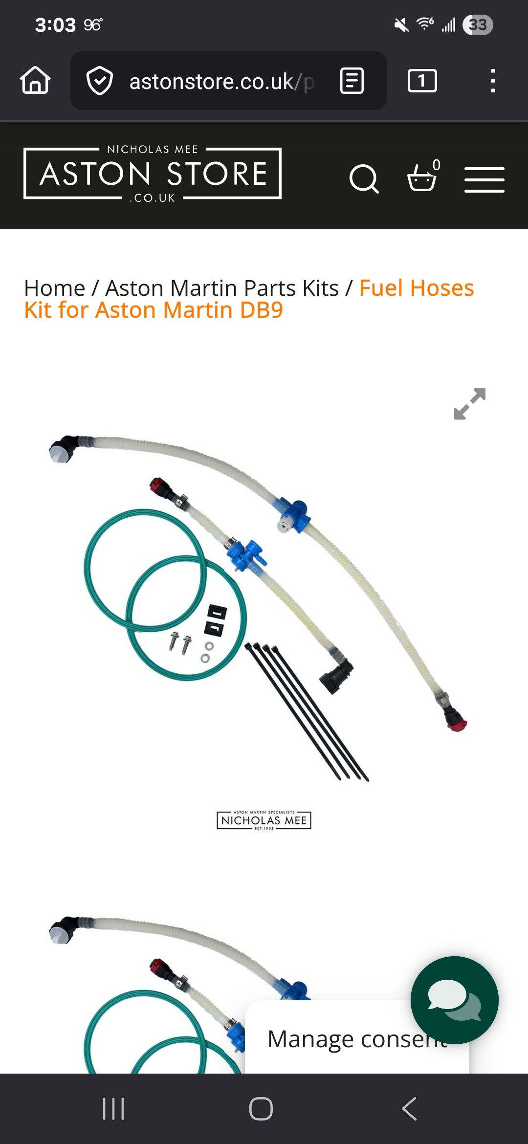

Not sure what it would cost with import fees and such. Might be able to order from a local dealer.
this is the check valve people
are referring to ? You know the part number ?

Also... I'm not sure what to make of those fuel lines reference at AstonStore. The red connector is meant to attach to the fuel filter of the 2007 and earlier cars and the only right angle quick disconnect in the tank is at the bulkhead fitting to exit the tank. That and the hose length say to me that it's not meant for 2008 and later cars. Not to say you couldn't just remove the pressure valve from the lines and use them to rebuild them on the later setup. If those *are* meant for =<2007 I wonder what you're meant to do with a leaking pressure valve directly attached to the pump cannister. Perhaps the two small screws are meant to jam the original valve closed? strange.

J doubleU's Avatar
Joined: Mar 2013
Posts: 2,428
From: So Cal
Rep Power: 262
J doubleU Is a GOD !J doubleU Is a GOD !J doubleU Is a GOD !J doubleU Is a GOD !J doubleU Is a GOD !J doubleU Is a GOD !J doubleU Is a GOD !J doubleU Is a GOD !J doubleU Is a GOD !J doubleU Is a GOD !J doubleU Is a GOD !
There is a VIN range for these hose kits.
A/B 09174 to A/B 10560 kits used to be about $300.
