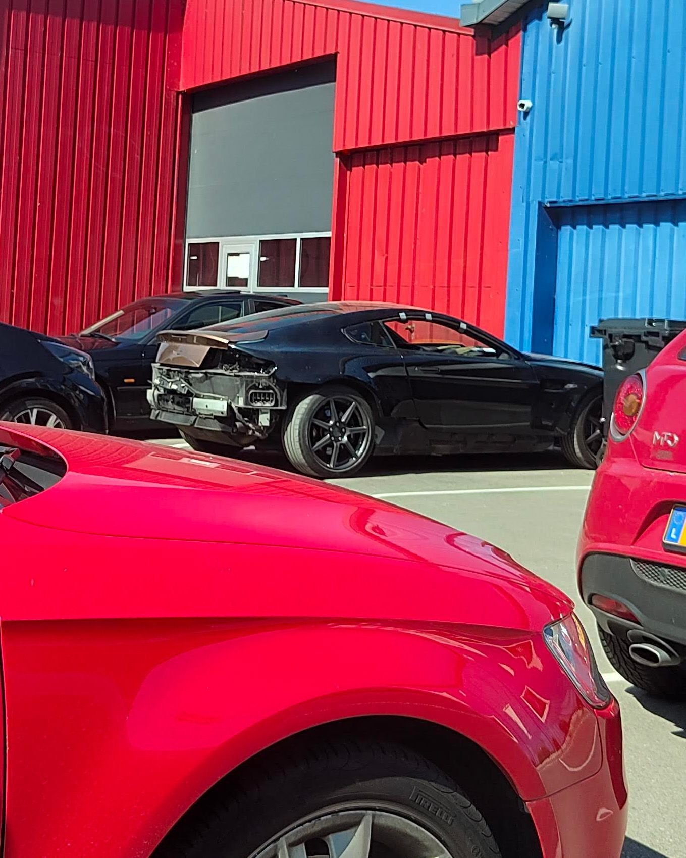

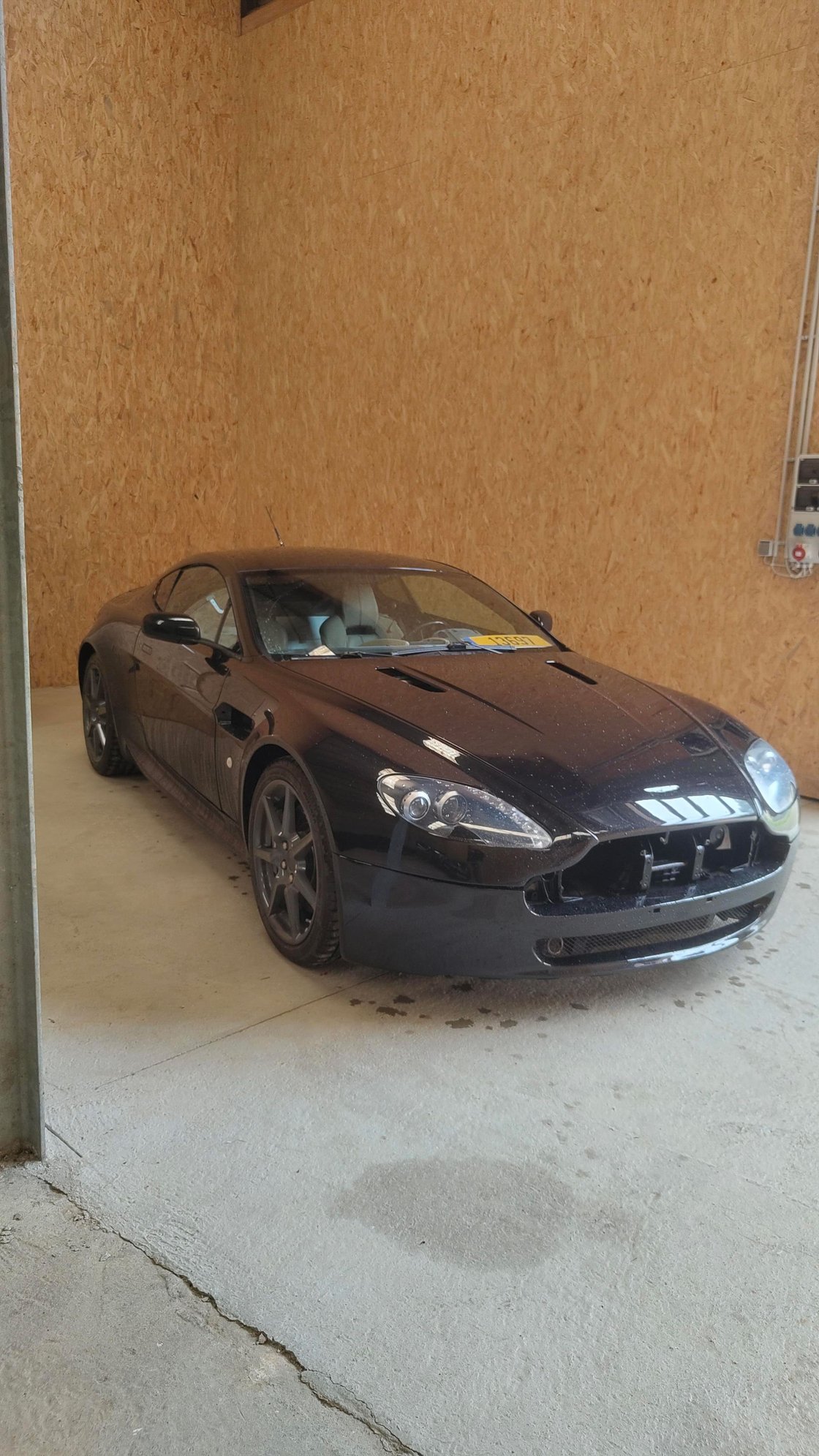

I decided to bring it back to life with a complete repaint in OEM Onyx Black. I stripped the panels and made as much prepwork as I could, the shop fixed the rust, and got the finish right this time.
While the car was apart:

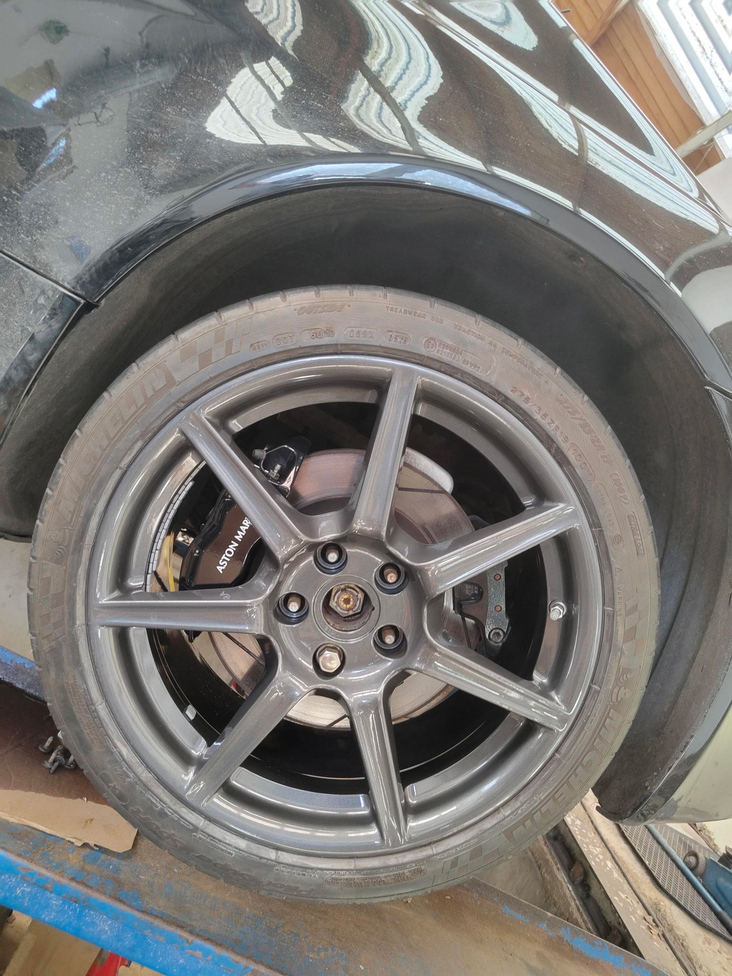

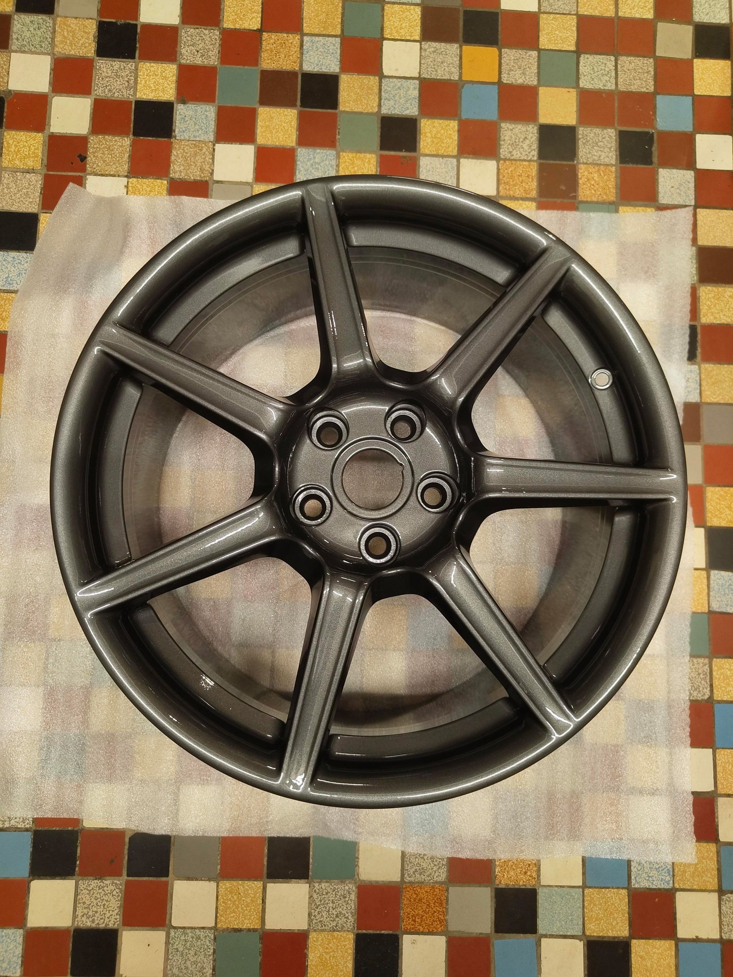

  • I Repainted OEM wheels in anthracite (powder-coated)

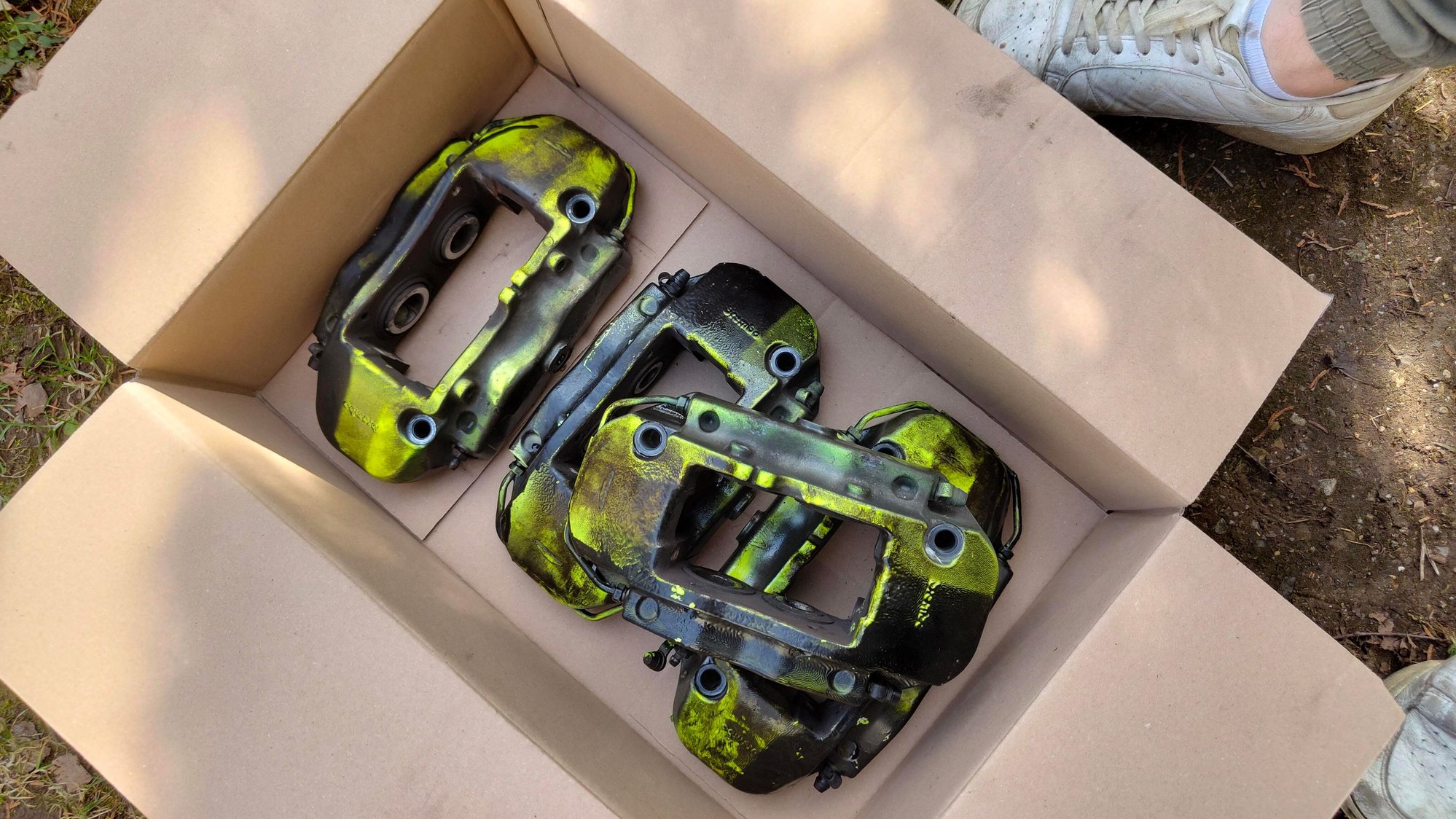

  • I stripped and powder-coated the calipers black with white “ASTON MARTIN” lettering
  • Installed HEL braided brake lines (took 3 months to arrive — and they sent two sets, so one’s for sale if anyone needs it)

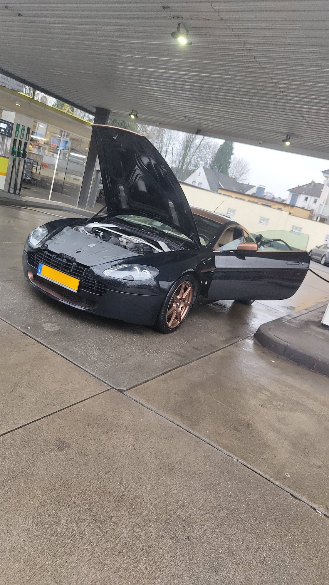

First fillup
First fillup

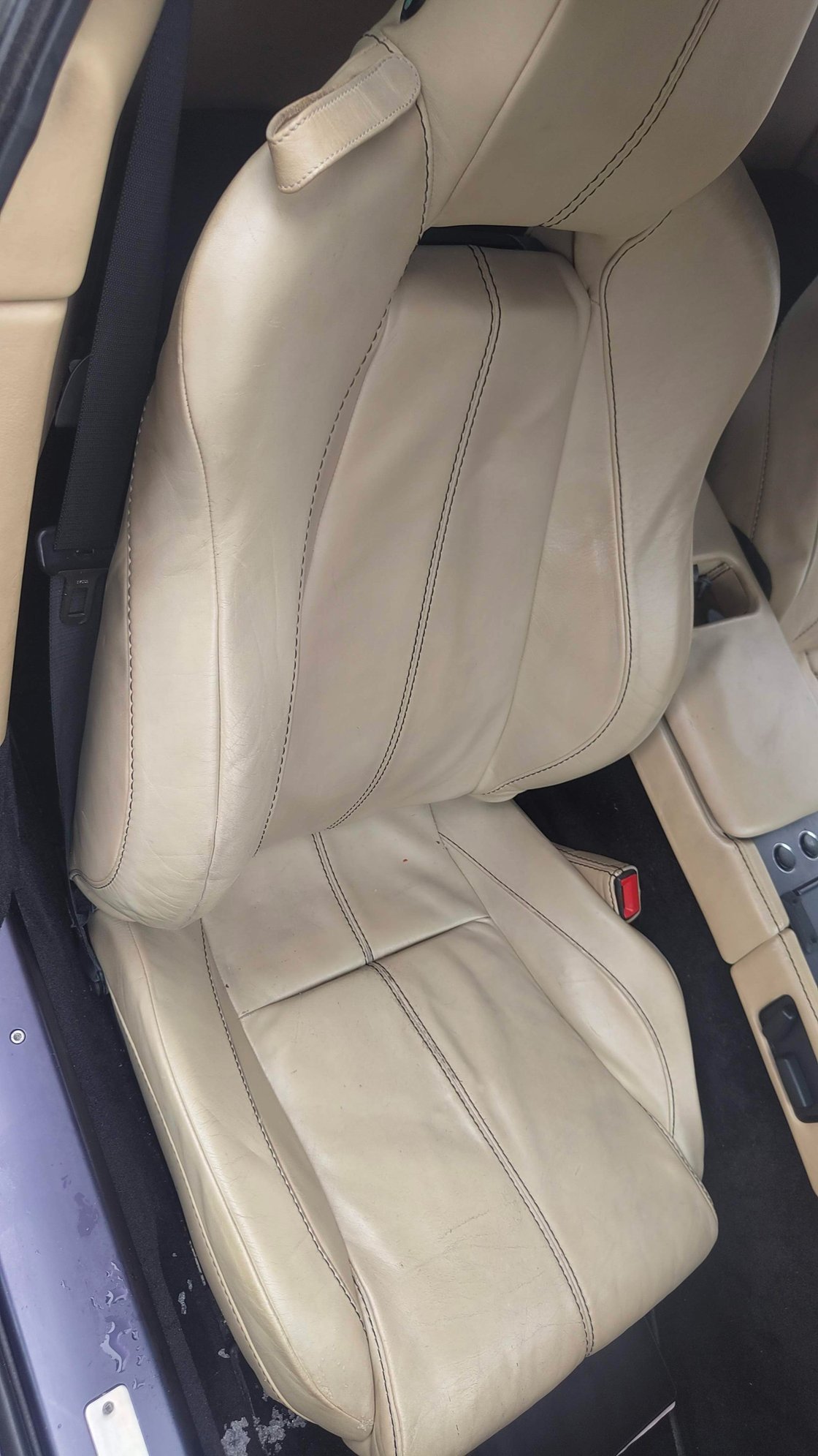

OEM seat
OEM seat

Messed up calipers
Messed up calipers

Fresh wheels
Fresh wheels
Anthracite wheels + black calipers

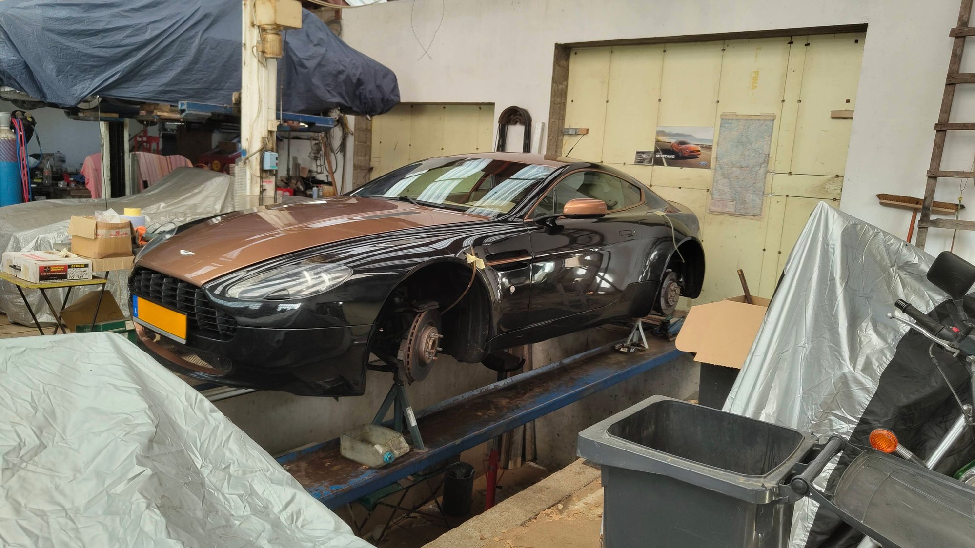

droppped off at the body shop
got it backback after paint

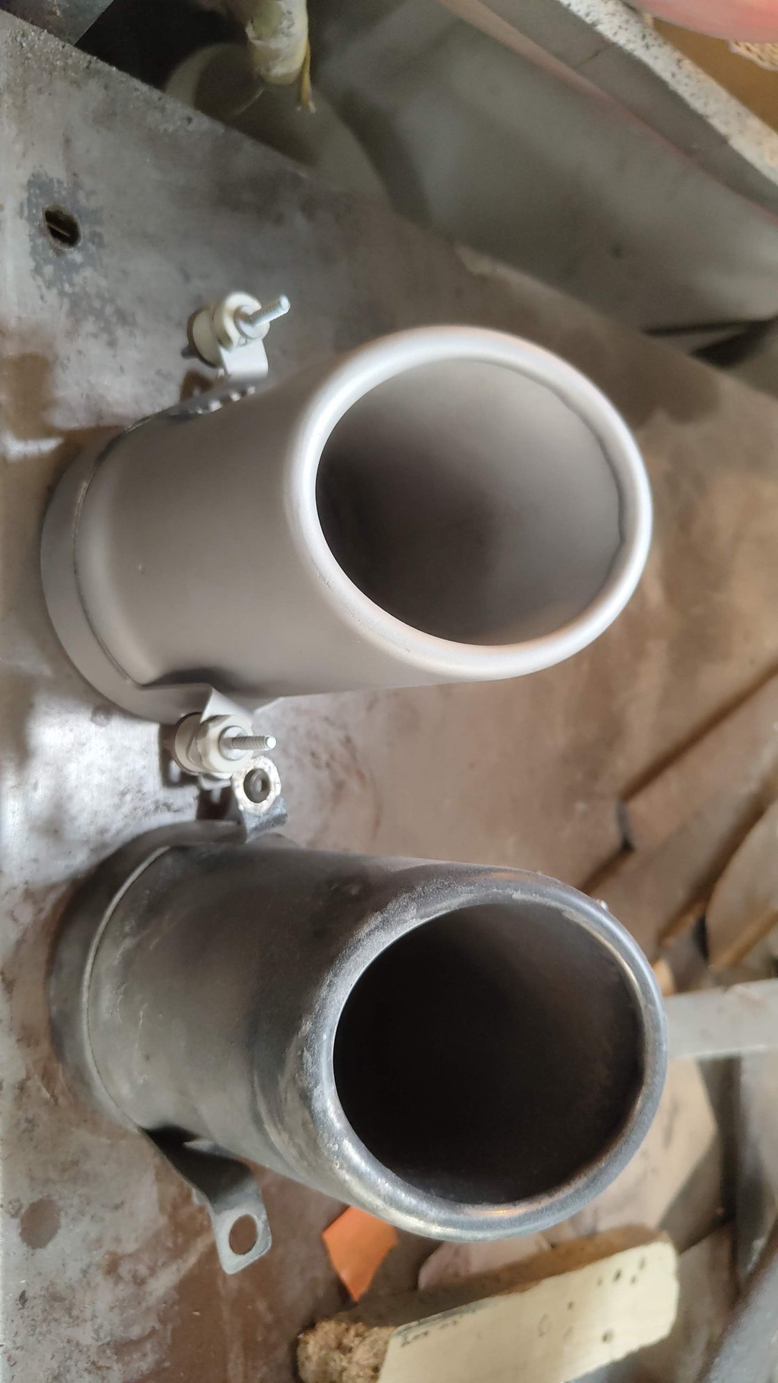

Sandblasted exhaust tips

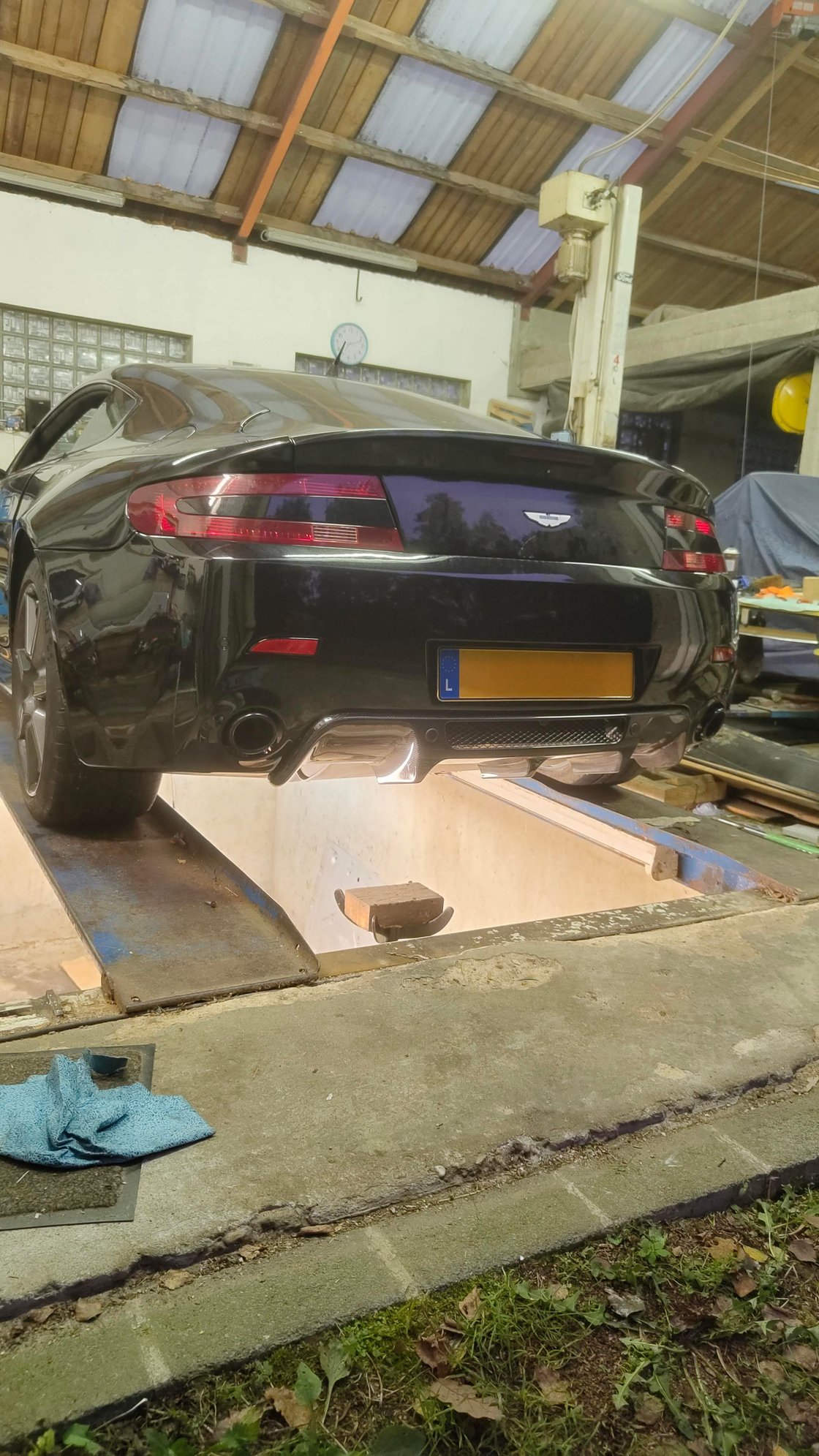

N420 diffusor installed
