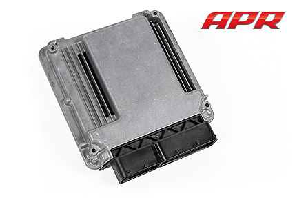

Engine Management
The factory Bosch MED 9 engine management system is responsible for proper operation of the engine in all conditions. With built in compensational data for environmental variables and varying load conditions, the factory ECU is far more complex and intelligent than units found in other vehicle makes and marques.
With the significant amount of changes included in the APR Stage III Turbocharger System, APR’s Engineers spent months calibrating the engine management system to operate smoothly as if intended by the OEM. Thanks to APR’s incredible proprietary calibration suite, data logging software and full access to the coding structure of the ECU, appropriate and intelligent changes are made to ensure flawless drivability and excellent performance without compromise. When necessary, APR’s Electrical Engineers are able to build new coding functions, strategies and routines into the ECU to control conditions normally unseen at factory power levels.
APR’s upcoming EMCS program switching technology puts control of the ECU in your finger tips allowing you to access modes for standard pump fuel, high output race fuel and even reduced output valet modes to protect your vehicle against improper use by other individuals. This technology is patented by APR and is found nowhere else in the world. It’s Performance Without Compromise only APR can deliver!

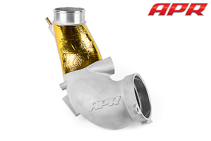

Turbocharger Compressor Inlet Pipe
A cast aluminum induction system was created to support the Stage III Turbocharger systems massive airflow requirements without worry of collapsing under extreme conditions. The cast pipe smoothly transitions from the OEM intake connection point down to the turbocharger’s 4-inch inlet where it’s attached via a clampless OEM style connection. This provides leak proof operation and smooth transitional airflow at all junction points while remaining easy to install and maintaining compatible with OEM and upgraded intake systems.
To combat heat soak, neighboring high temperature items feature a Swain Tech ceramic coating while the compressor inlet pipe is wrapped with Reflect-A-Gold at critical points for additional heat protection. Extreme motorsport testing proved the design to be a success, even after hours of continued use.

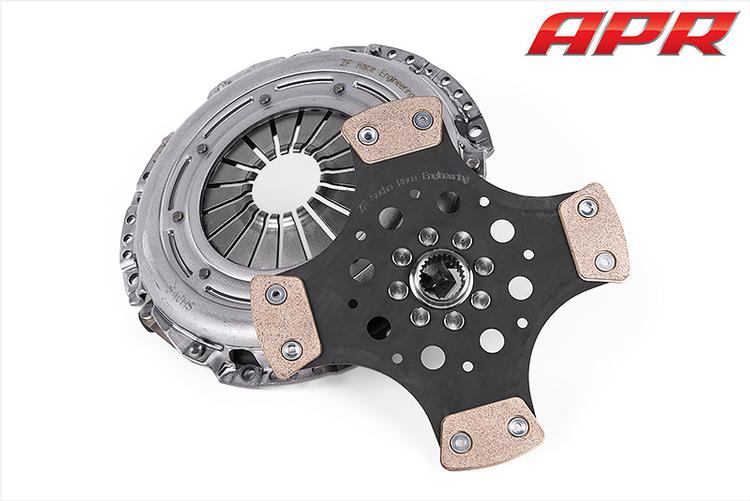

APR Sachs 2.5 TFSI Clutch
The Sachs clutch upgrade for the 2.5 TFSI is capable of holding the torque and power produced by the APR Stage III Turbocharger System. This upgrade includes a new pressure plate and clutch disc as pictured.
