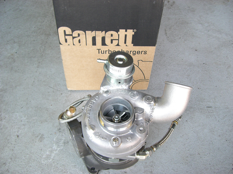

what turbo's are on this car? What kit? I thought this car had tial 605s? Or are they ATP gt28s? 600hp at 22psi is at the crank I presume.

ATP GT28RS Turbos.... 635 was measured at crank on the Maha 93oct.... Is this Mark BBB? What's up? How u been?

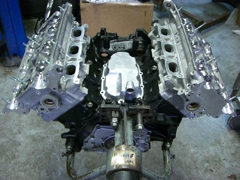

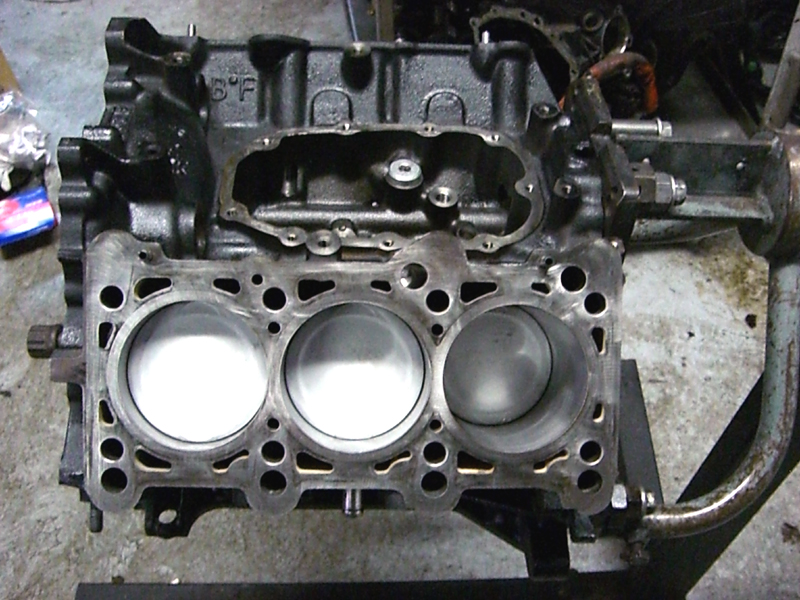

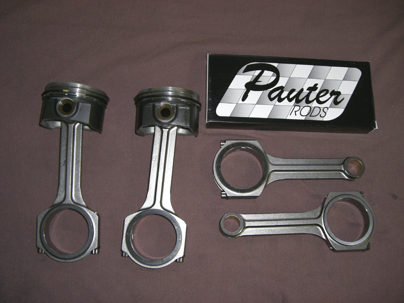

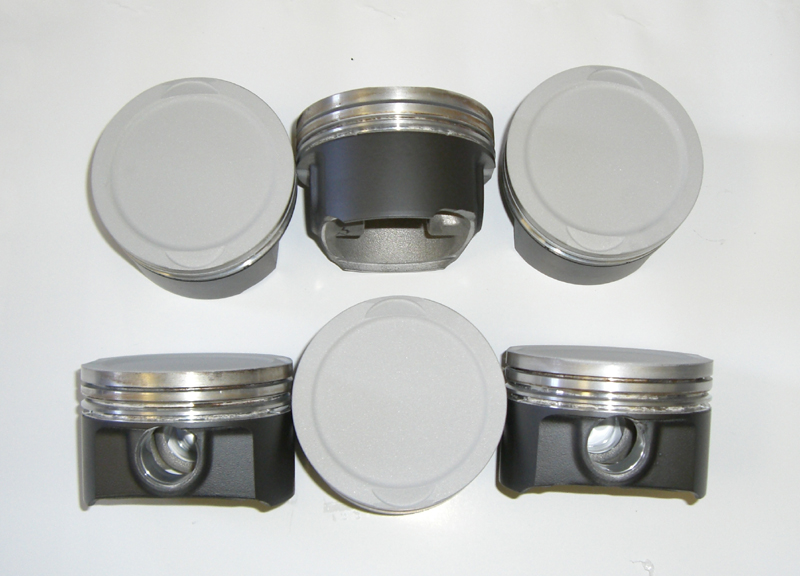

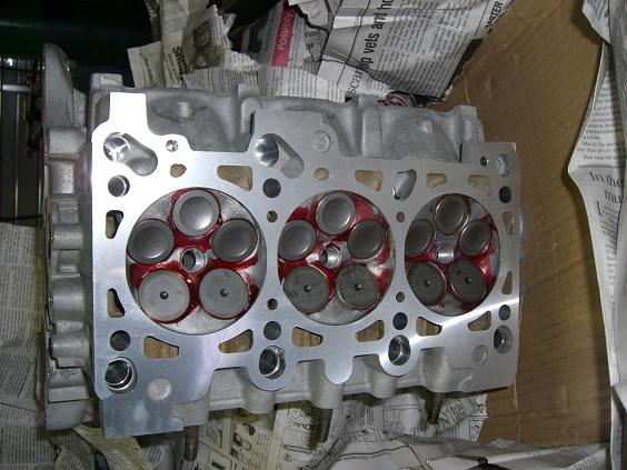

I don't have any WHP numbers right now but will be sure to get some once the car tuned and build is done. As far as the engine goes it is a totally rebuilt/built. Pauter rods, coated pistons, Cat springs, coated main bearings, balanced crank, built heads (ported/Polished/rs4 intake cams) completely rebuilt block... I'm sure I am missing some other stuff that we did too but that is the major stuff....

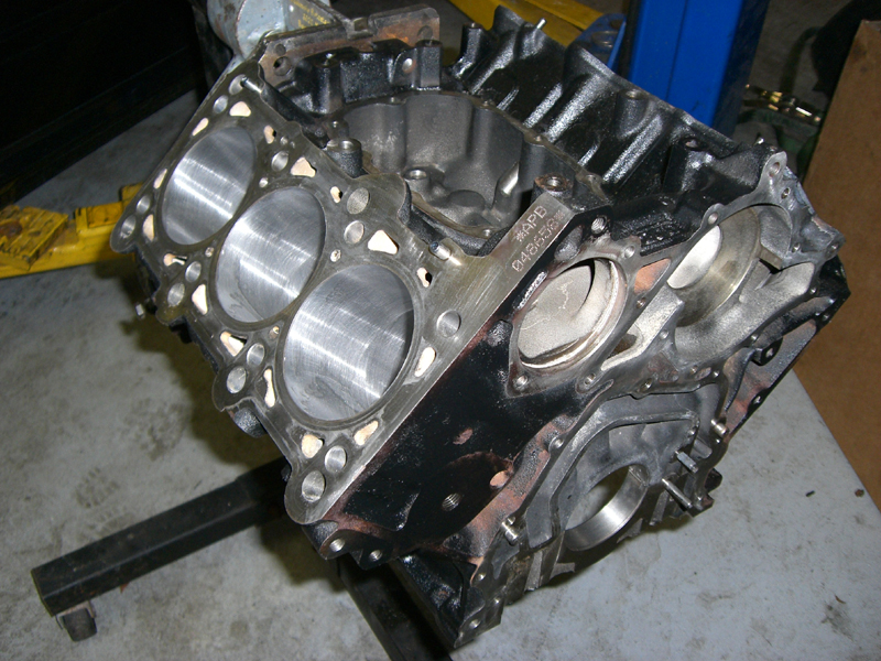

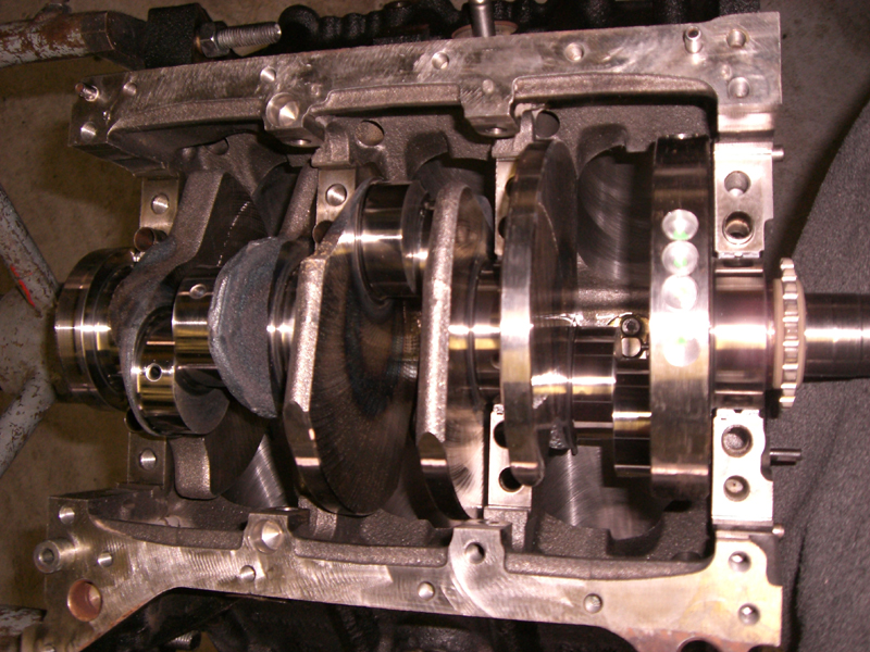

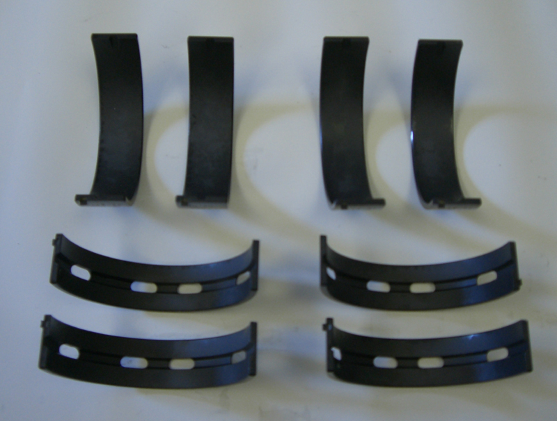

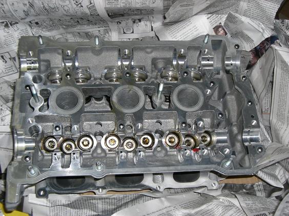

Some more pics of the motor build....

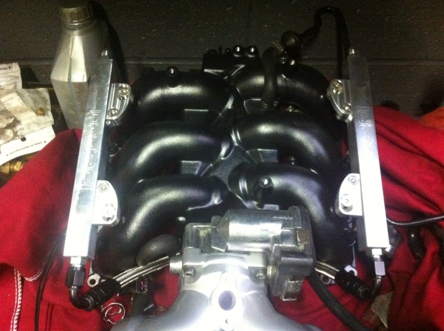

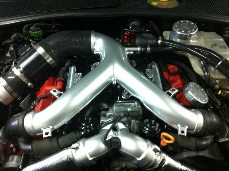

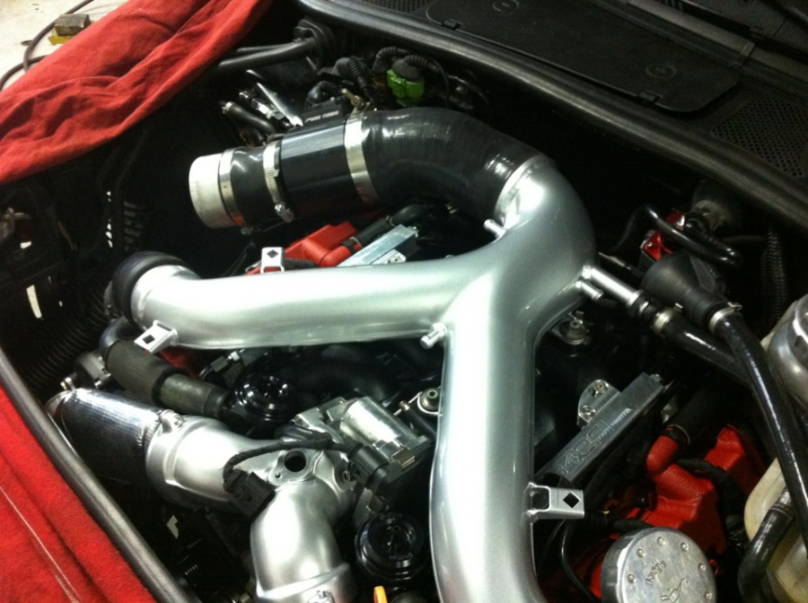

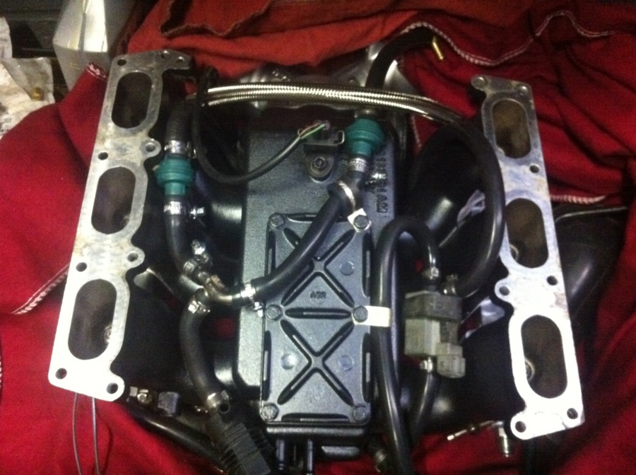

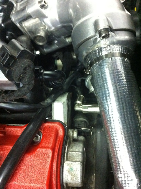

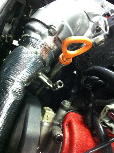

Some more build pics... Got the last piece we needed from Europe late last week so now the engine can be completed... We also tried to hide as much of the ugly wires/piping/tubes as we could...
We should be ready to start her up this week ....

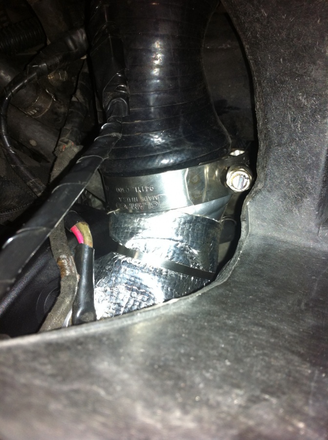

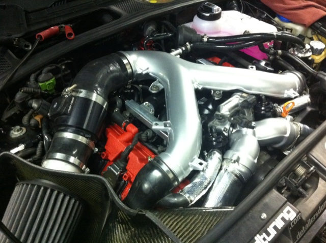

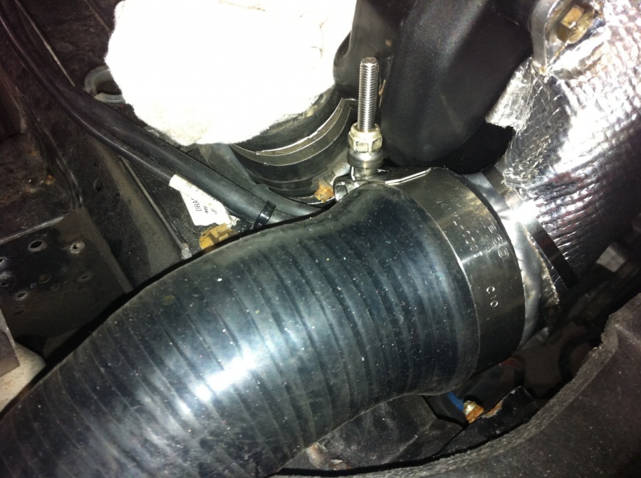

FMIC connected to Pancake/up-pipes...
Meth Ports installed....

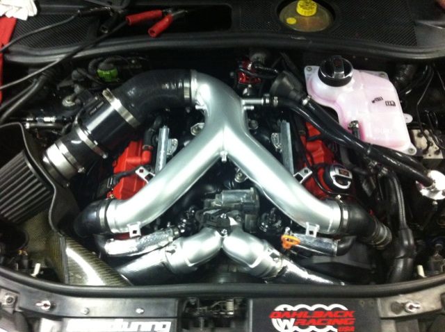

Engine install done...
Engine install is done... two things left...
1. cut hood to allow for extra clearance
2. Custom Tune!
So excited!!!
