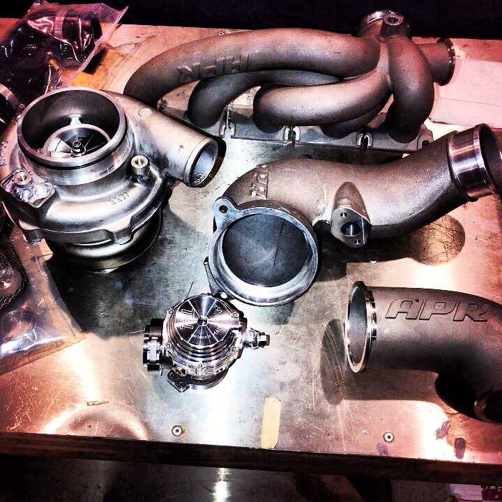

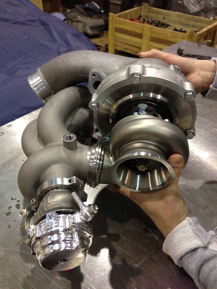

UPDATE:
Only a few weeks away from completion now. Its been decided that my car will be running quite a big turbo. GTX35
Heres some pics.
The turbo is bigger than my mates meatball head lol.
