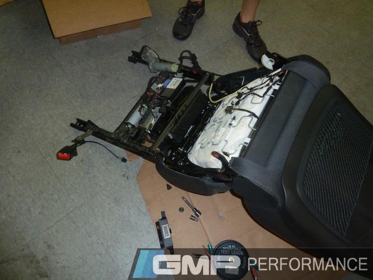

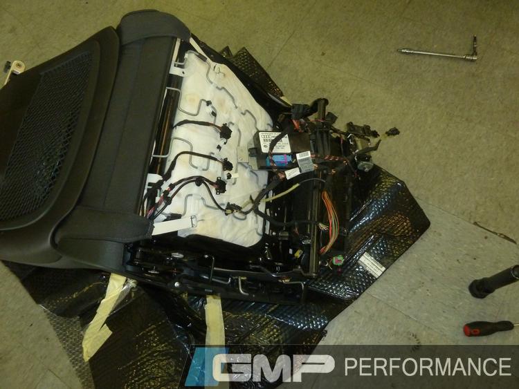

This seat install was a unique one. Aside from all the bracketry and wiring work that needed to be done, there is one thing the stock seats had that the Recaro Toplines did not and that was a seat occupancy sensor. Without the seat occupancy sensor, the airbag system won't function so it was very important that they were moved to the new seats as well. Switching them around isn't difficult as much as it is time consuming. Seat occupancy sensors are found within the seat itself, inside the cushion to be more precise, and required us removing the leather from the stock seats to reach and remove it. Performing the same technique to the Toplines, we placed the sensor in the cushion of the Recaros, replaced the covering and these seats were ready to go.

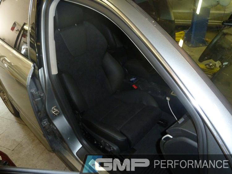

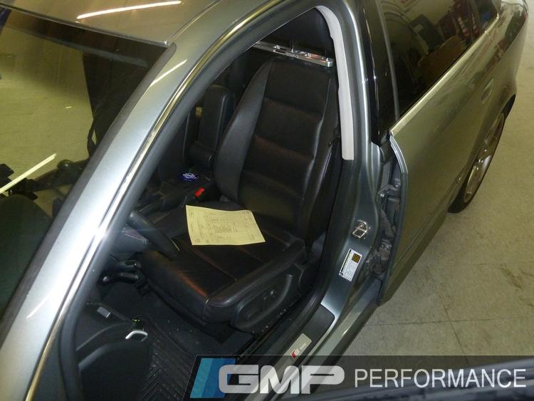

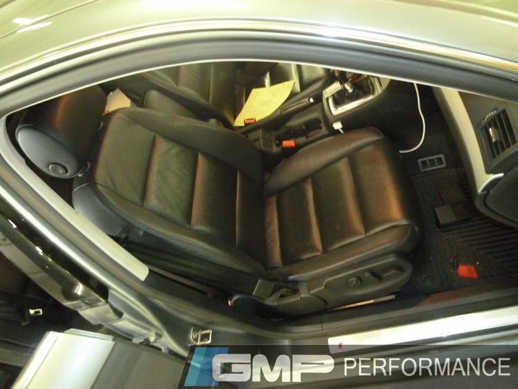

Stock seats

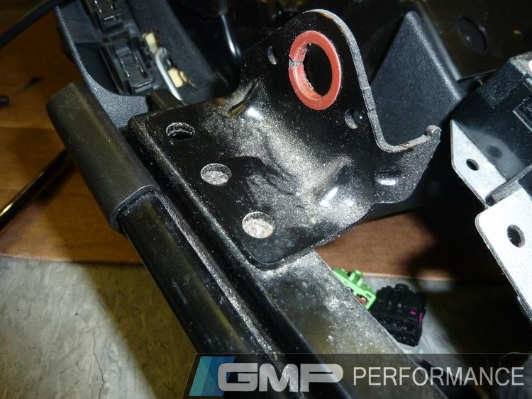

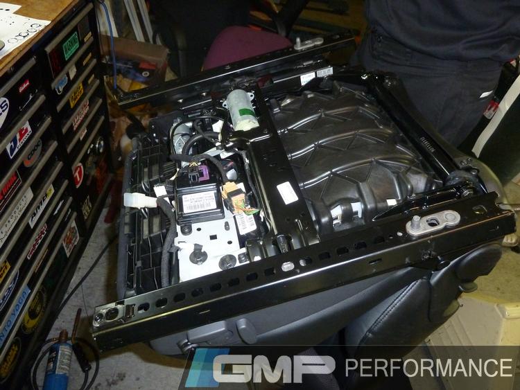

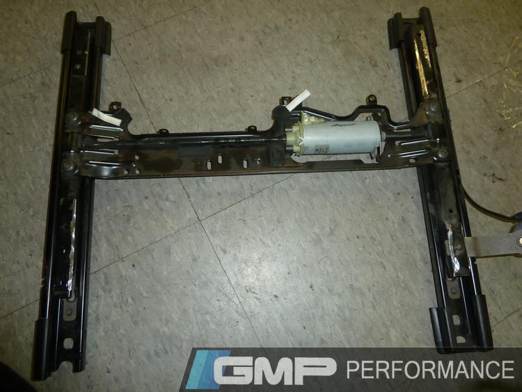

Seat bracketry removed from one seat

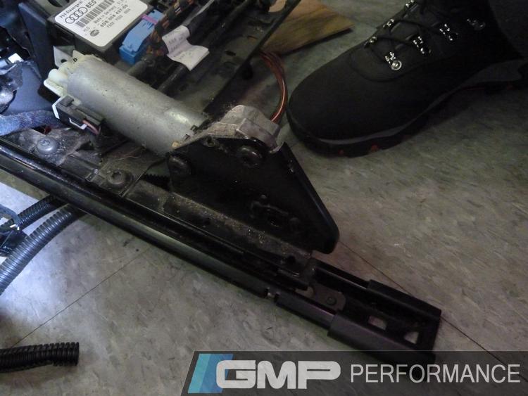

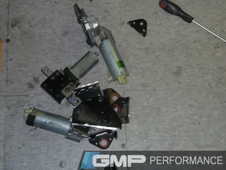

Close up showing how the US brackets are welded to the rails (Euro seats would have bolts in the 3 holes)
The motor assembly is welded on as well

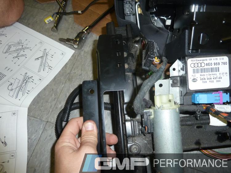

Recaro bracket lines up with where the bolt holes SHOULD be

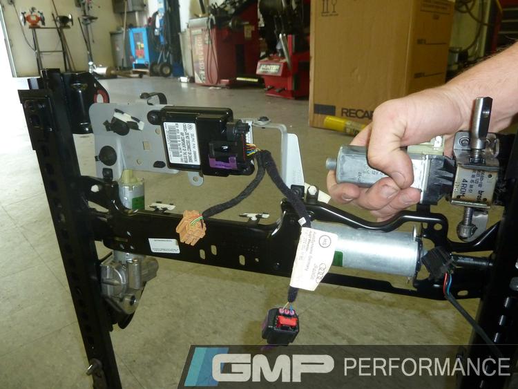

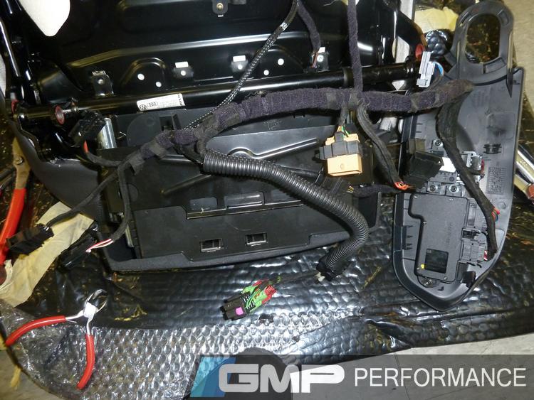

Lots of wiring to remove and transfer over!

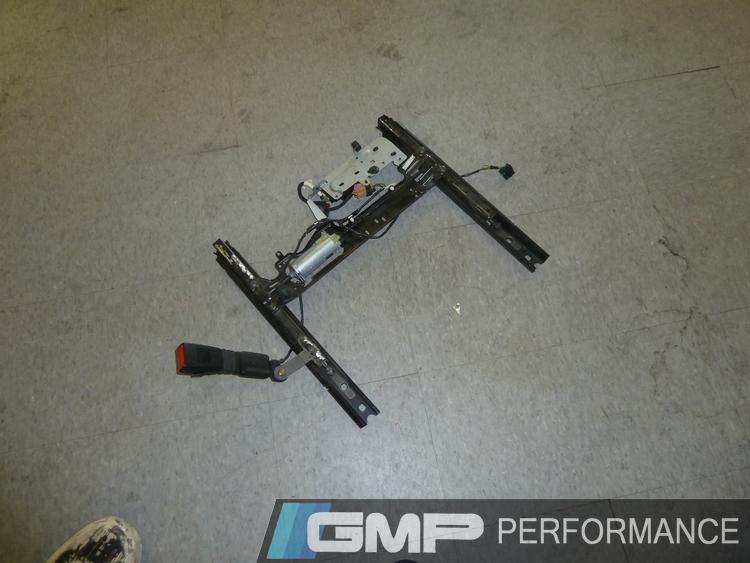

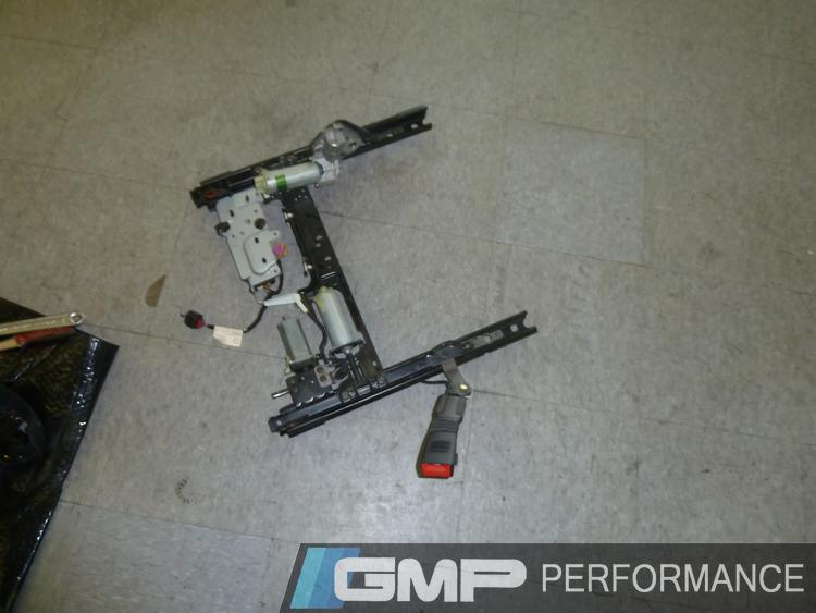

Audi seat rails with the brackets cut off to facilitate Recaro brackets

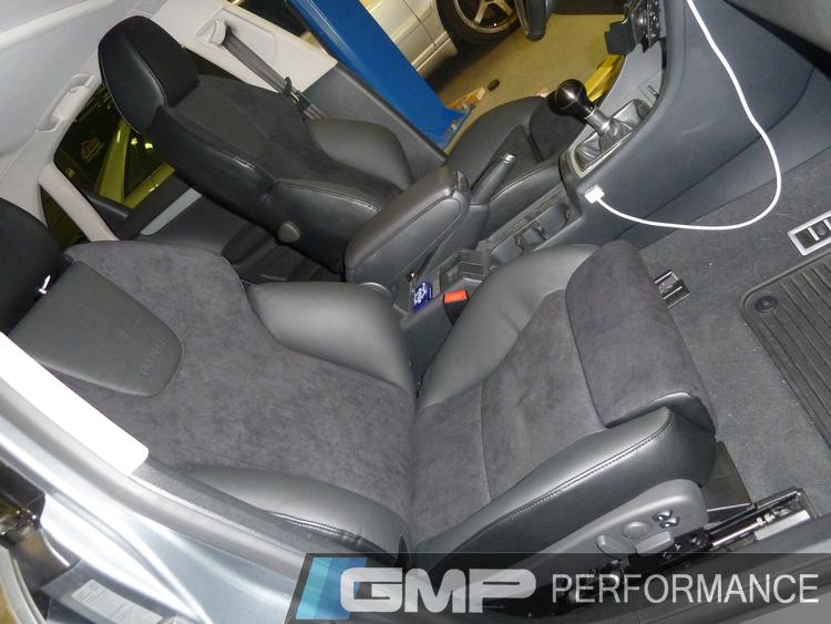

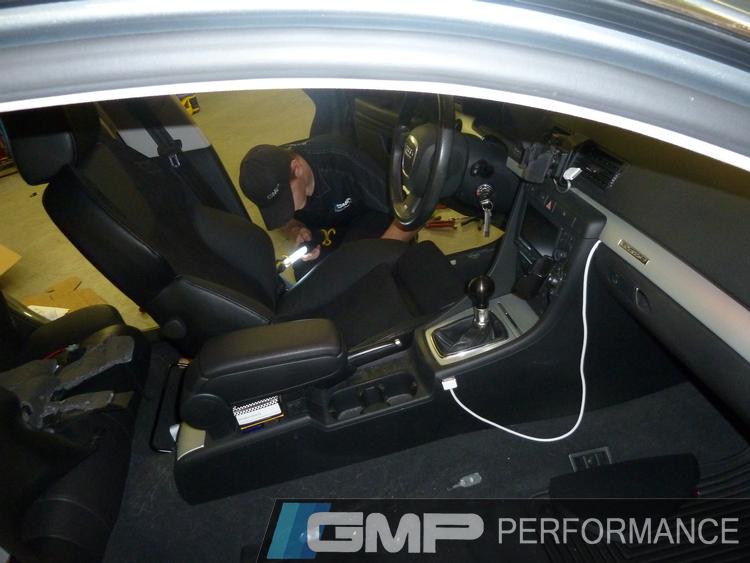

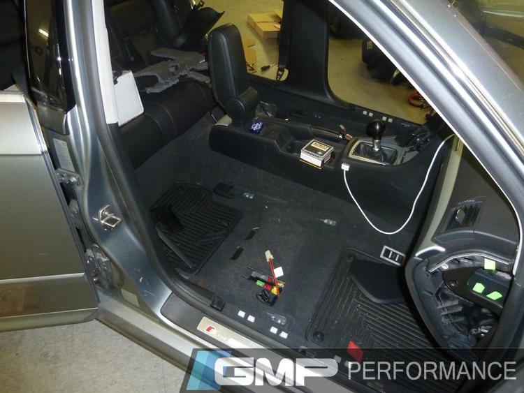

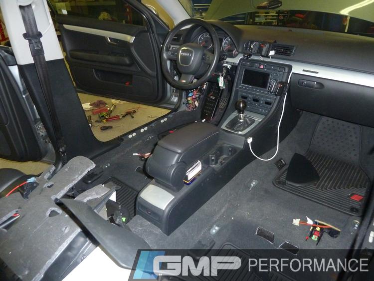

No seats

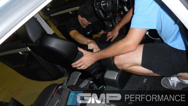

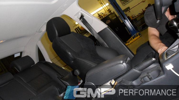

Initial fitting of the drivers side Recaro

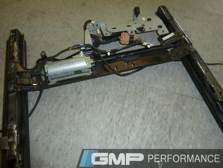

Other Audi seat bracket/rails

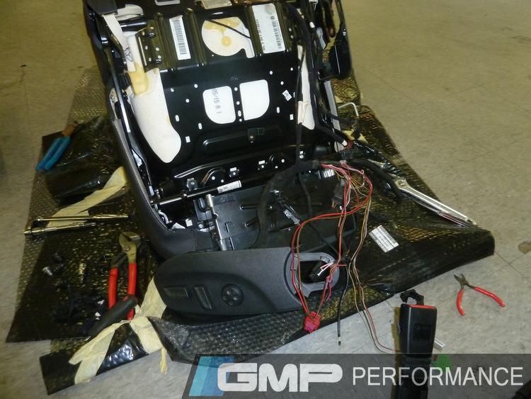

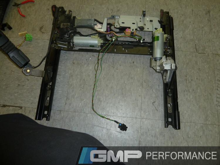

Audi passenger seat dissasembled
This wiring gets uncovered and certain portions transfered over to the Recaro seat
Seat bracket/rail assembly with control module and motors

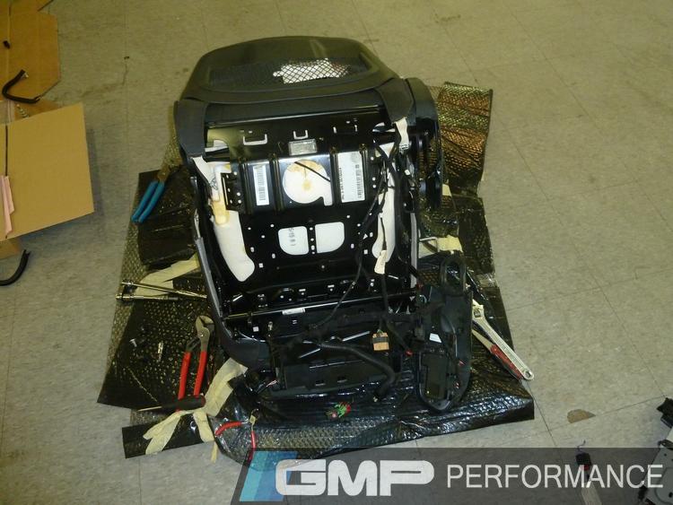

Wiring that will be transfered is installed
More dissasembly
Brackets and motors that were cut off
Modified rail/bracket assembly
Modified rail/bracket assembly with wiring run and mounted

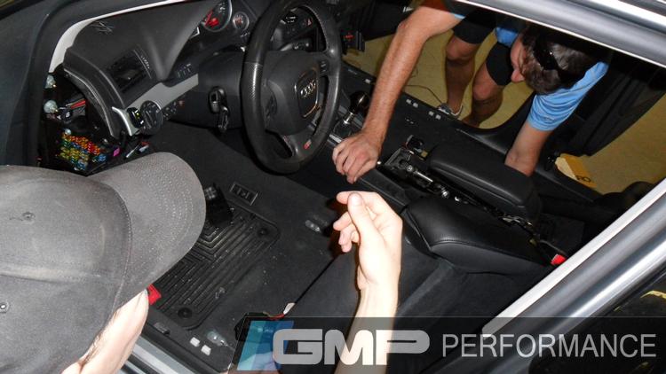

Carefully slipping in the Recaro seats
Drivers Recaro installed
