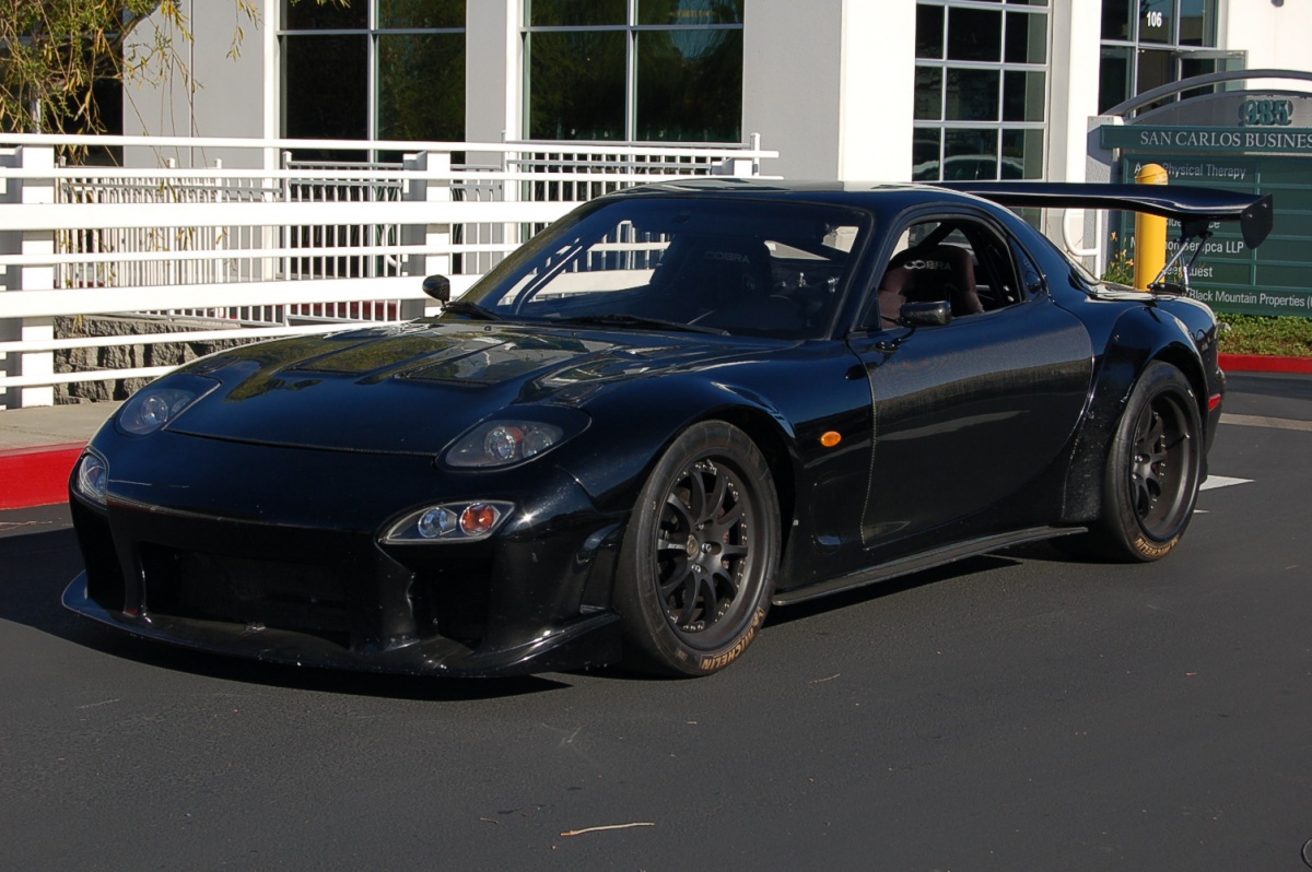

This car belongs to a good friend of mine (Nate) and he built it in 2007 running a healthy LS6 engine with improvements continually being made to it ever since. He was one of the original v8rx7.com (v8 RX-7 swap forum) members and serious about building cars. Logging over 25K street miles it is fully sorted and ready for a new owner. Clean title, no accidents, no issues, well thought out. The LS7 combo has around 10K miles on it and the T56 was rebuilt approx 1K miles ago.
This is a one of a kind FD RX-7 that was fully built by a knowledgeable mechanical engineer (Nate) with a passion for fast handling cars. The car is completely streetable; however is very track oriented in its execution. Built as a no nonsense track monster to also pound the boulevards.... it is a truly well thought out machine for someone looking to stomp on exotics at the track or just smash on the street.

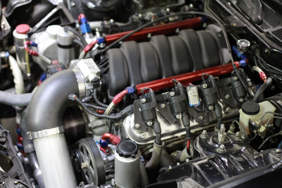

Engine- all aluminum 427ci small block
LS7 block with billet main caps, ARP main studs, LS7 crank, Comp Star rods, ACL coated bearings, Wiseco coated pistons
West Coast Cylinder Head fully CnC'd LS7 heads running 2.20" titanium intake polished valves, exhaust valves were replaced with Manley s/s valves
This solves all problems with factory valve failures common to stock LS7 head/valve combo.
Dual springs, rebuilt LS7 rockers with new trunion bearing kit., upgraded pushrods, LS7 lifters, GM LS7 MLS head gaskets, ARP head studs
ported LS7 intake manifold, 90mm cable TB, medium sized hydraulic roller cam 23x/240x duration (great low/mid range power and strong up top). ATI underdriven harmonic balancer.
Speartech harness, custom tuned by Synergy Motorsports factory PCM for 91 octane 585rwhp+. High output GM alternator. No A/C!

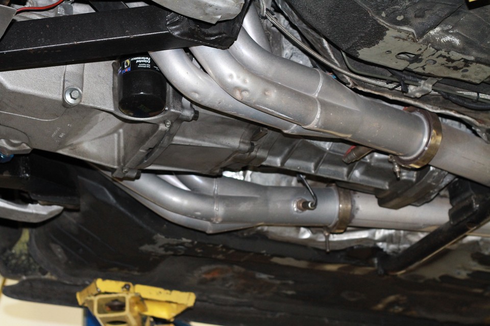

JTR 1 7/8" long tube headers, dual 3" into single 3.5" piping, 3.5 high flow cat, straight thru style muffler. Sounds gooooood!

Fully rebuilt and upgraded Viper spec T56 6speed transmission (900hp+ rating), Amsoil synthetic fluid, balanced McLeod twin disc clutch/aluminum flywheel
McLeod adj clutch master cylinder, new Fbody pilot bearing, HD alum driveshaft with Spicer Ujoints. Built 3.90 FD rear end with Turbo2 clutch pack LSD
Drive Shaft Shop 300M axles, One-Off Tranny Mount with Energy Suspension Mount Pro 5.0 shifter and machined delrin shift ****, One-Off rear subframe (Braces Diff in all directions with shear plate at diff cover)

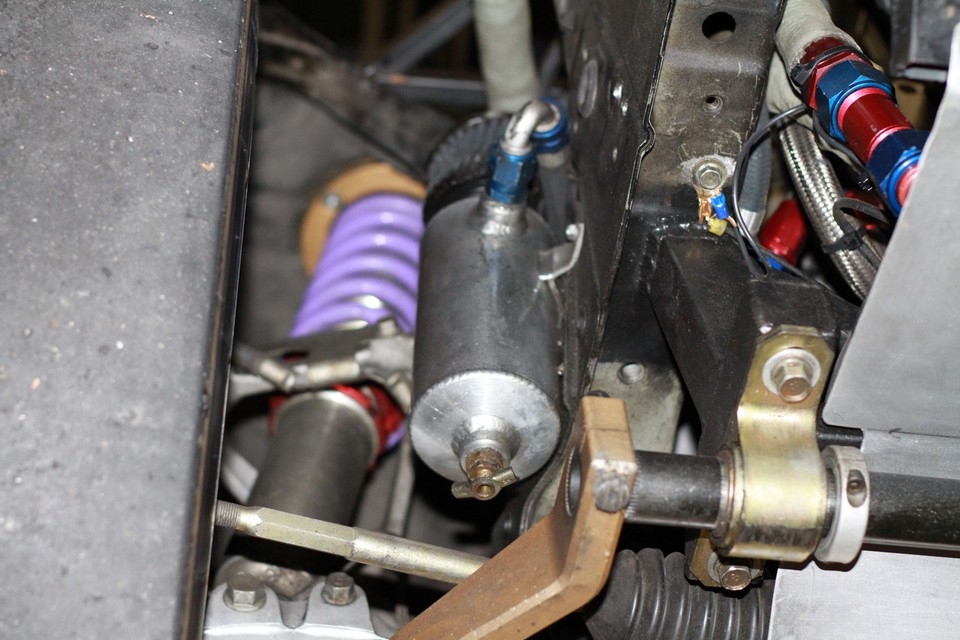

Custom Kmember to accept factory LS7 dry sump oil pan and FD steering rack, custom bumpsteer correction fabbed up
JIC FLT-A2 adj coilovers, delrin bushings, new pillowball bushings, adj TriPoint hollow modular front sway bar, TriPoint rear bar with adj end links

Forgeline Wheels SX3R powdercoated black (w/ lightweight hardware, etc.), Michelin road race Slicks

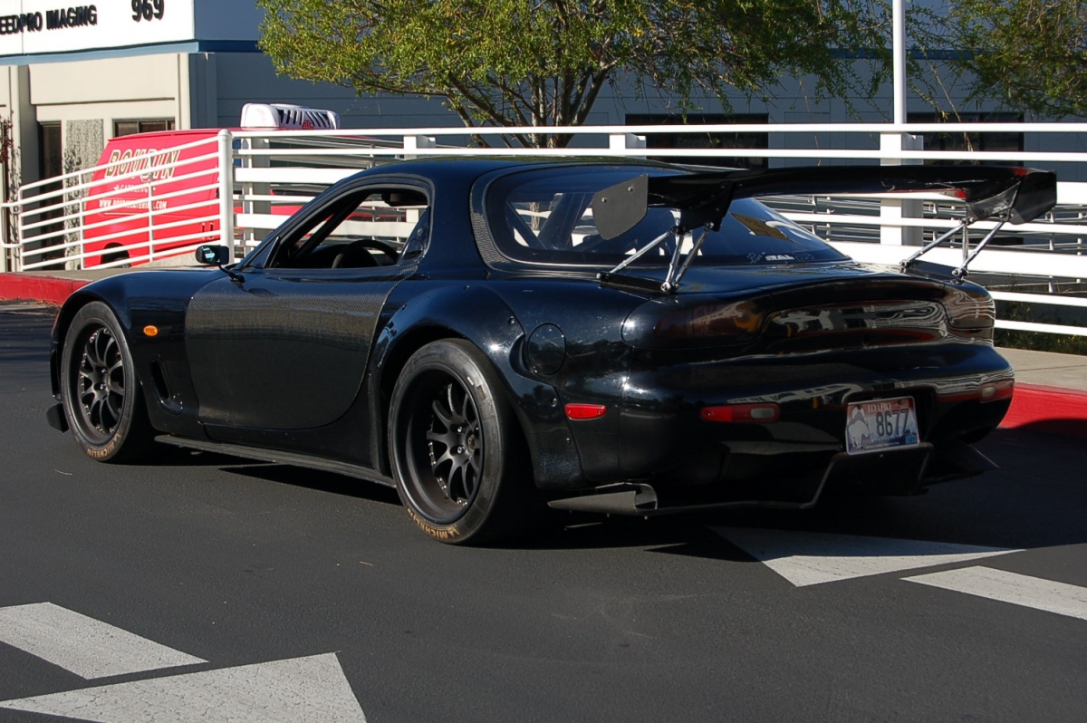

Exterior Upgrades

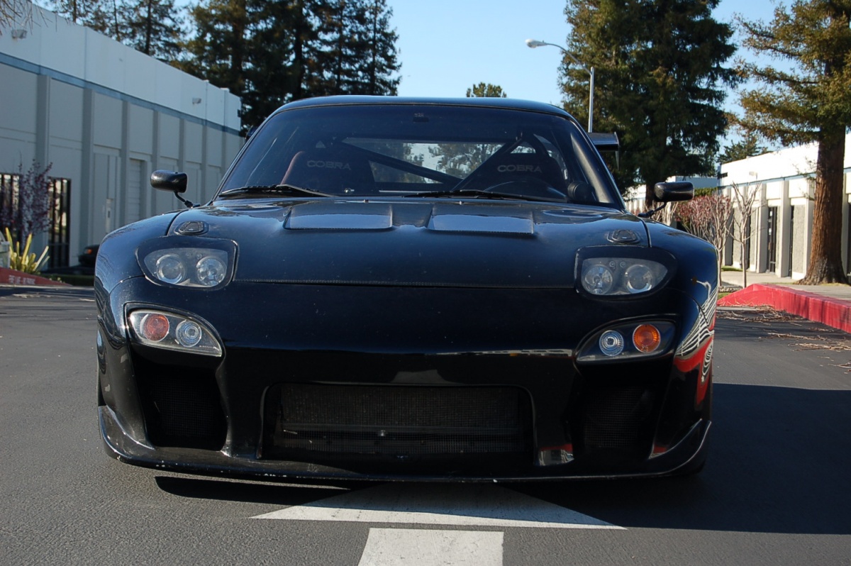

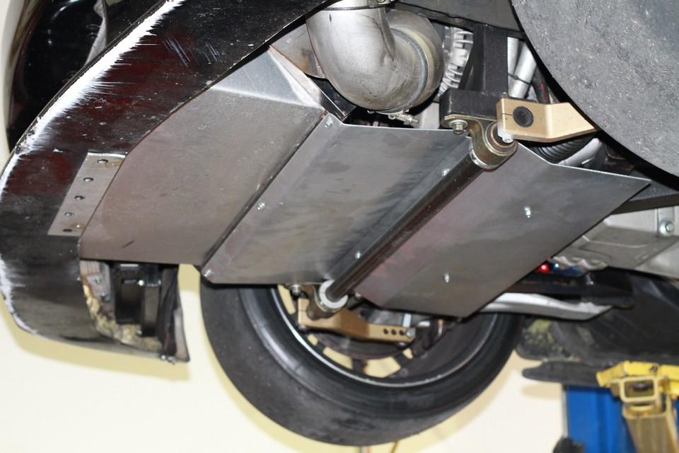

Pettit Racing GTC front bumper with integrated splitter, custom front aluminum undertray, Burnout front fenders fully modified to accept 18x11 (315mm) rim/tire combo
Re-Amemiya Flush HID Headlight kit, Seibon CF hood with Aerocatch hood pins, Seibon CF doors (accept all factory hardware and retains power windows), APR aero mirrors, Shine side skirts
http://aprperformance.com/index.php?...d=97&Itemid=44

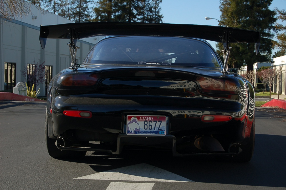

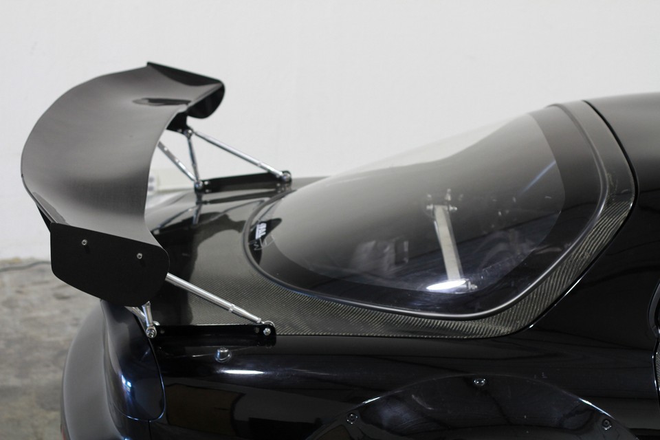

Seibon rear CF hatch with FAL lexan window, Pettit Racing rear fiberglass flares to accept 18x12" rim and up to 345mm tire
Re-Amemiya Rear Diffuser, Re-Amemiya Rear GT-Spec wing with one-off adjustable/removable mount (very rigid and functional)

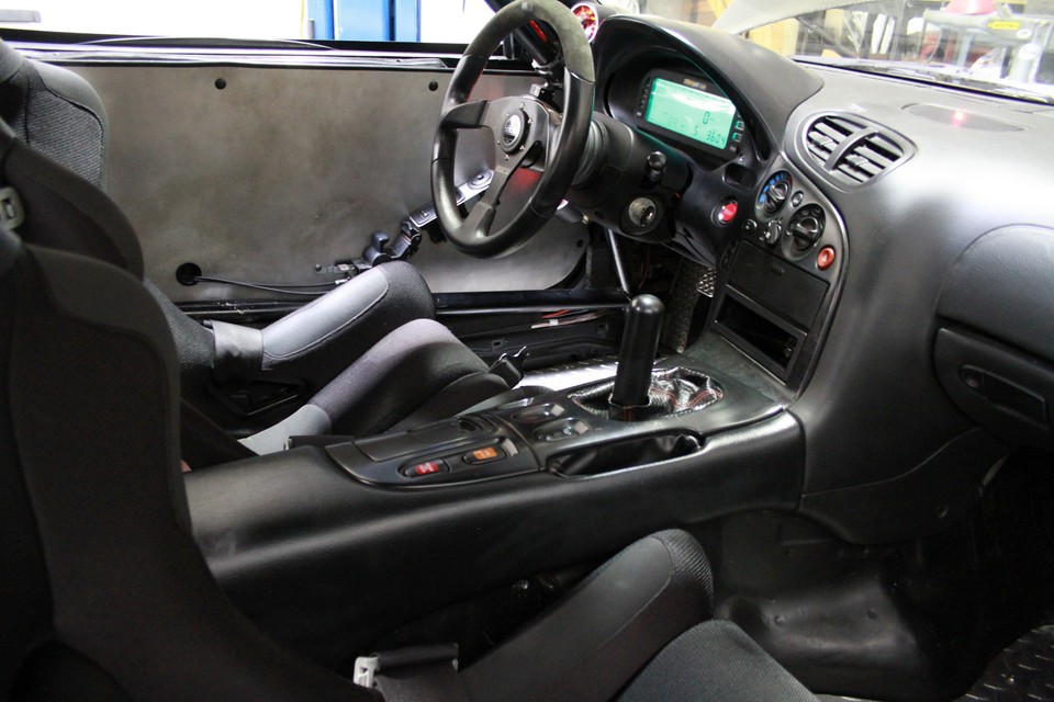

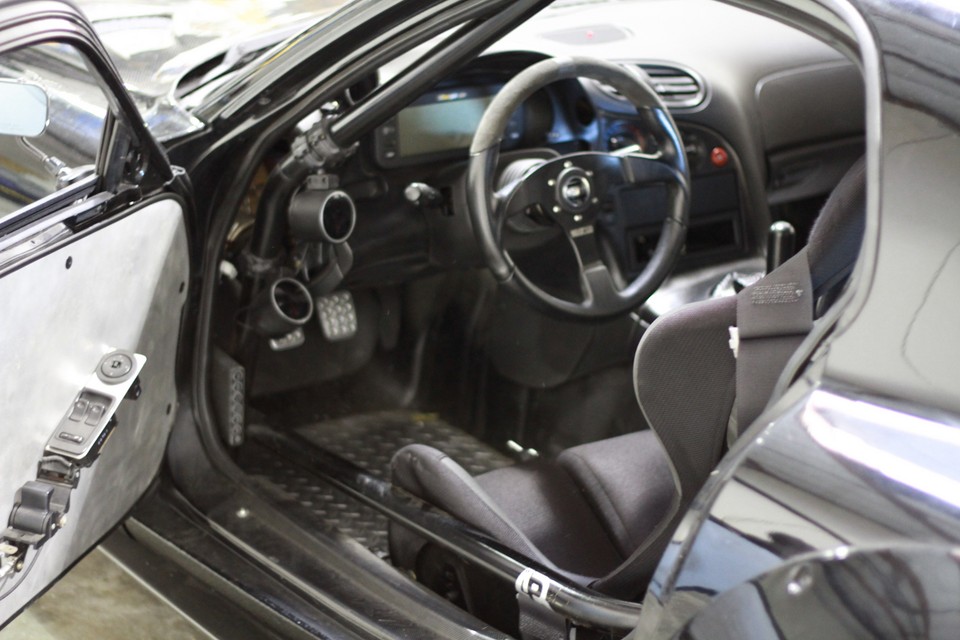

Interior modifications
Cobra racing seats/brackets, Sparco 5pt harnesses, Sparco steering wheel with quick release adapter hub, custom Diamond plate alum flooring
One off alum door cards, RacePack dash display with data acquisition, redundant DEFI (oil temp/press H20 temp) gauges should RacePack fail
Full roll cage designed with easy entry/exit, Fire extinguisher, Odessey sealed dry cell battery mounted behind passenger seat low in the chassis
Road Race style rear view mirror offering superior visibility over any stock style setup
