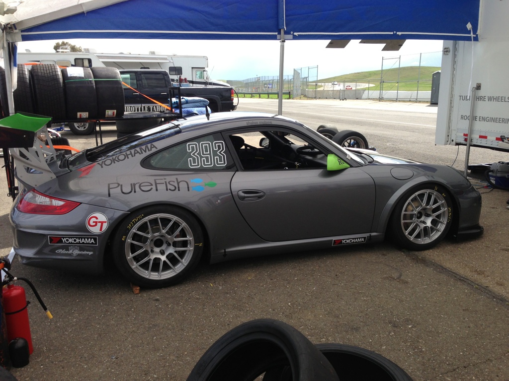

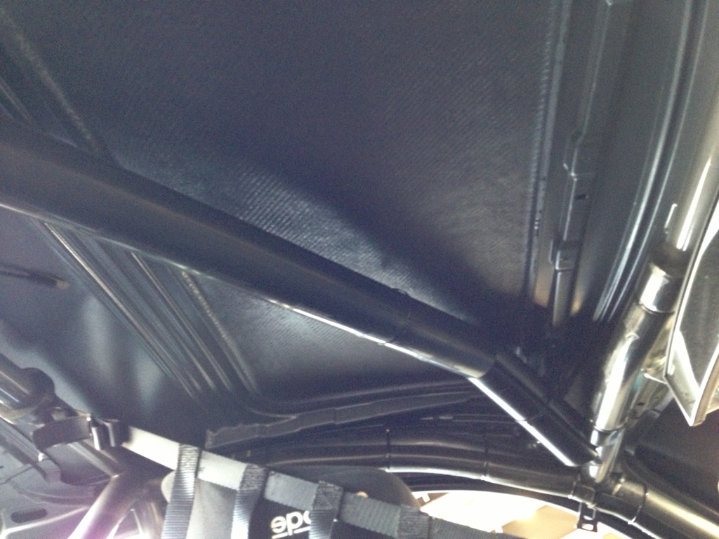

2006 Street Tub Converted to 997 Cup specs with no expense spared.
Car is perfect, inside and out.
Tub:

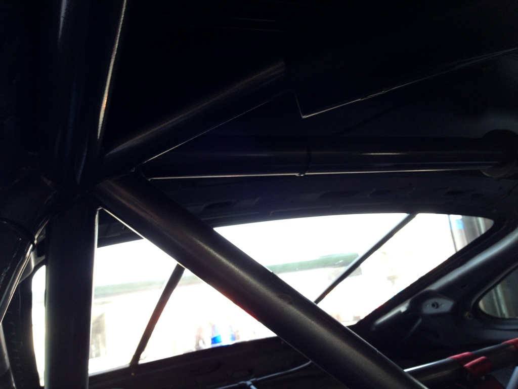

1.75" Chromoly LucasFab Weld In cage replicating cup cage with more gussets and seam welds (work of art)
(PCA, NASA, POC LEGAL & APPROVED)
Rear inner fender wells have been widened for more clearance than standard 997 Cup for wider rear tires

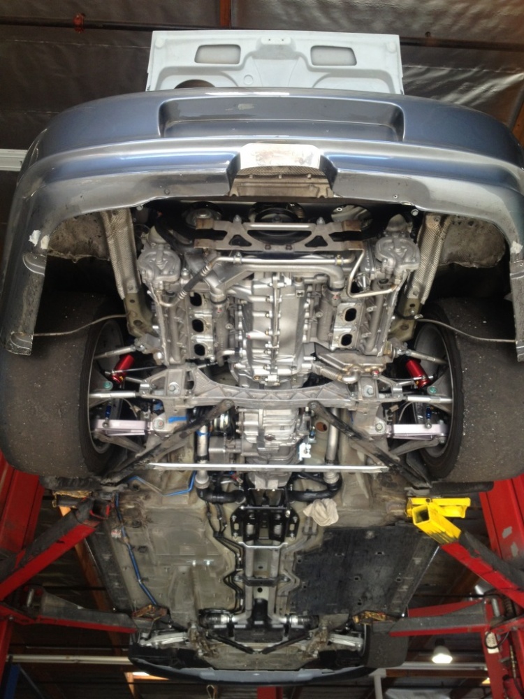

Drivetrain:

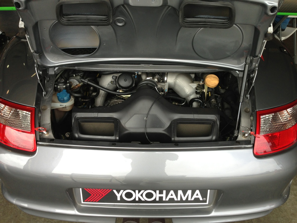

2007 997 GT3 Cup motor (20 hours with 0-2% leak down)
2012 PMNA 3.8 GT3 Cup Airbox
996 GT3 (G96) Transmission (New Bell Housing) with NEW Guard Transmission LSD & 4.125 R&P
JUST REFRESHED BY BILL RADER & ADDED PMNA STEEL 2ND SYNCHRO - have invoice
New 996 Cup Shift Cables
997 GT3 Shifter
New Guard Transmission LSD PLATES
Tilton 7.75" Clutch & FW
997 Cup Hydraulic Release Bearing (faster shifts!)
2009 PMNA GT3 Cup Headers and 2009 Cup Center Exhaust

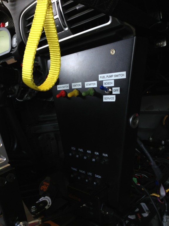

Brand new 997 cup bosch fuel system with service and pump out ability
Custom clutch bleed line from engine compartment

Suspension:
JRZ Motorsports 3 Way Motorsport Shocks WITH QUICK RELEASE (just serviced and rebuilt by JRZ USA)
700# front springs & 1000# rear springs
RSS Solid Monoball Full Suspension Package
EVERYTHING 997 CUP
997 GT3 Cup Uprights
New wheel bearings
New 997 Cup Bladed Sway Bars front & rear
Custom Rear Raised Subframe for better rear geometry (RSR style)
New Black axles
New wheel bearings

ECU:
Full custom lightweight wiring harness
Full standalone Cosworth/Pectel SQ6 ECU - allows you full tuning and data to do anything!
LINK to specs: http://row.cosworth.com/products/mot...ts/pectel-sq6/
ECU and wiring alone was ($25,000!!)
NEW Race Radio Wired with steering wheel button
Brake pressure sensors (all 4 wheels)
Throttle position sensor for motec
Teves ABS System
Motec CDL Dash and data acquisition with GPS, and full data logging of brake pressure, throttle.

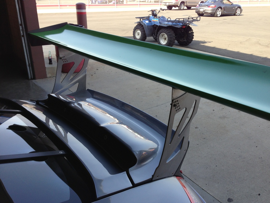

2010 997 GT3 Cup Decklid, Uprights and Wing

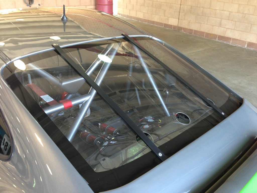

Lexan Front Windshield with Grandam style reinforcements (much safer than glass & lighter)
Lexan Rear windshield with Grandam style reinforcements

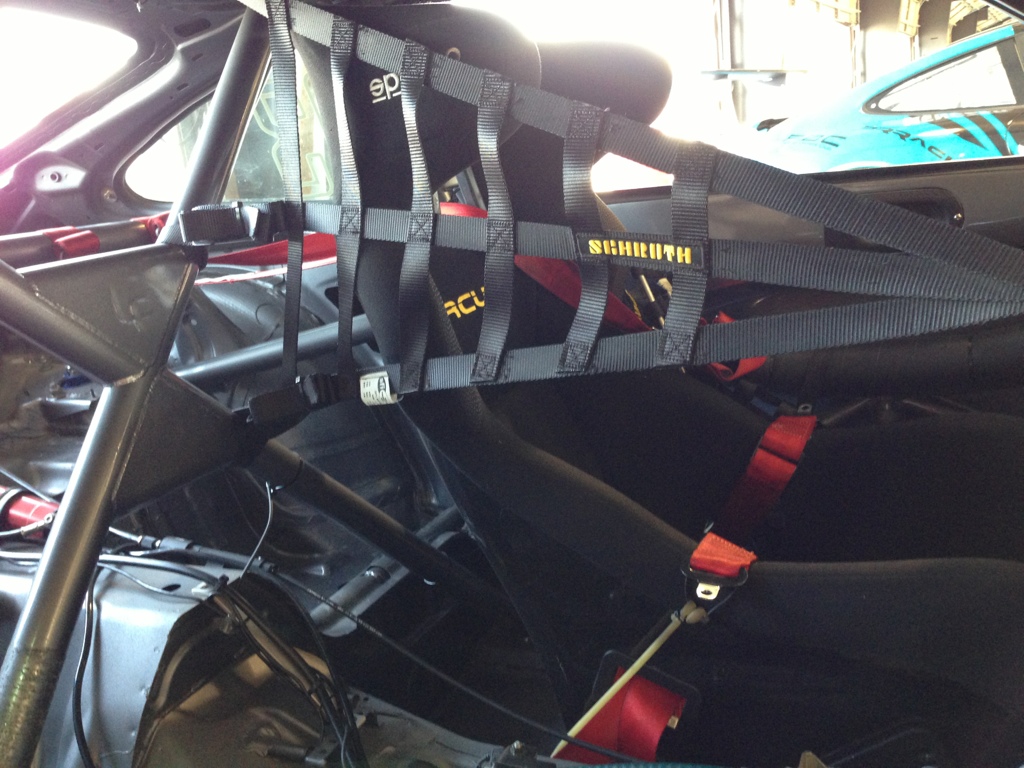

Driver side window net & triangle net
