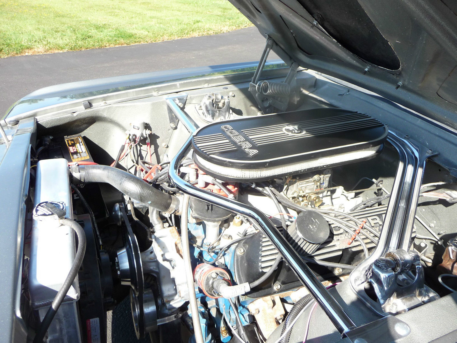

I hate to do this but you have several items in your listing that are misrepresented and I would hate for some unsuspecting buyer to find out the hard way. Although I imagine most on this site are smart enough to see what I see.
You are clearly showing Windsor heads in the engine compartment yet you claim to have a BOSS 302 intake. You can't have both. You need BOSS 302 or modded 351C heads to use a BOSS 302 intake on a Windsor engine. Even if you think you meant BOSS 302 "exhaust" manifolds, you would still need the proper heads. You are running stock cast iron exhaust manifolds that do not flow well. Those aren't even the HIPO 289 exhaust manifolds. You're probably running around 200 WHP with the exhaust manifolds choking out the 3" Magnaflow kit...and get choked down to 2-1/4 exhaust trumpets sticking out the rear valance panel.
The T-10 and the Toploader are different transmissions.
Rhino lining is typical to cover up major flaws.
"- none of the usual wheel hop given the converted suspension." So there's "unusual" wheel hop?

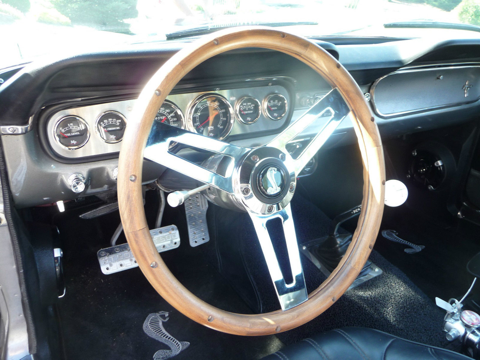

"Instrument panel works (however - on dash water temp and oil pressure are not used given separate aux gauge cluster - better than in dash gauges)."
So, you have a fancy $500 6 gauge dash kit but decided to NOT hook up the water temp and oil pressure gauges because the cheap under dash kit is "BETTER THAN IN DASH GAUGES."
"To those who know classics, you know what you are getting.... "

Wow, embarrassing - obviously the forums have some serious knowledge. I was simply regurgitating what I was told about the car when I bought, so I need to go back to the drawing board an figure out what is what.
I was in no way trying to mislead anyone, but it would have been nice to receive a PM so I could correct first. Oh well, I will edit what I can.
