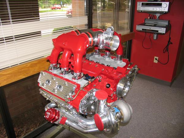

Engine is the following:
1991 3.3 turbo engine case. Shuffle pinned, clearanced for larger oil pump, boat tailed, and race prepped.
Crank: is 964 unit to add extra stroke. Crank was straightened, knife edged, cross drilled and chamfered along with other steps. THIS THING IS NASTY! It has a custom 1k dollar Clewett billet pulley on it
Rods: Dry film coated Pauter rods
Pistons: Custom 98mm JE units that are thermal barrier and dry film coated with special JB racing ring set
Cylinders: LN Engineering billet 98mm units that are flame ringed, decked, and cryo treated with ARP studs.....WOW is all you can say on the quality
Heads: Full blown 3.3 turbo heads done by Bill at Xtreme Cylinder heads. They are the best of the best. These are some of the best 3.3 turbo heads ever done.
Cam: Custom turbo cam from Daugherty Racing cams and custom dry film coated valve springs and JB racing adjustable cam sprockets.
Oil pump: Gt3 high flow pump along with high flow billet scavenge pump.
Valve covers: Upper and lower billet Imagine Auto fully polished.
Intake: The intake started off as a GT3 cup intake that was totally worked. It has a custom center section that utilizes a race accufab throttle body and Tial 50mm BOV. It has custom polished fuel rails and Precision turbo 95lb flow matched injectors.
The flanges were cut and replaced with custom units to mate to 3.3 head. The intake was then jigged up to machine the surface to make it a perfect seal. You do not want to know the amount of work or money in this intake, but the power potential was the only concern.
Headers: Marco Manzie custom 1 3/4 equal length units that have been ceramic coated. They have twin tial 44mm wastegates on each bank. The headers were further modified internally by Hellbent Racecars to spool faster. This lowered the spool time dramatically on a previous version of this engine. These are a work of art that have about 5K in them alone
Turbo: Custom Precision Turbo with billet wheel. This turbo is a beast! Turbo is fully polished and thermal barrier coated. I will not get into specs of this.
Ignition system: Custom JB racing twin plug distributor, Twin MSD digital 6 Ignitions with custom polished mounting plate, Twin HVC coils, Moroso custom wires......3K+ ignition
Management system: Accel Gen 7 DFI system. The tune in it now was with an older motor. That motor made 801rwhp with MAJOR issues. The tune on the new setup needs to be tweeked. The car had driveability like a stock car.
Flywheel and clutch: RS America light weight balanced unit. SPEC stage 3f custom unit. Amazing clutch, but you better know how to drive

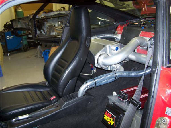

Intercooler: This is what sets the engine apart from ALL OF THE REST! Custom air to water intercooler based on a Precision Turbo P2000 core. The system was totally custom built by HellBent Racecars. It has a five gallon tank that mounts in the front of the car that is sumped for a pump that flows 3500gph! It circulates through custom lines and a super efficient heat exchanger that mounts where an air to air cooler would go. The cooler and piping all ride in the back seat area. It is the most impressive setup I have ever seen in a Porsche. On the last motor we made 7 back to back pulls on the dyno with tap water in it. It never got more than 3 degrees above ambient with no fan!!!!!! On the street it runs around ambient at all times. If you put ice in the cooler it with go well below ambient! This is where the huge reliable HP gains can be had. I have about 13k in design and parts in the cooler. Once again this was done to blow away the power potential and engine reliablility an air to air intercooler will allow. This is a SERIOUS INTERCOOLER! Everything is polished and the highest quality fab work available.

Here is an earlier version of the motor with the intake facing the opposite of what it does now. Also have twin wastegates on the headers now Gives you an idea on the detail and quality I am offering someone.

Here is the air to water intercooler before it was all polished. It is quite simply put amazing
