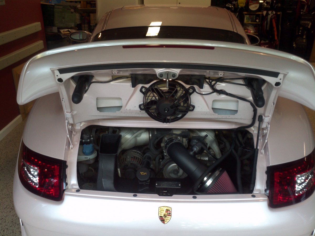

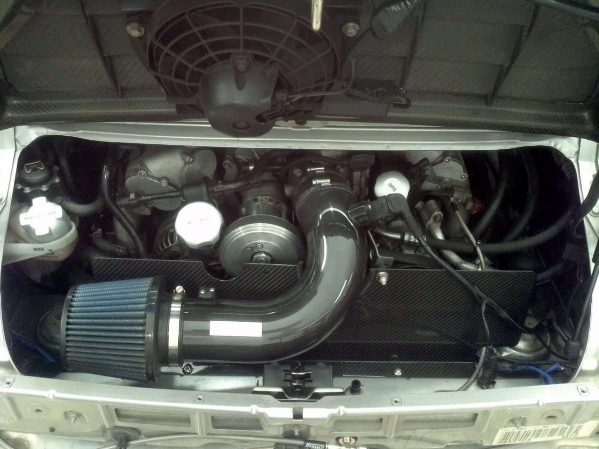

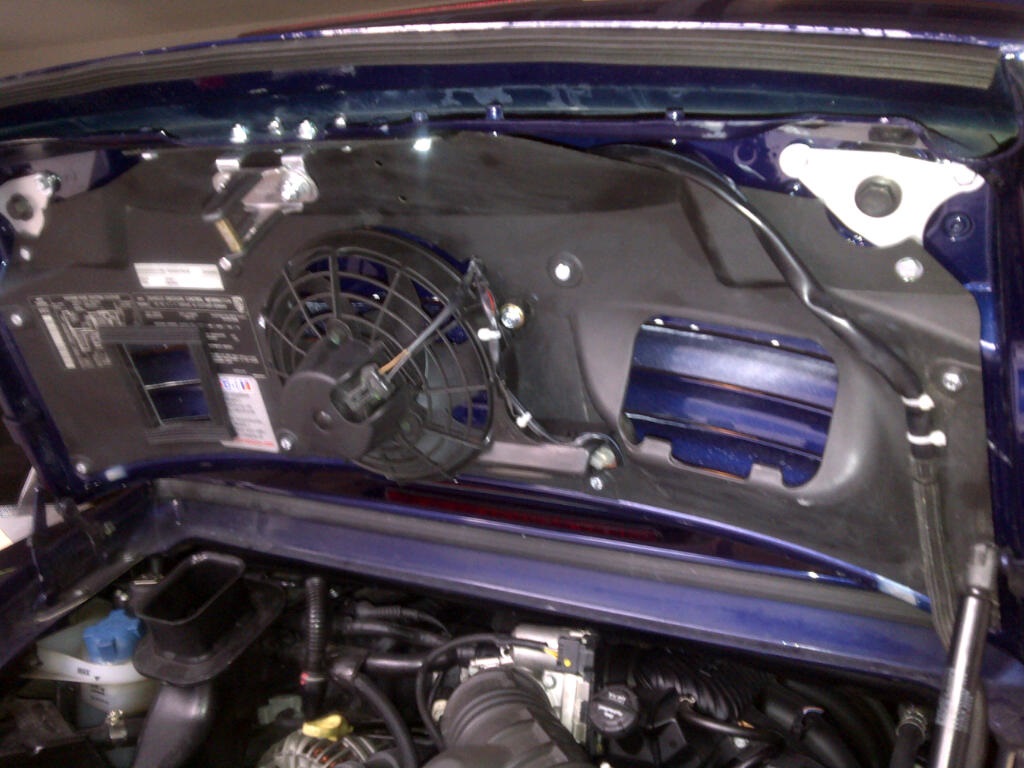

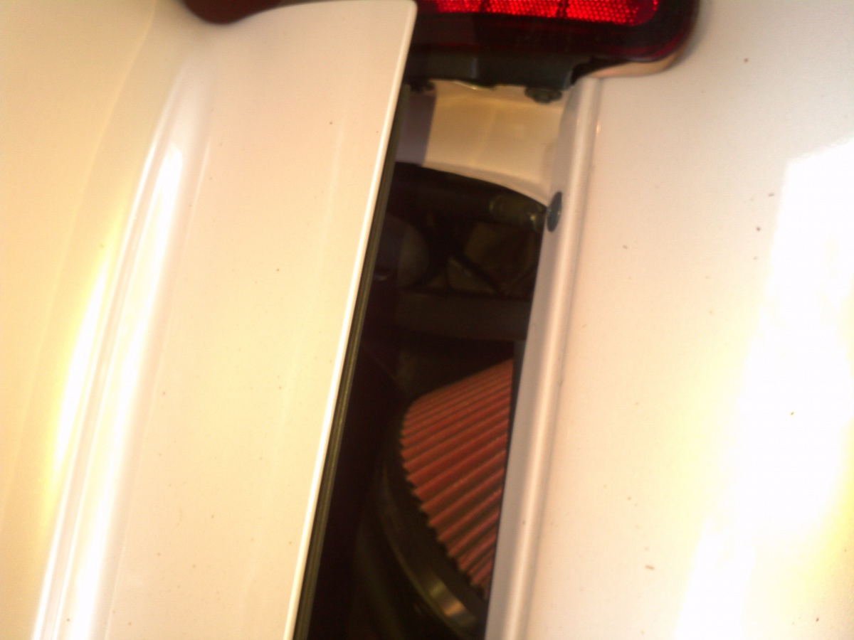

I also wanted to add some information. I installed a Turbo Decklid and spoiler on my wife's 2005 997.1 C2S and I think it looks great on the narrow-body cars since it's still narrower than the car. It is also fully functional just by plugging it into the normal wiring harness connector, which also disables the stock 3rd brake light and enables the one that's built into the upper wing. With the larger turbo wing installed, you can't always see the stock one and in some states it's illegal to have more than 3 brake lights, so it's best just to leave it disabled and not try to make both of them work.
The Fabspeed CAI will not fit unless you modify the location of the central cooling fan from the turbo decklid. The fan's position on the stock decklid is offset slightly to the left, whereas the Turbo's fan is in the center. I have the Fabspeed CAI on my 2005 997.1 C2S RUF R-Kompressor and test fit it to my wife's car as part of the decklid conversion before purchasing a 2nd one, and although it leaves plenty of room down the sides for the hydraulic spoiler rams, the fan from the turbo decklid will make contact with the carbon intake pipe (1 photo of my R-Kompressor engine bay so you can see the offset fan position and carbon air intake position).
There are two intakes that can be used without doing significant modifications to either the decklid or the intake - the full K&N Intake clears and there's actually one of these for sale in this marketplace used. I had installed one of those first but had some CEL issues so I swapped it for the EVOMS version that you see in the photos, which if installed as far left as you can leaves enough space for the right hydraulic ram to pass by it.
In fairness to K&N, I may have installed the MAF sensor backwards, which could be what caused the CEL issues (learned this after making the change to the EVOMS intake and returning the K&N so I couldn't verify if this was the case or not). One thing that I like much better about the EVOMS one is that the pipe that has all the clamps is metal, whereas the K&N is plastic so you can get the clamps on the EVOMS one nice and tight to ensure there aren't any air leaks and don't have to worry about deforming the pipe with too much clamp pressure.
Thought some of this might help those of you looking to do the turbo decklid conversion.
