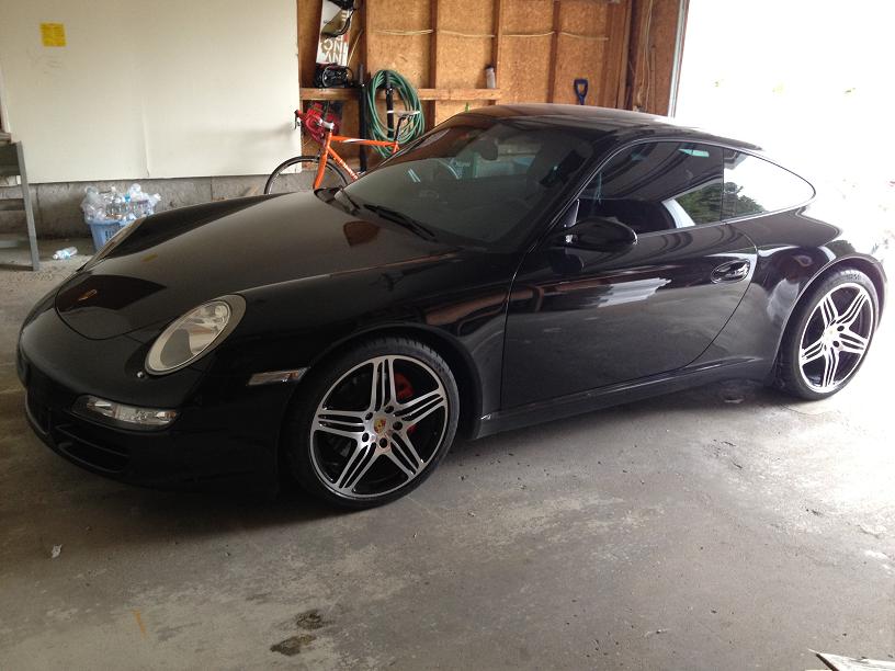

Any narrow body 997 ordered with Turbo wheels have a 67 offset. That being said, I run a 51 in the rear and also have a 5mm spacer on my 997 C2S.

You can but you don't need to. The rear wheels will sit 16mm out per side so it will be a nice look and I would suggest trying this before buying 5mm spacers. I added the spacers as a trial and decided I liked the extra aggressiveness. I initially put a spacer on one side and compared to the other side...I also tried 7mm and believe it or not that 2mm made a huge difference and I did not like it.
So to answer your question, I don't have any issues with my setup.

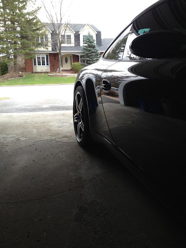

I just bought a set of Turbo wheels and yes the rear wheels sit just fine under the fender. The offsets are perfect imo for my tastes. I also used a 5mm spacer for the fronts.
