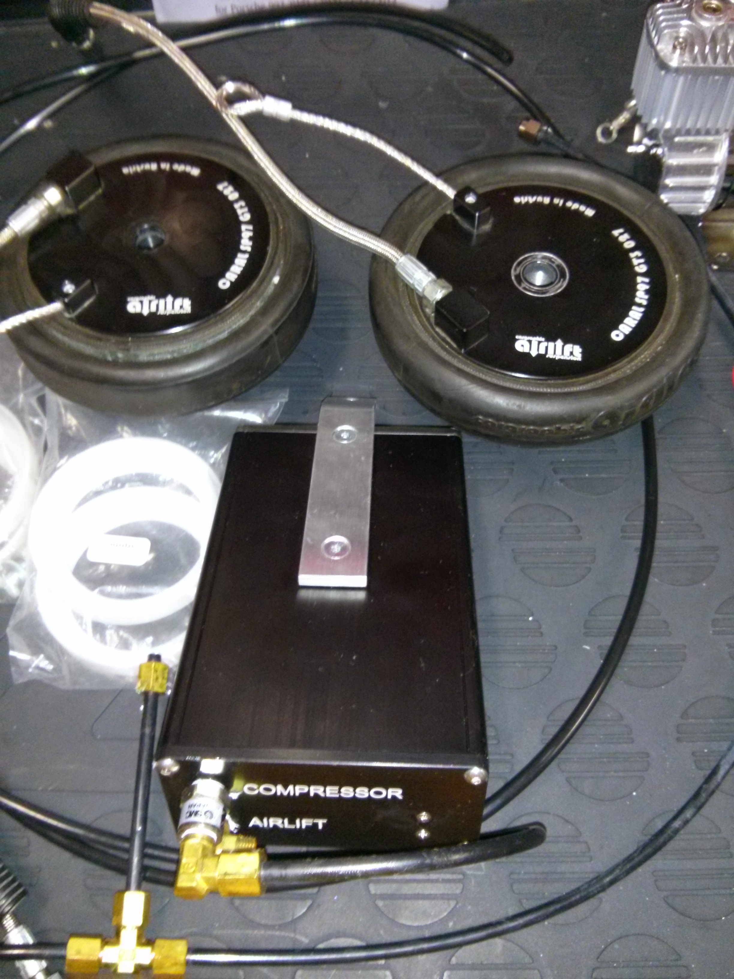

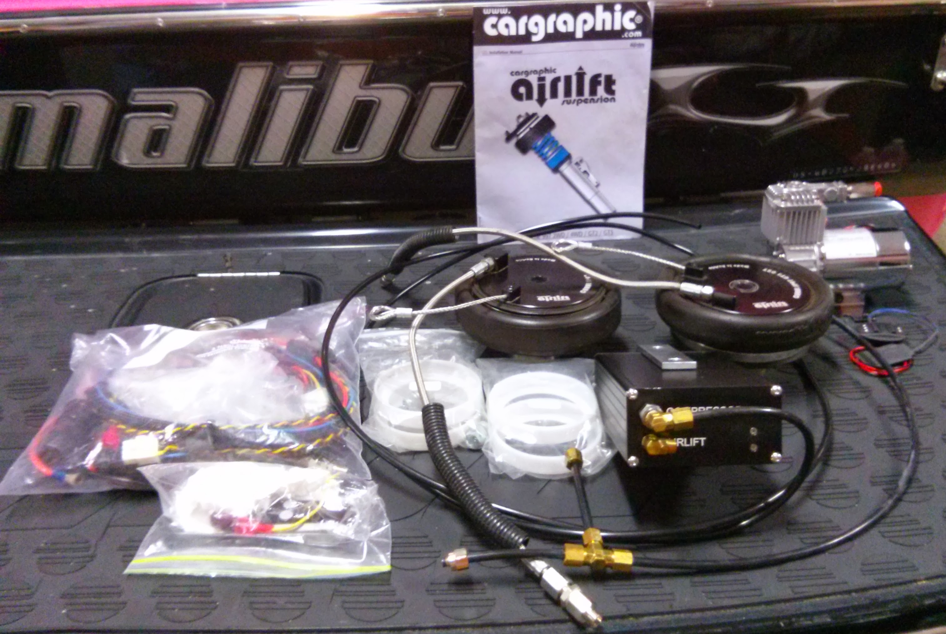

Tired of scraping the low front spoiler lip or expensive aftermarket body kit of your 996 or 997 GT2 or GT3 on angled driveways and speed humps - wouldn't it be great to just lift it up a little and drive up or over without waiting for the crunch and scrape to happen - ever wished you could lower the ride height of your GT P-car for looks or better Aero, but don't want to risk front end body damage - well now you can with this Cargraphic Airlift Complete Kit in excellent condition. It allows you to raise the front end of your GT2 or GT3 up 2.8" from the set ride-height (2.2" at the shock towers wihich translates to 2.8" at the nose - see brochure).
I purchased this from another forum member; in my excitement to find one of these pre-owned, I did not realize there were different kits for the GT cars than for the non-GT narrow-body cars, and this kit that I purchased was the version for the GT2 & GT3 cars and is not compatible with the non GT cars (I have a C2S). The reason is because the Bilstein kits for the C2 & C2S cars have a narrower spring inner diameter (60.5mm) than the OE or Bilstein coil springs for the GT2 & GT3 cars (62mm). This Airlift kit has the 60mm lift support tubes and will only work with the larger 62mm ID GT2 & GT3 coilovers, but it will work with either the Original Equipment PORSCHE coilover suspension in these cars or with the aftermarket Bilstein coilover kits for these same models. It also works with PASM Coilovers (Bilstein Damptronics) and with non PASM versions.

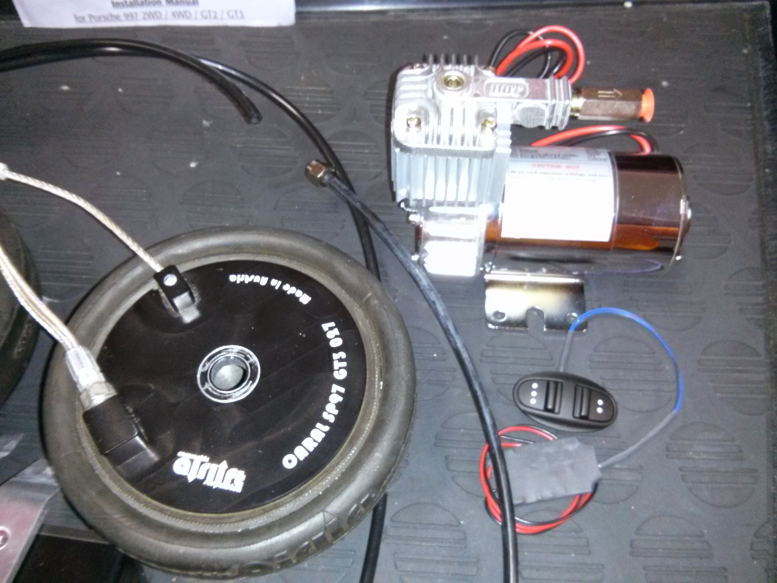

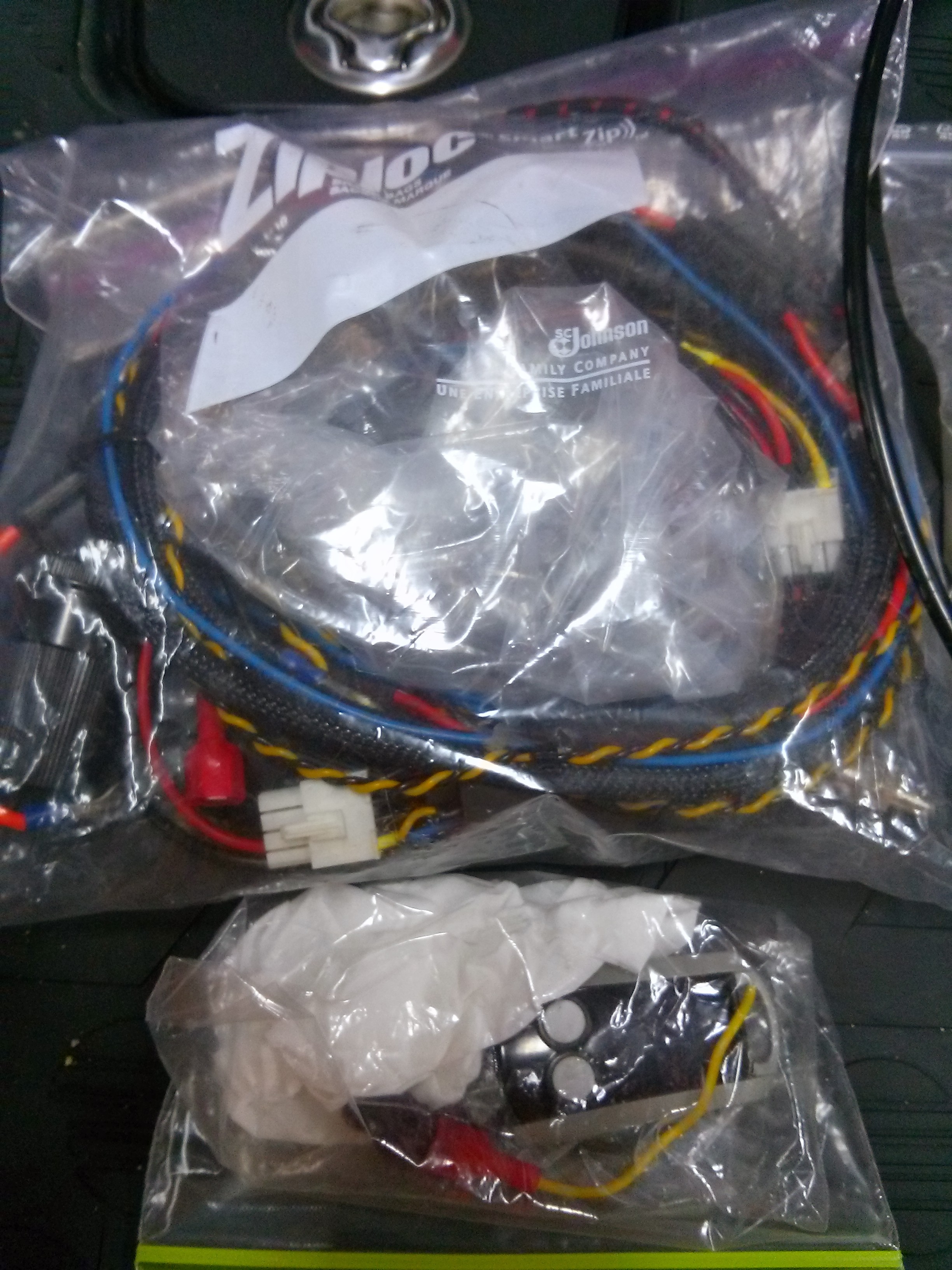

Also, before realizing that I would not be able to install this kit on my car, I had also purchased some very nice upgrades from Cargraphic to work with this kit, like the separate upgraded compressor and the roof console control switch (replaces one side of your HomeLink buttons for a factory OE appearance). The original design of the Airlift kit used the OEM compressor as the air source for the lift, but this compressor is noisy, slow, and not really designed with a duty cycle for regular use. The upgraded compressor is quieter, more powerful, does a faster lift, and makes the wiring cleaner and simpler. The silver compressor you see in the photos is the specific Cargraphic upgraded unit (part # CARRSS100C) and is brand new, as is the Roof Console Control Switch (part # CARALSSWITCH). These 2 items by themselves are over $750.

I'm selling the complete kit including the upgrades (everything you see in the photos) all together for a fraction of what any other front-end lift kit would cost you - it's less than the cost of a good set of used wheels, and far more functional.
