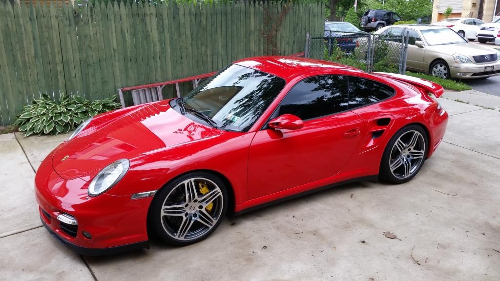

Quick longer term update on my flash. I now have about a 1000 miles of enjoying the flash. Launch control works great, I've done some 3.5 0-60s on unprepped street. I have also made some 11 sec passes on the vbox. I quickly realized that stock clutch even with 12k babied miles will not be friends with new found power. I sourced a new uprated clutch and will be replacing it soon. Meanwhile I lowered the car on some Champion/H&R Springs and put some 7/15mm spacers on.
