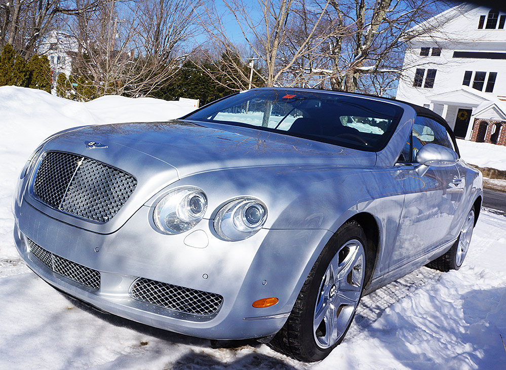

108 is better than 105 http://www.tirerack.com/tires/tirete....jsp?techid=35 . Perhaps you should simply go to the dealer and let them install the tyres and rims so you can rest easy as you know they say they are ok.
My favorite time of year is summer top down and winter snow. Especially the snow as it is akin to a car control clinic.
