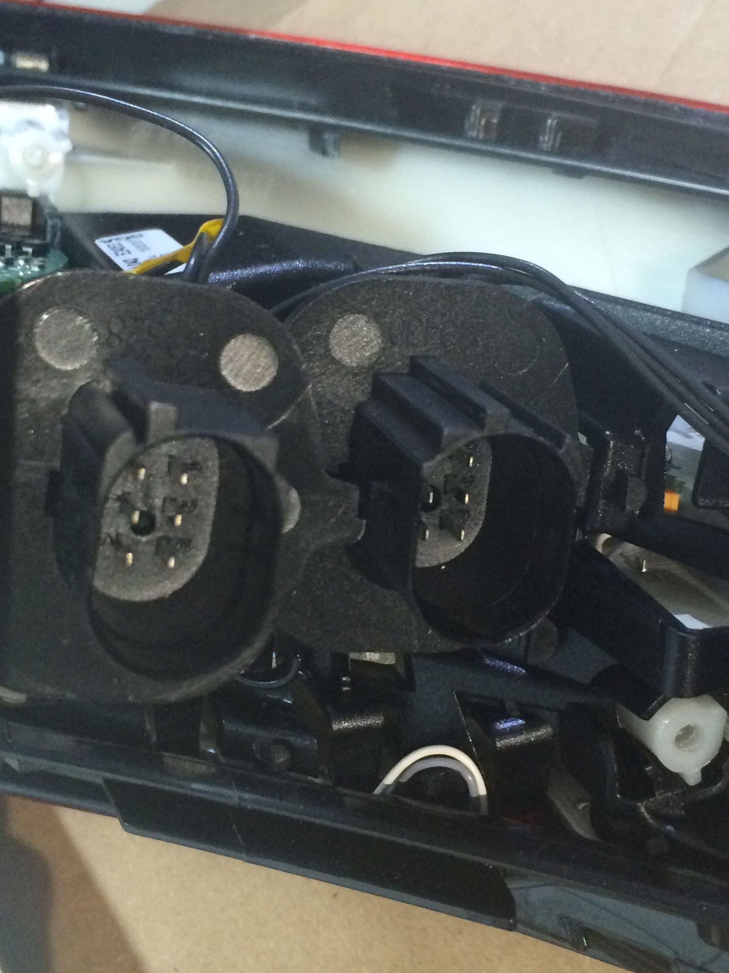

Eventually I found a right OEM Euro tail light (amber turn signal instead of red USA) to match the left side (amber when I bought the car). To my surprise I realized the adapters have a small difference and would not fit. Fortunately I resolved quickly this issue by swapping the male adapter from the OEM USA tail light with new OEM Euro tail light. After opening the tail light cover (7 torx screws) it is quite easy to unplug the internal wires and remove the male connector. Internal wiring is identical from OEM USA to OEM Euro.

mblueracer, I have just run into the same issue as you. A Rennlist member directed me to this thread. Purchased a set of 997.2 LED taillights that from all other accounts looks identical to the US spec lights aside from the connector. I had no idea these were Euro-spec until you enlightened me.
Do you happen to have or know the part number to the US spec connector? I'd rather buy a set of the connectors and have two full working sets of lights rather than just swapping them between lights. TIA.
