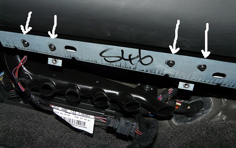

my CGT of driver side it look little bit off.also you can see the dim light button off too.anyone know the parts can buy?

Not sure about the dim light button, yet that fuse box/leather panel is attached below by four screws (see attached pic). This panel is hand fitted, so loosen the four screws, realign the panel and have someone hold it whilst you retighten the screws. It could be that panel has become slightly mis-shaped, and thus does not have the proper curve to then close/click the closing/holding bit. If that is the case, you'll need to remove the part, re-shape it, then reinstall.
