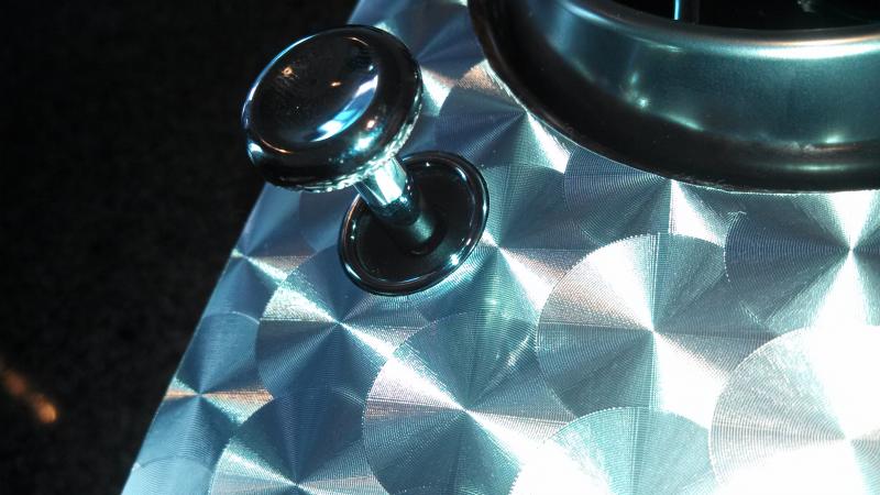

12. For air vent, unfortunately since the material cannot curve and will not hold, you will have to cut around the edges a bit so it lays evenly flat. You will see your wooden piece of the dash slightly but It is small and insignificant.

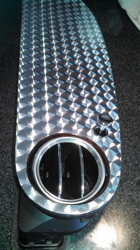

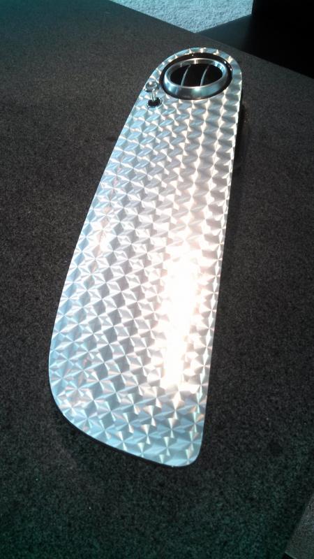

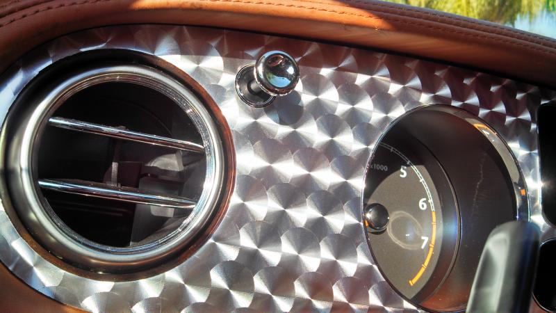

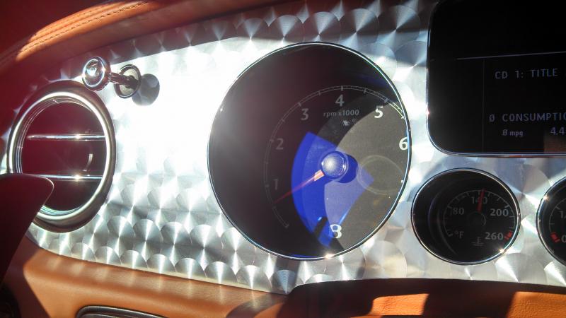

Enjoy pics : )

Enjoy pics : )

Yes! I know that the only part with this. The material will not bent/flex and stay on edges like that so i have to live with it.
