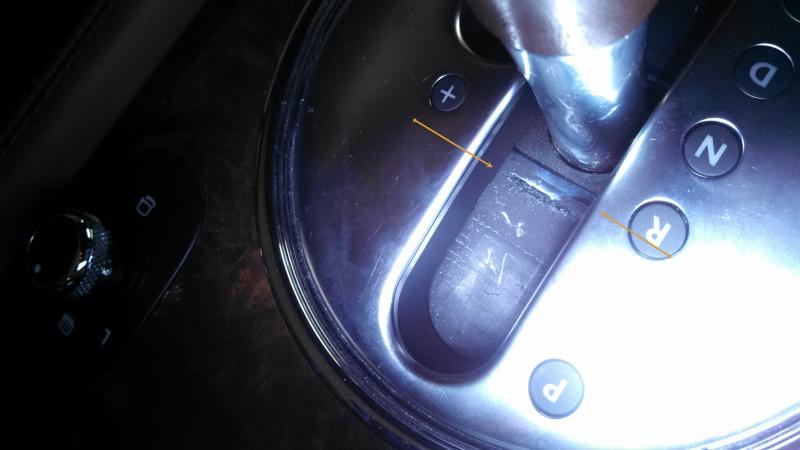

My shift **** has a broken rubber piece that has disconnected and fell exposing the shift assembly. Bentley stated that this piece is not available for purchase and the entire shift assembly must be replaced. Cost to replace, $2K. Seems insane so this is the DIY.

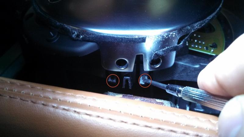

2. Once you get to the shift assembly you will need to take off the metal ring. On both sides, use a screw driver and place it in the holes to push out the teeth, wiggle up, it will lift up.

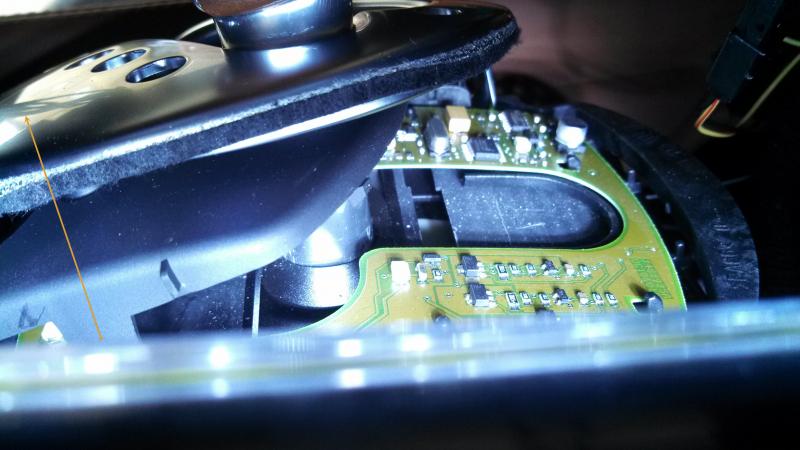

4. Under that you will see the circuit board. This circuit board is held by teeth. Again, pop off the circuit board very carefully and lift up. Do not disconnect any wires.

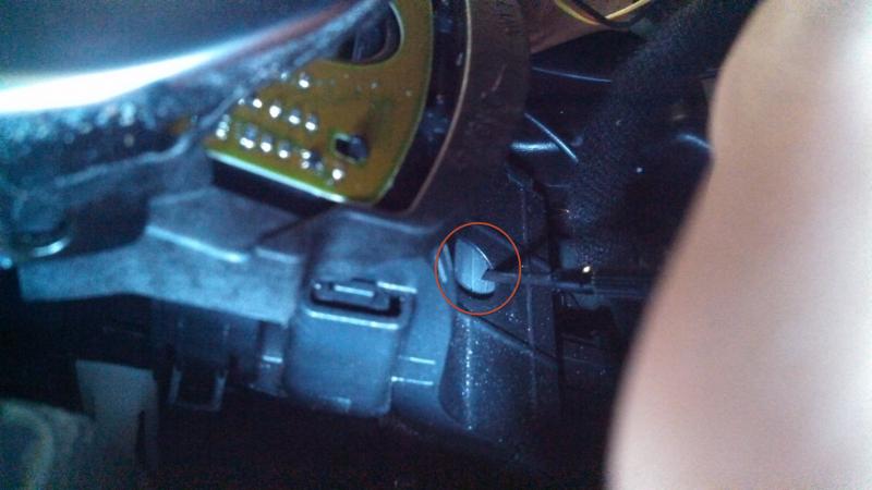

5. On both sides you will see a small circle. In one of them you will see the piece that has fell and got stuck. Place a screw driver in there and push up. The piece will slide up.
