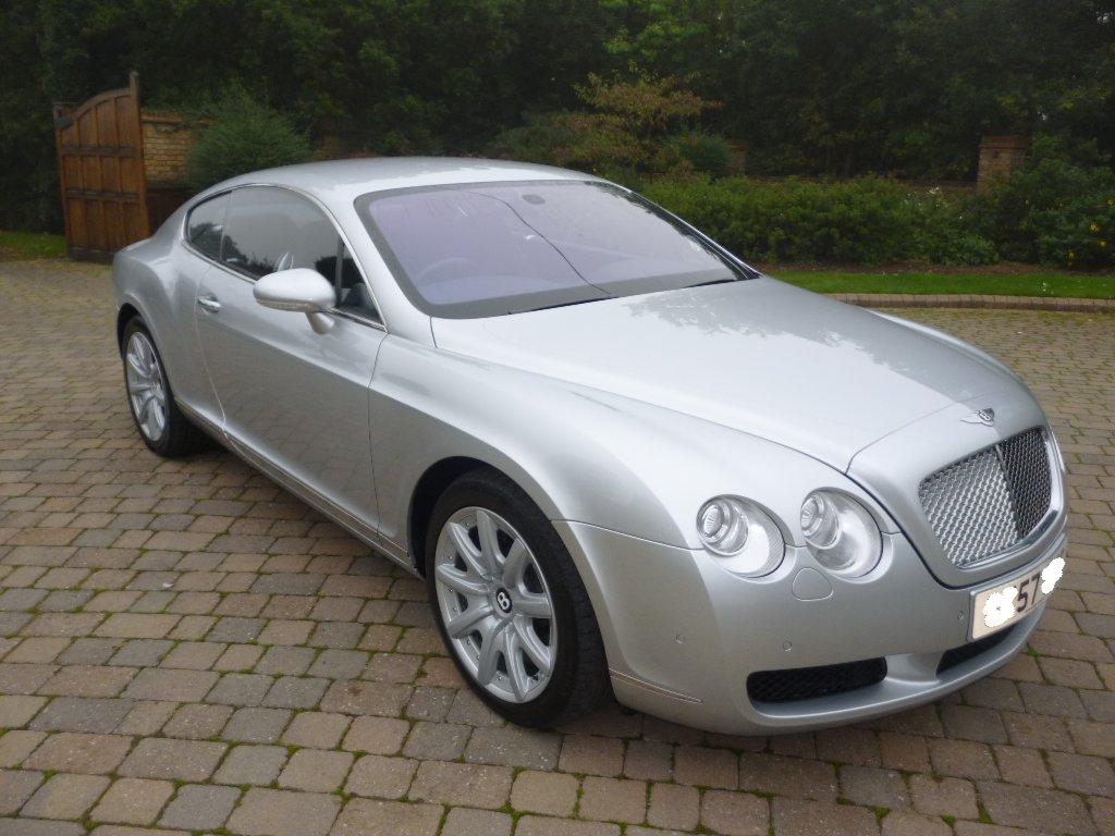

Well a little update, the car is now back with me after it's service and luckily there was nothing major wrong.
It was due a major service, however I was advised that the plugs were recently done (about a year ago) so they were not required.
Apart from the normal items required for a major service, the centre brake light was also changed, and the fault with the central locking turned out to be something that had come away on the door latch.
The final bill came in at £2,500.00 plus the tyres which were just under £1,000.00. But at least now I have piece of mind the car is fully sorted for another year.
I do just have one question that I was hoping someone would be able to answer - When I get my daughter in or out of the rear it seems like the drivers seat will not go back to my position and I have to keep re-adjusting it. It's not a major problem but a bit of a pain. The memory function on the seats do not seem to work either... Trouble is I do not seem to have the owners manual so I am unsure if it is simply a case of something needing programming or a fault. I only notice this issue after getting the car back from its service.
Any advice would be appreciated!
Picture attached.
