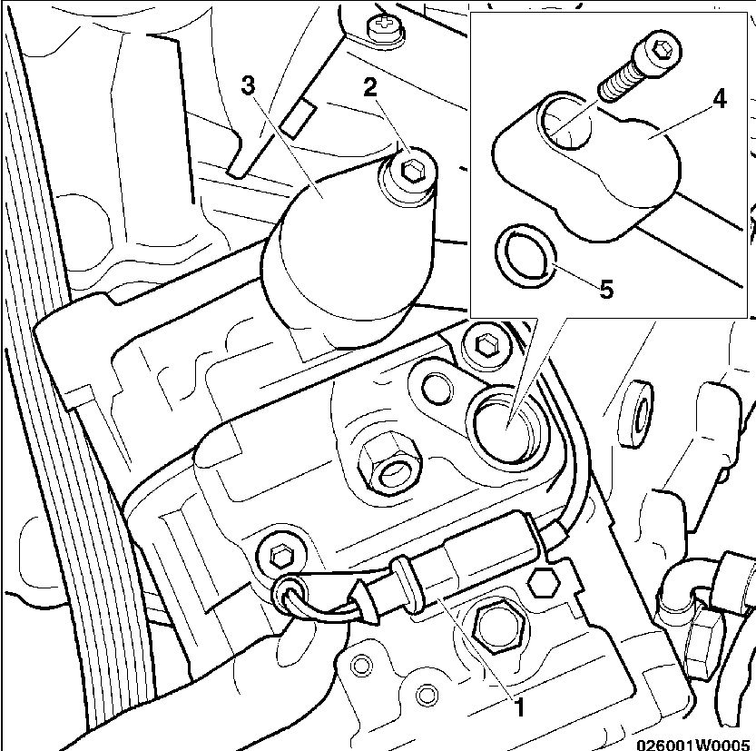

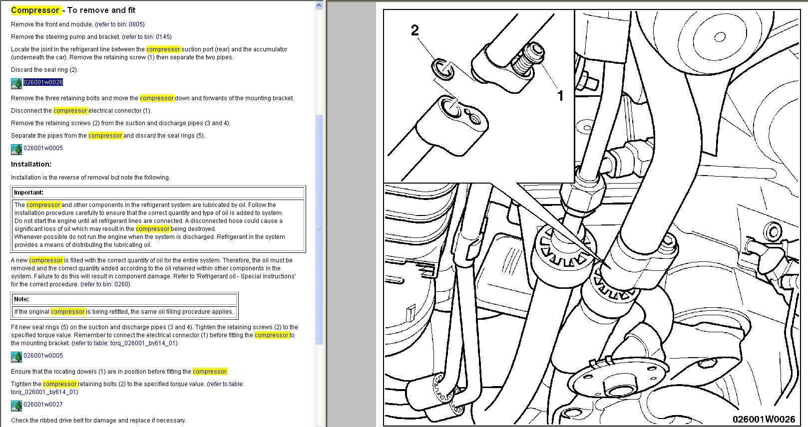

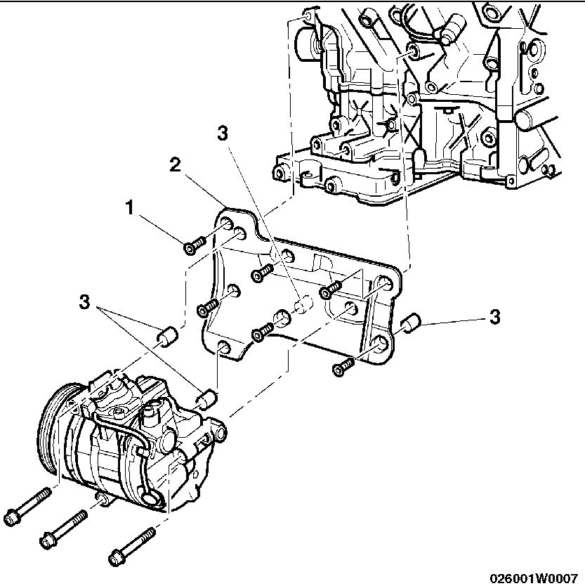

This may get you started. If you want more, please PM me. There are several diagrams and sub-assembly instructions.
ID:	384003   Click image for larger version
ID:	384004   Click image for larger version

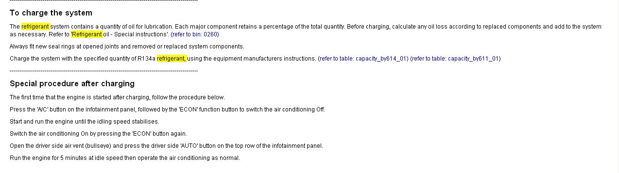

Here are two more relevant sections from the IETIS manual. In the capacities chart, the right column is US measurement. The one immediately to the left of the right column is Imperial measurement and the other column is Metric.
ID:	384450   Click image for larger version

Thank you again for sharing your knowledge. AC working great with no leftover parts, escaped with only minor scratches!
