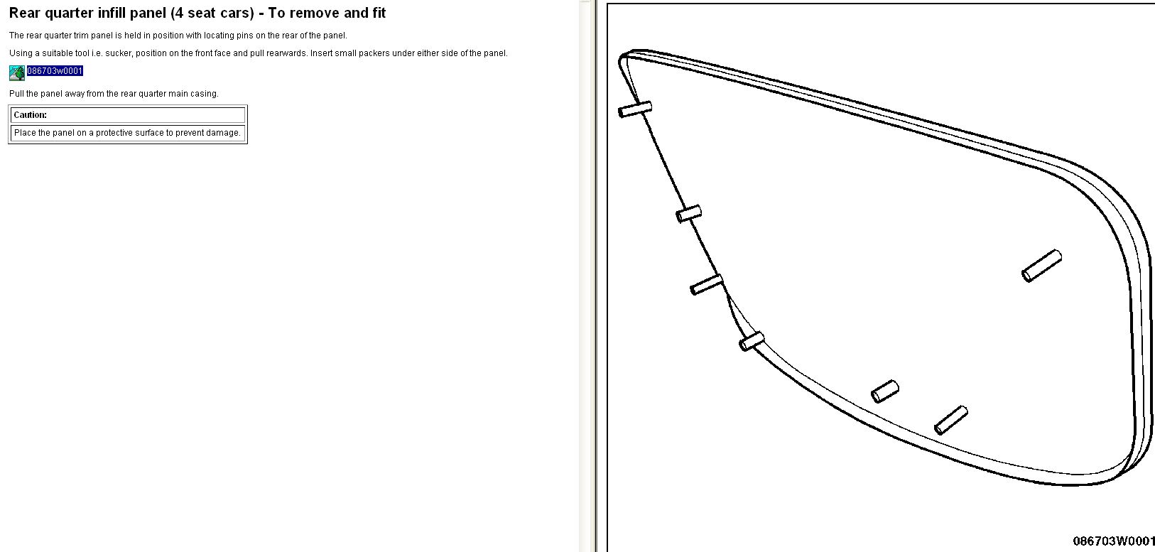

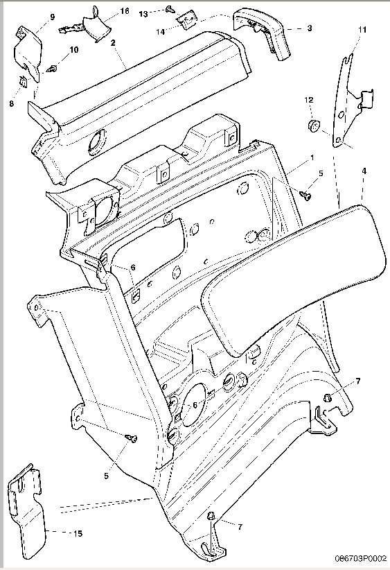

These two attachments will get your started. PM me if you need more.

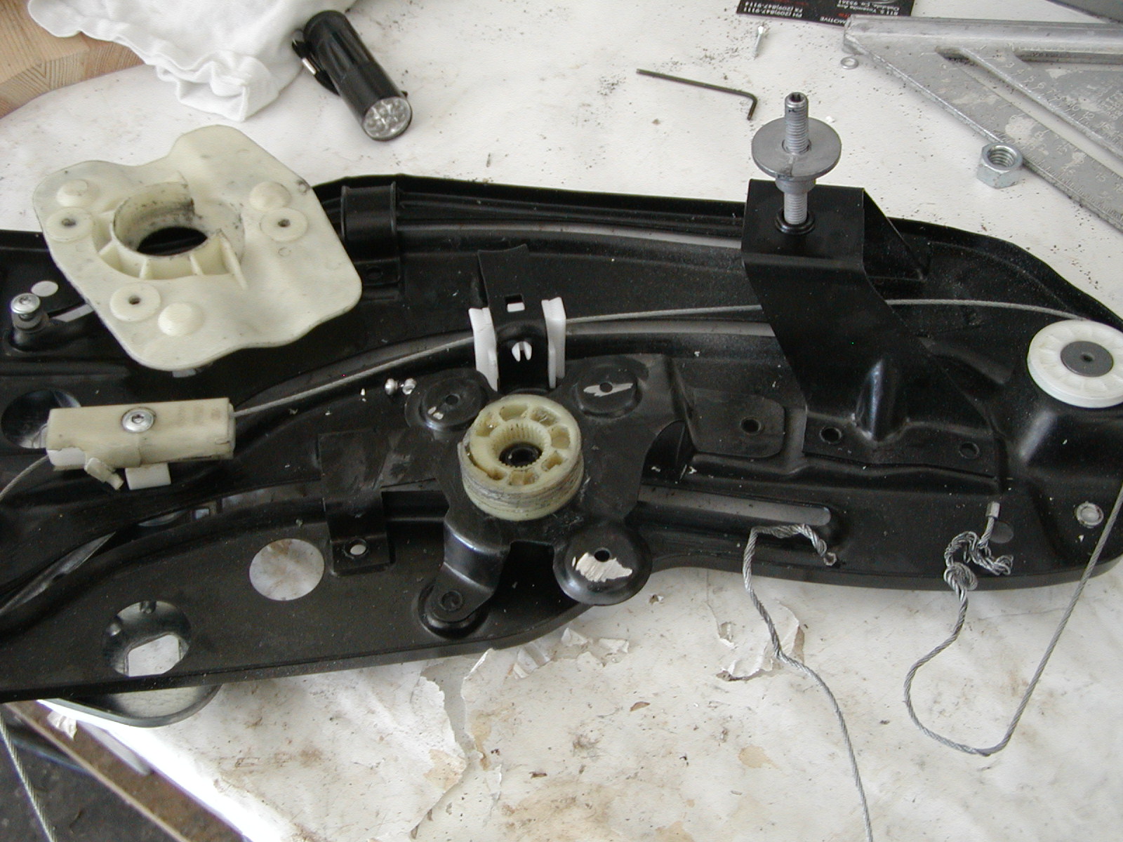

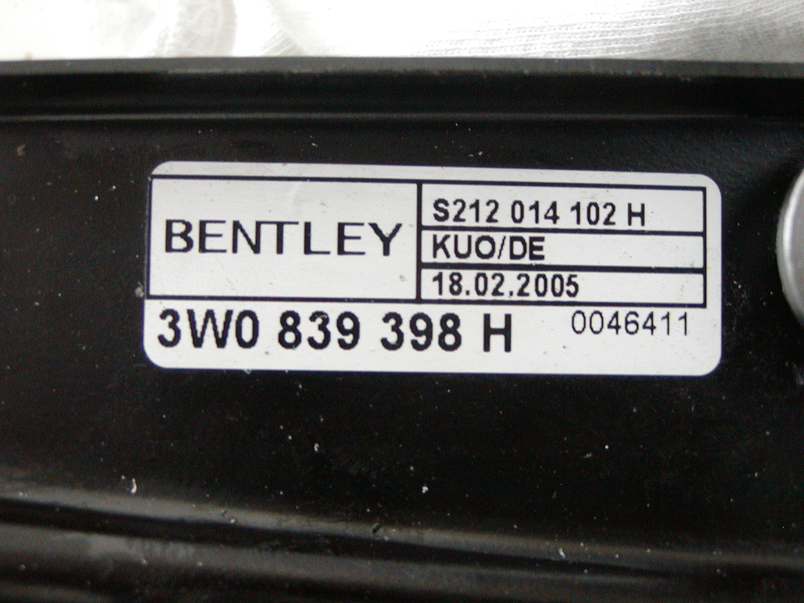

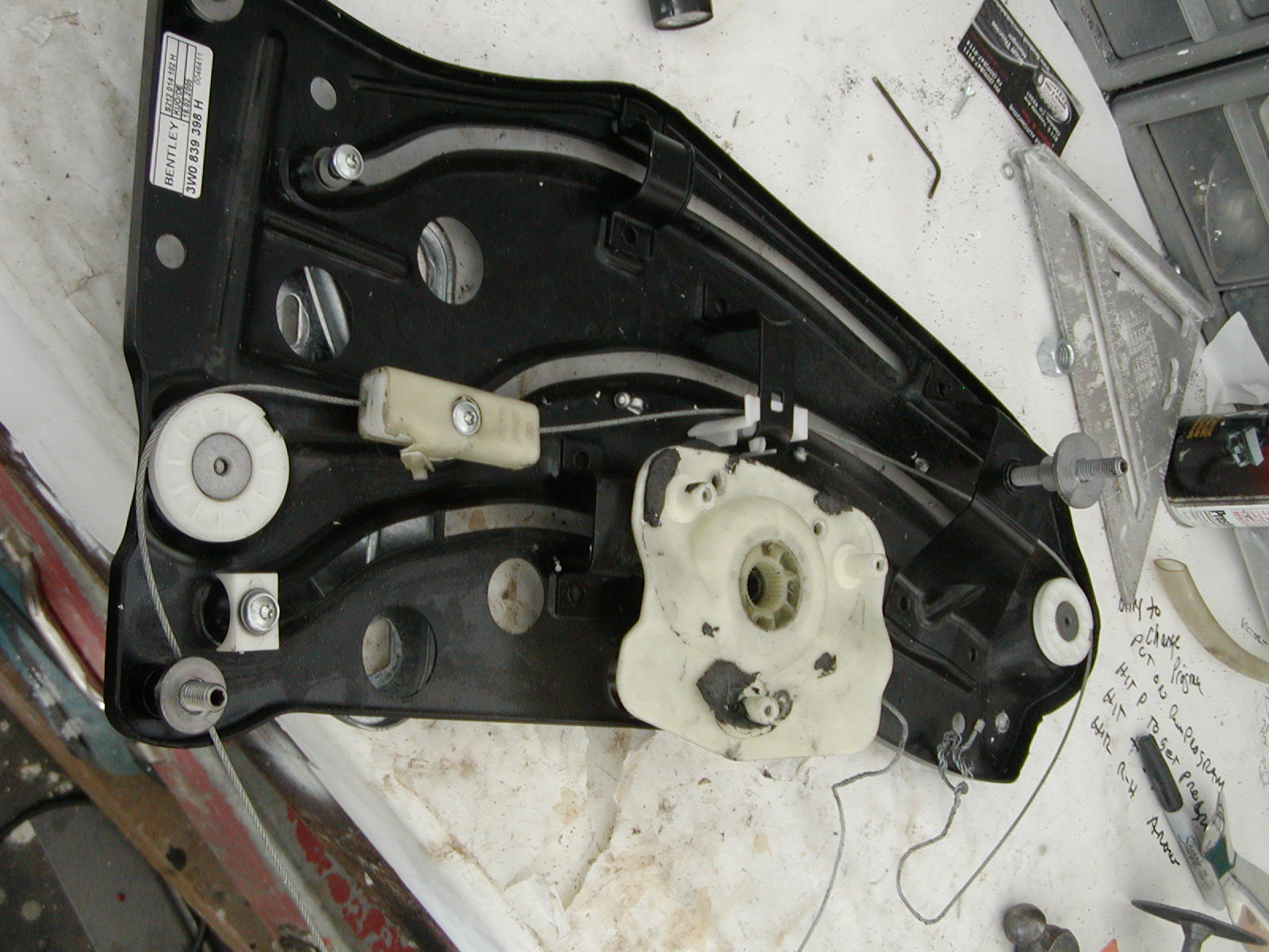

any used parts out there?

Update.........with the help from the DVD from Flying Spares and PMS I R and R the rear ort window reg in about 3.5 hr including the adjustments. The part was purchased from flying spares for 179 Pounds including shipping. It was a modified unit without the motor.
