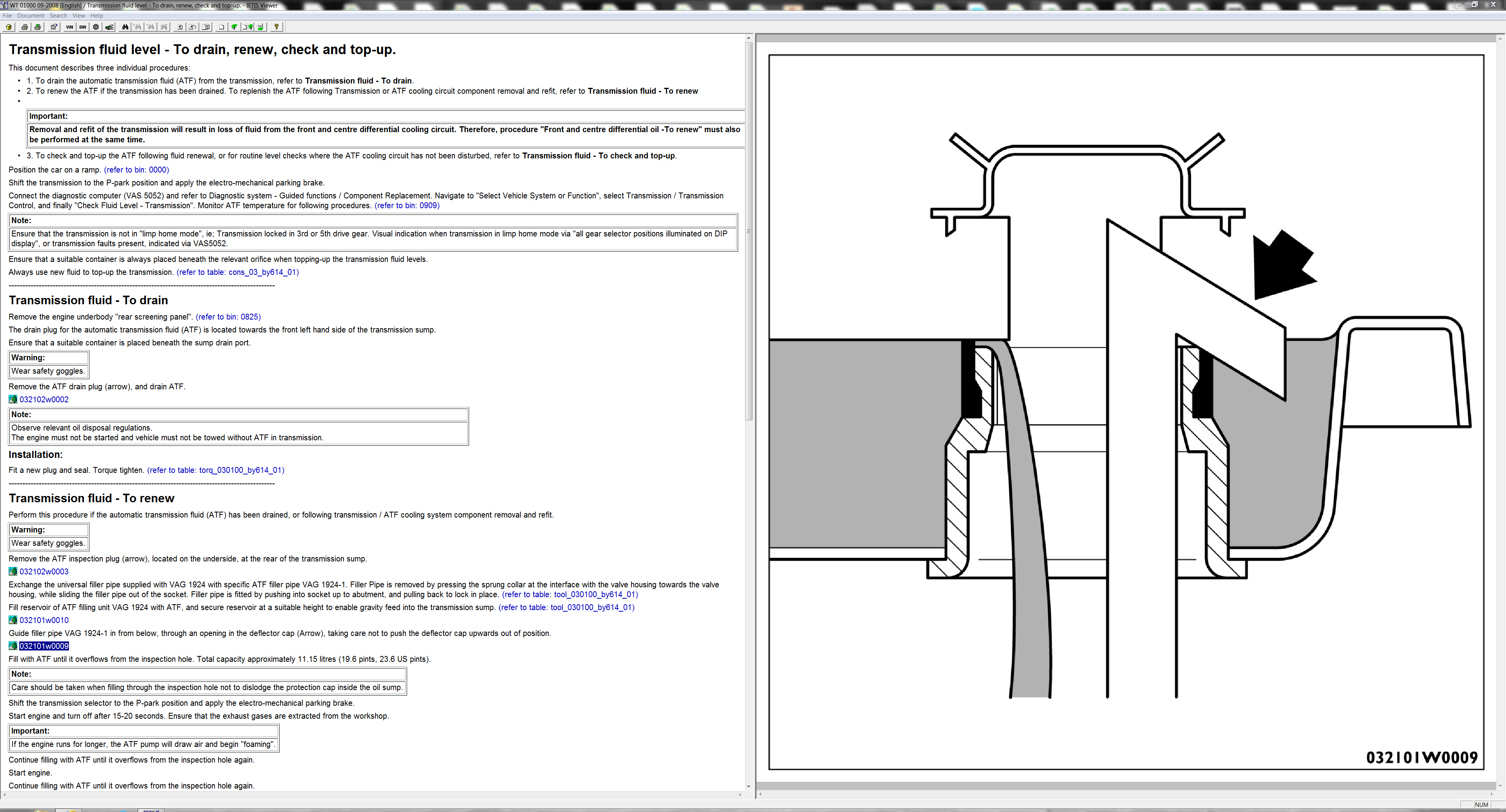

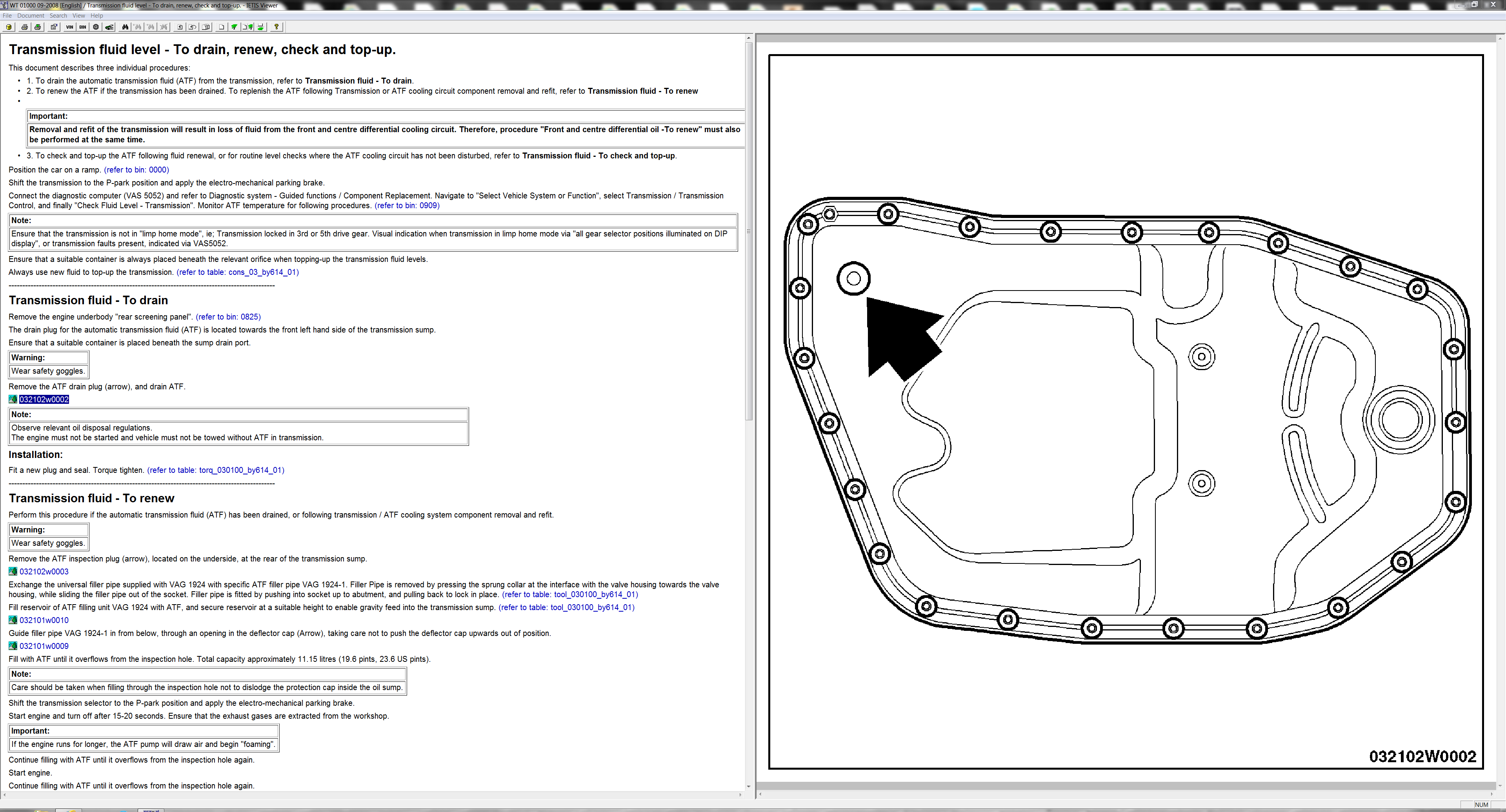

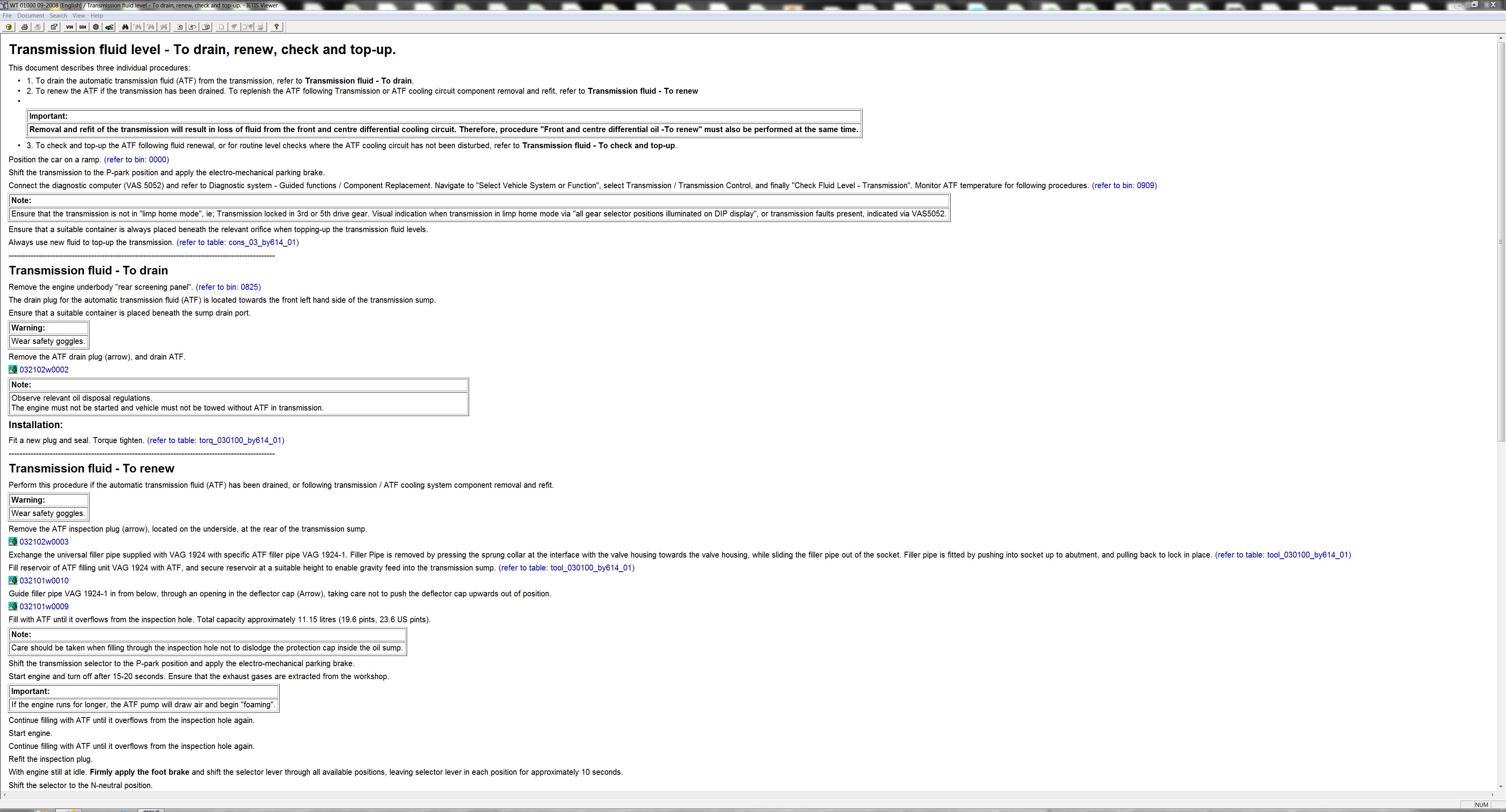

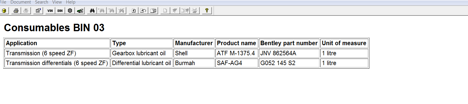

Service manual says Shell ATF M-1375.4 (Bentley part #: JNV862564A). Note: manual says you must also change the front and centre differential cooling circuit. lubricant oil (Burmah SAF-AG4).
Also note the fluid temperature. Use the VAS 5054A. {navigation} Guided Functions/Component replacement/Select Vehicle System or function/transmission/transmission control/CHECK FLUID LEVEL-TRANSMISSION. The replaced ATF needs to exceed 85C to ensure it fills the cooler circuit.
There are a number of steps required when you change the ATF. If you want full instructions from the IETIS manual, PM me and I'll provide.

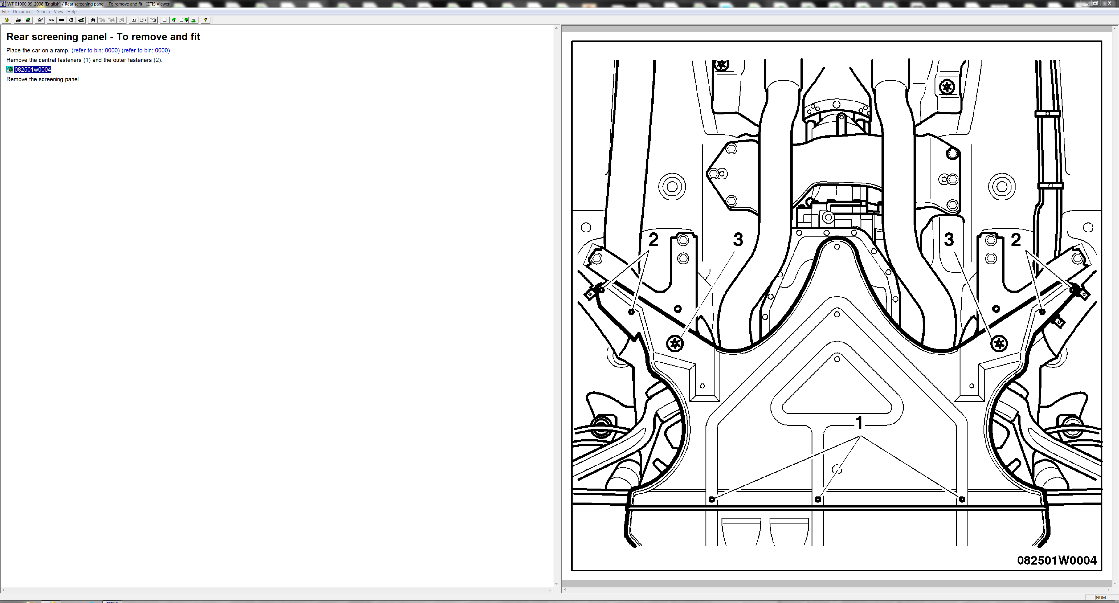

Hi mate,
I recently got 06 Bentley Continental Gt and bought VAS 5054A and about to do transmition oil and filter change myself, any chance you could provide instructions from IETIS manual to do the job properly please?

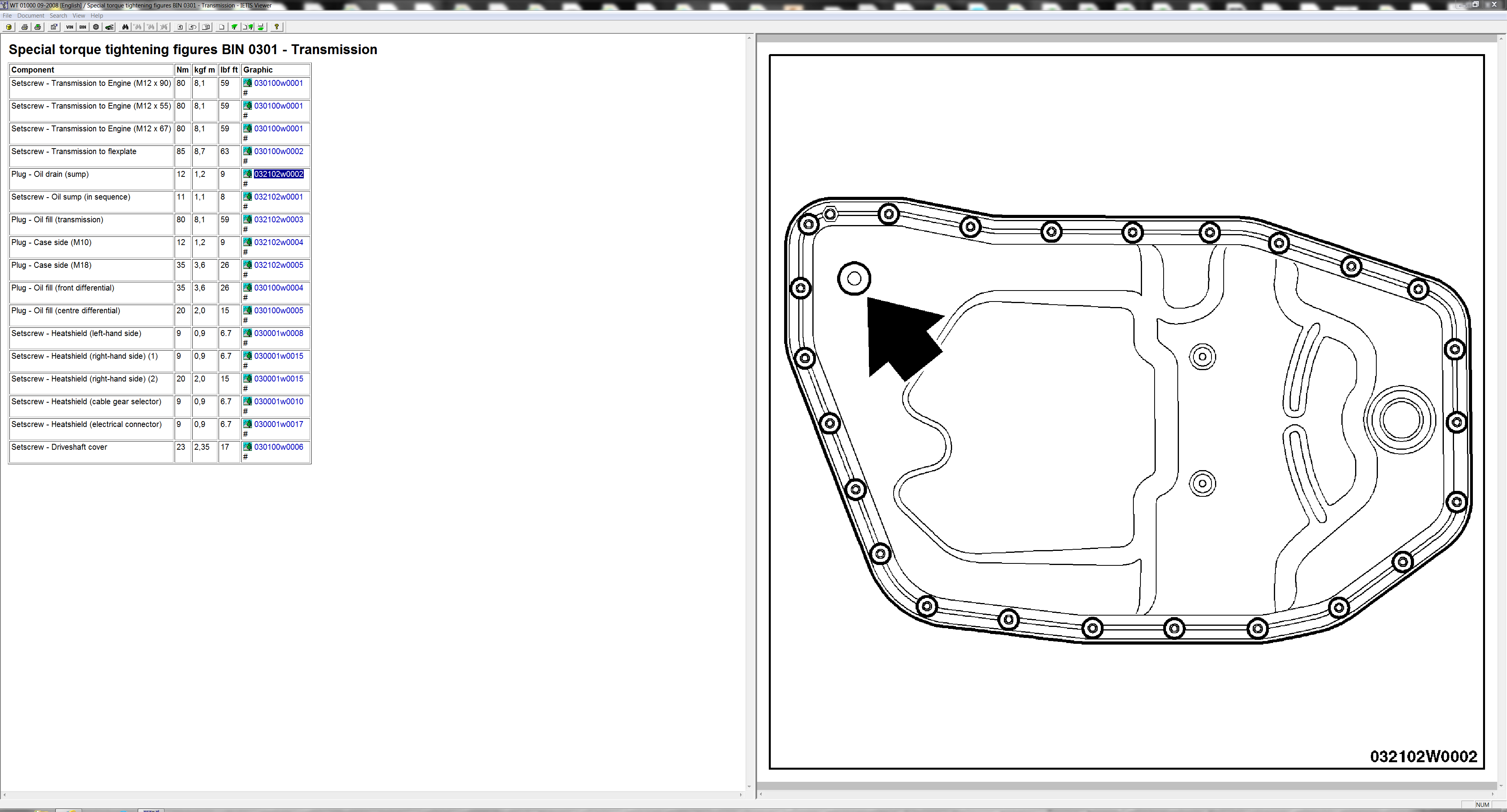

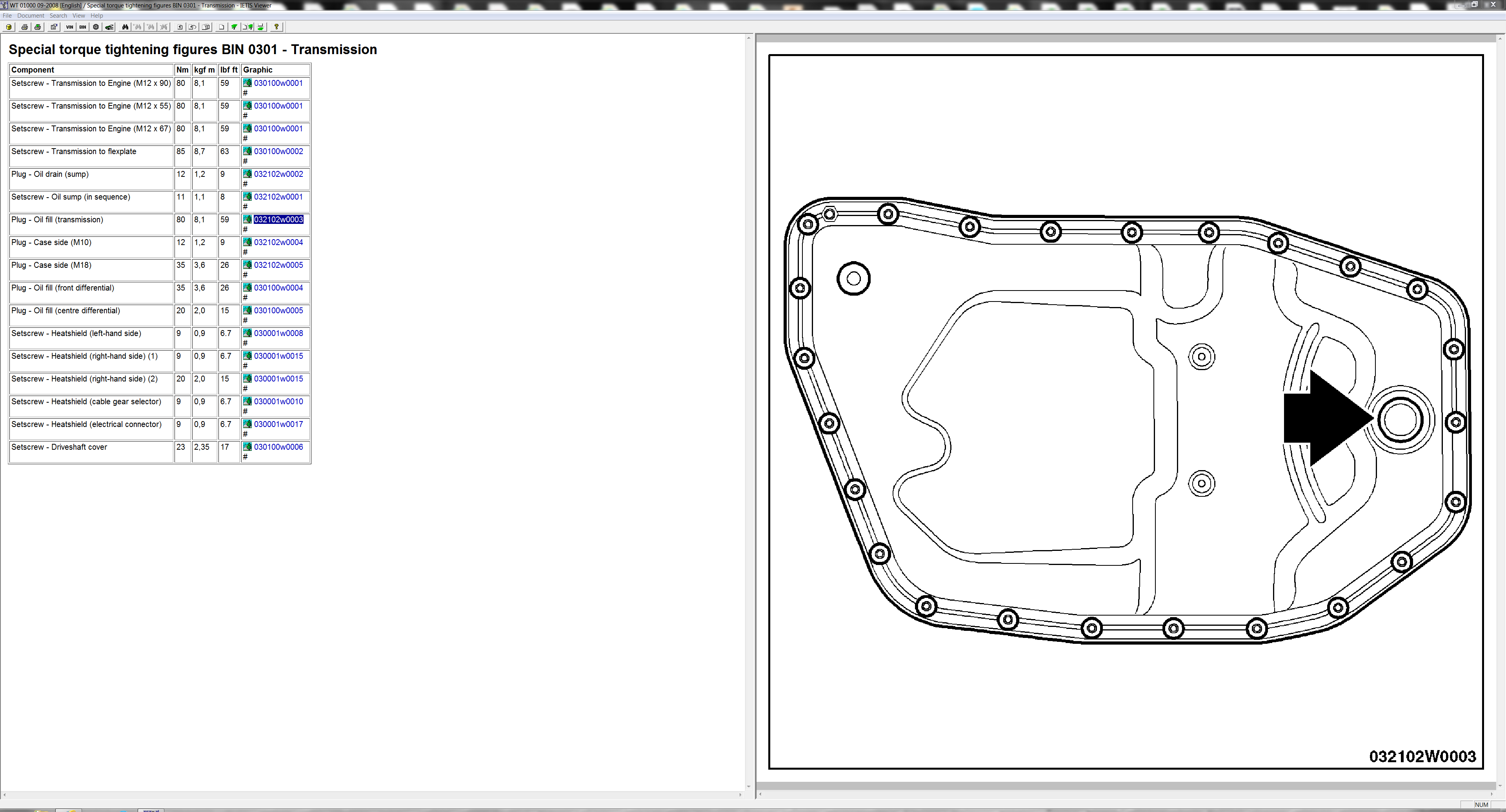

Originally Posted by alexxx
Hi mate,

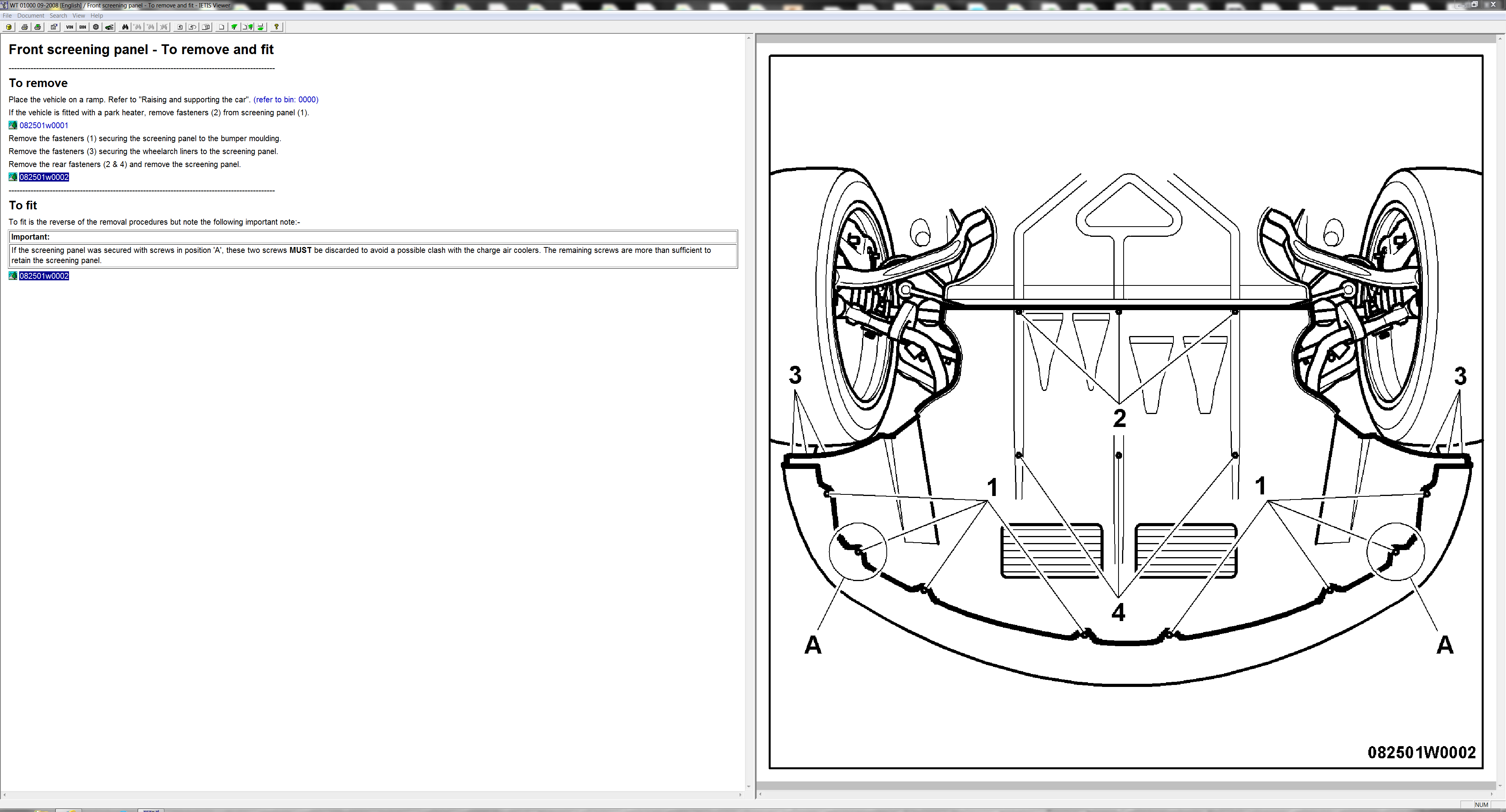

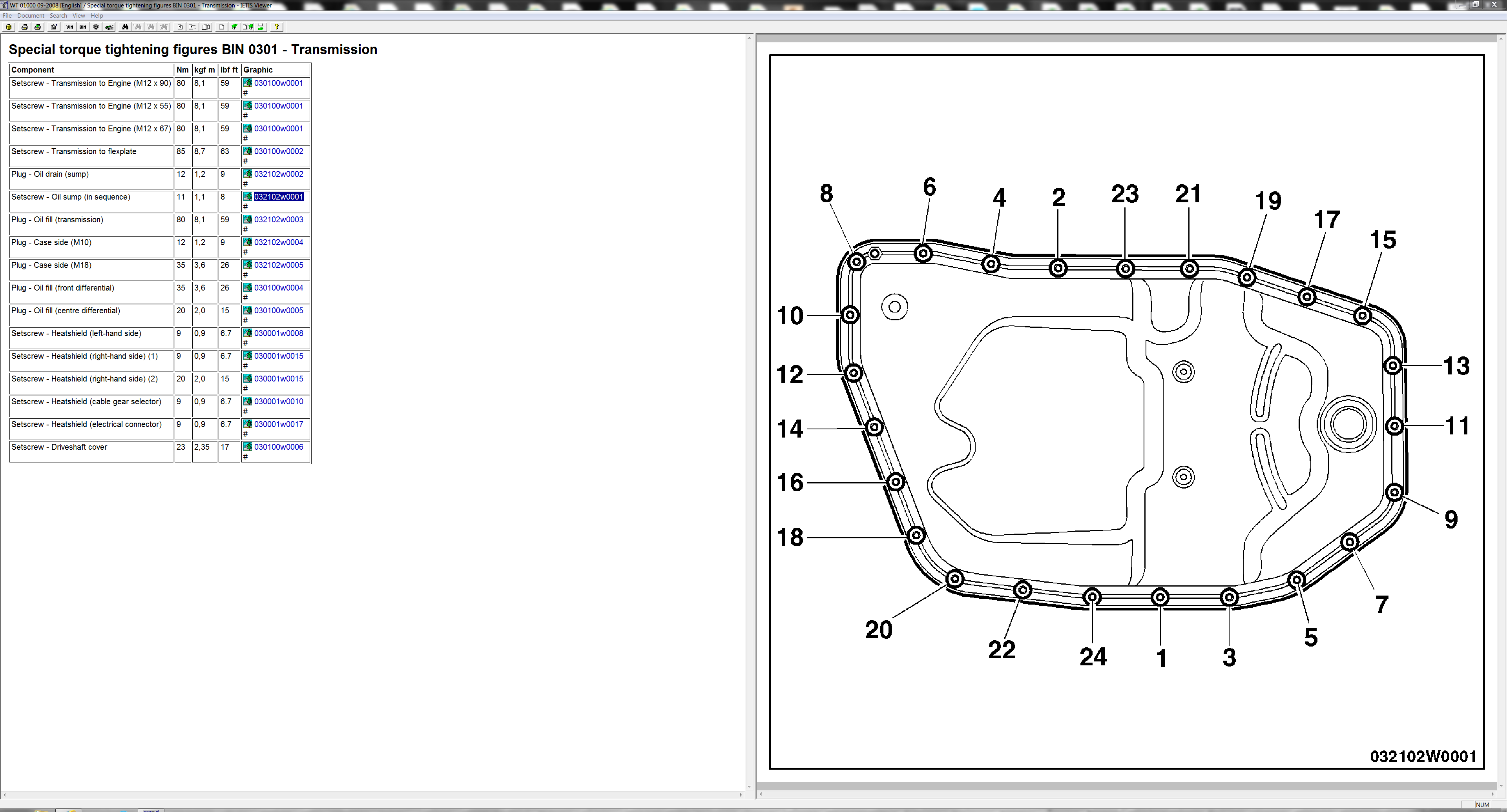

Hello Alex,
Click on the screen shots.
