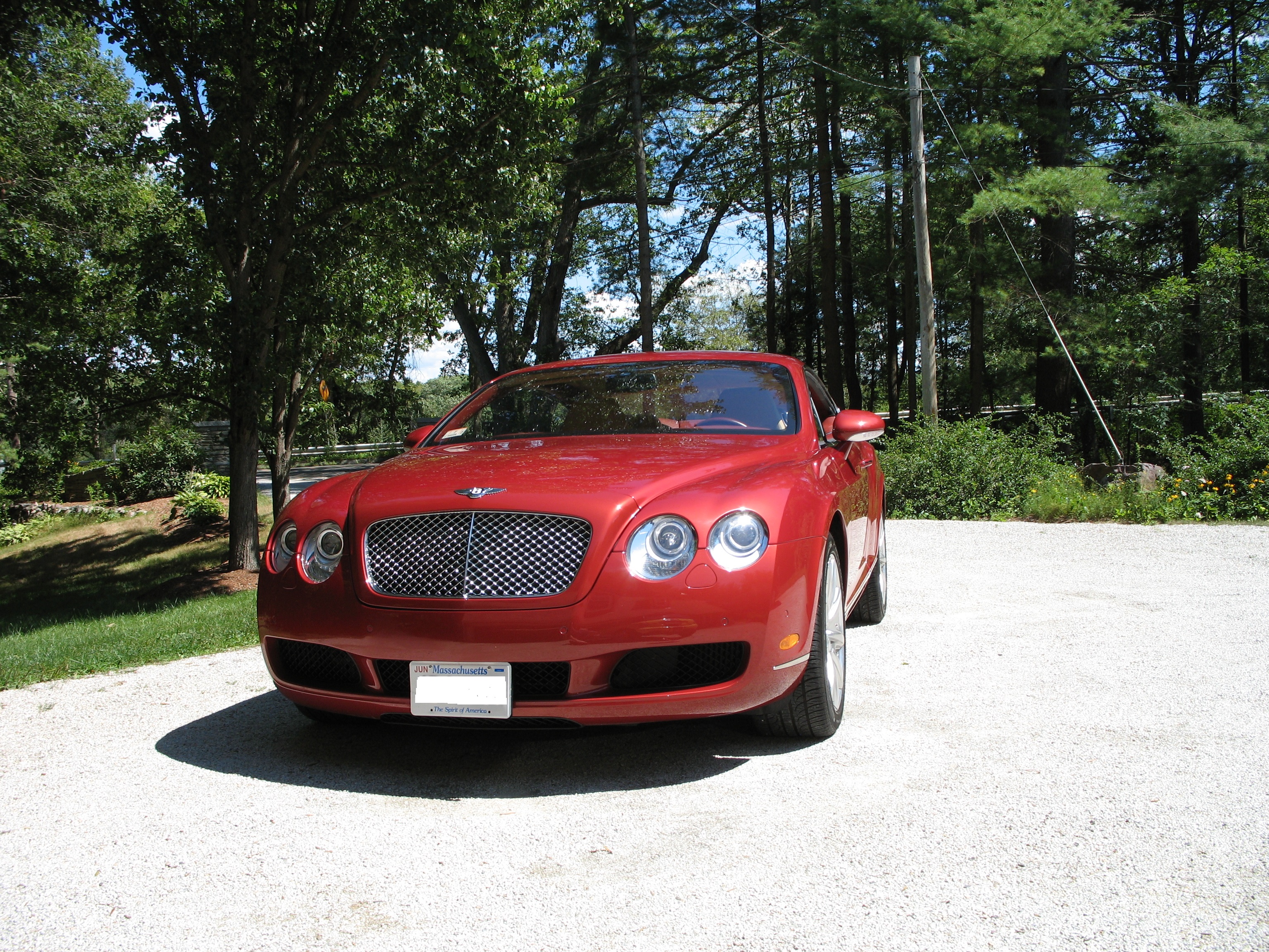

I am also an ez pass user with an 06 BCGT.
I am using the zip tie method for mounting my front plate and have the transponder mounted on the front plate. Pic attached for the plate mount but prior to figuring out that the internal transponder did not work.
Search this site for the instructions for the zip tie method.
So far mine is certified for 120 mph.

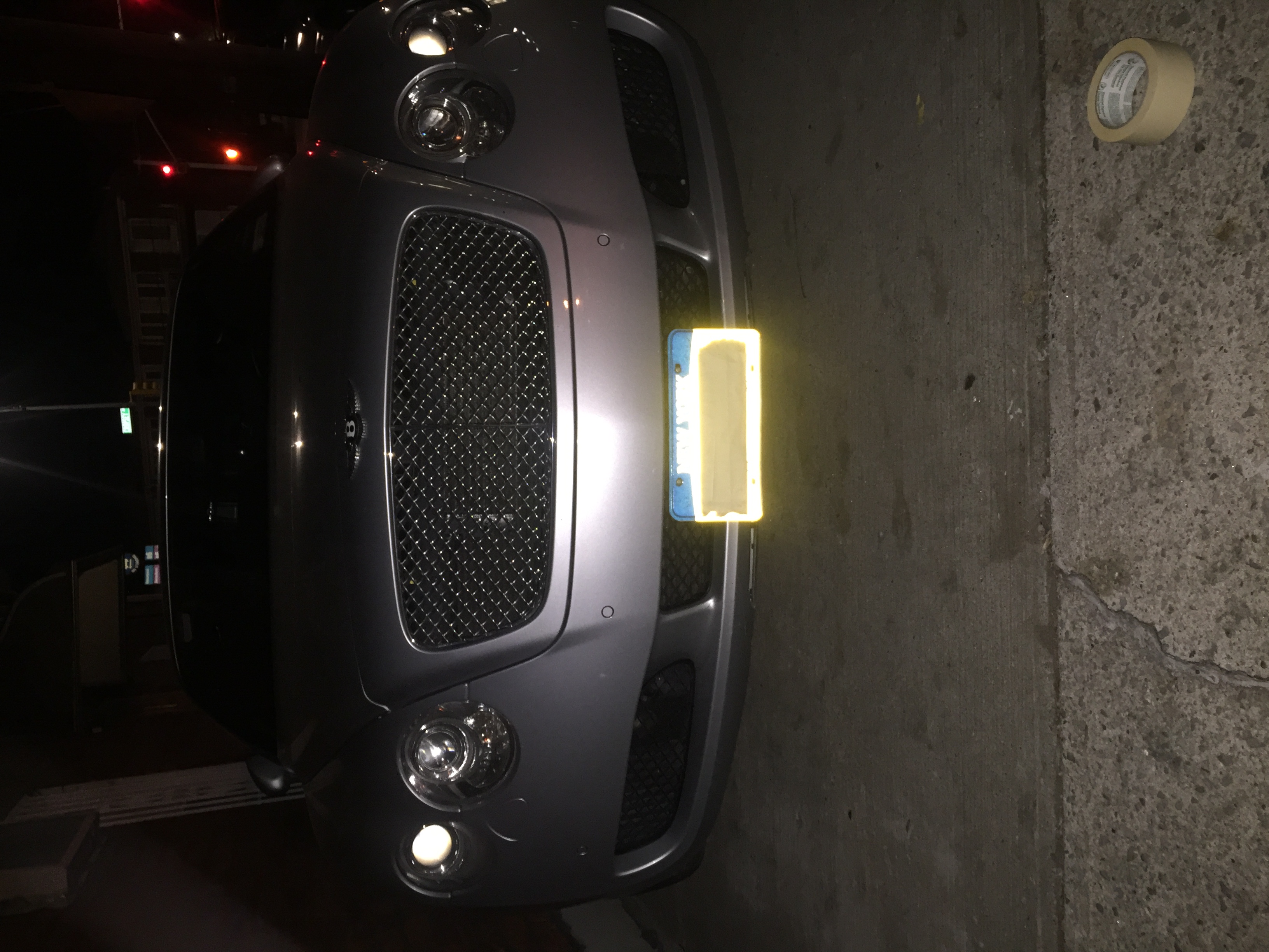

This is exactly how I have mine mounted. Did everything myself. Get my 05gt to 150 mph quiet often and plate never got loose.
