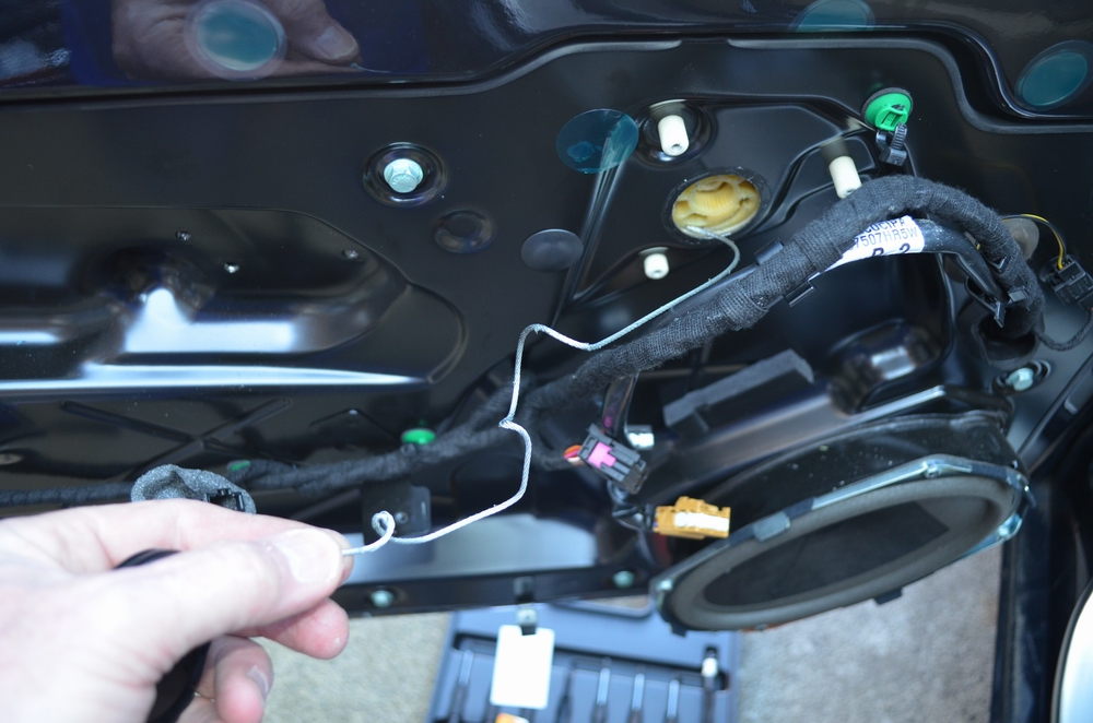

My passenger side front window regulator went with a loud crunching on the way back through France to Eurotunnel. A similar event to yours in the plastic wheel cracked, the spring tensioner also broke and the wire tied itself in a knot:
It really is a dreadful design for such a heavy door glass. The cruciform metal arms used by many other manufacturers would be a more robust solution.
