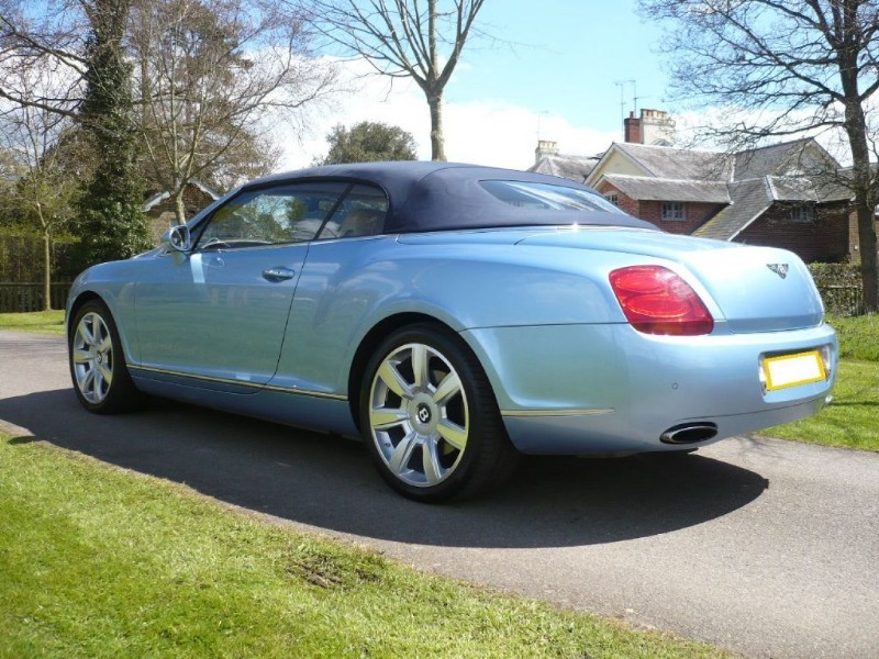

I went to look at a lovely GTC all looked great 2007 car with 42k miles but on the test drive I sensed a very slight misfire :-( the trader said It was fine and I was wrong .... but after driving a couple of silky smooth cars this did have a slightly unsmooth acceleration , although tickover seemed fine is this just a plug or coil pack or could it be a more expensive problem ?

Without a reader it could be a variety of things, some more expensive than others. There was a bad batch of coils LONG ago yet that should have been changed during the 4yr service. It could be the dreaded false air, which is engine out and $4000 to fix.
Be VERY cautious here.
If your heart is really set on that car, take it to the Bentley dealer and tell him what the problem seems to be and find out what code(s) they are seeing and how the turbo air lines are. While it is at the dealers, have them check the bushings, the air shocks, etc too.
