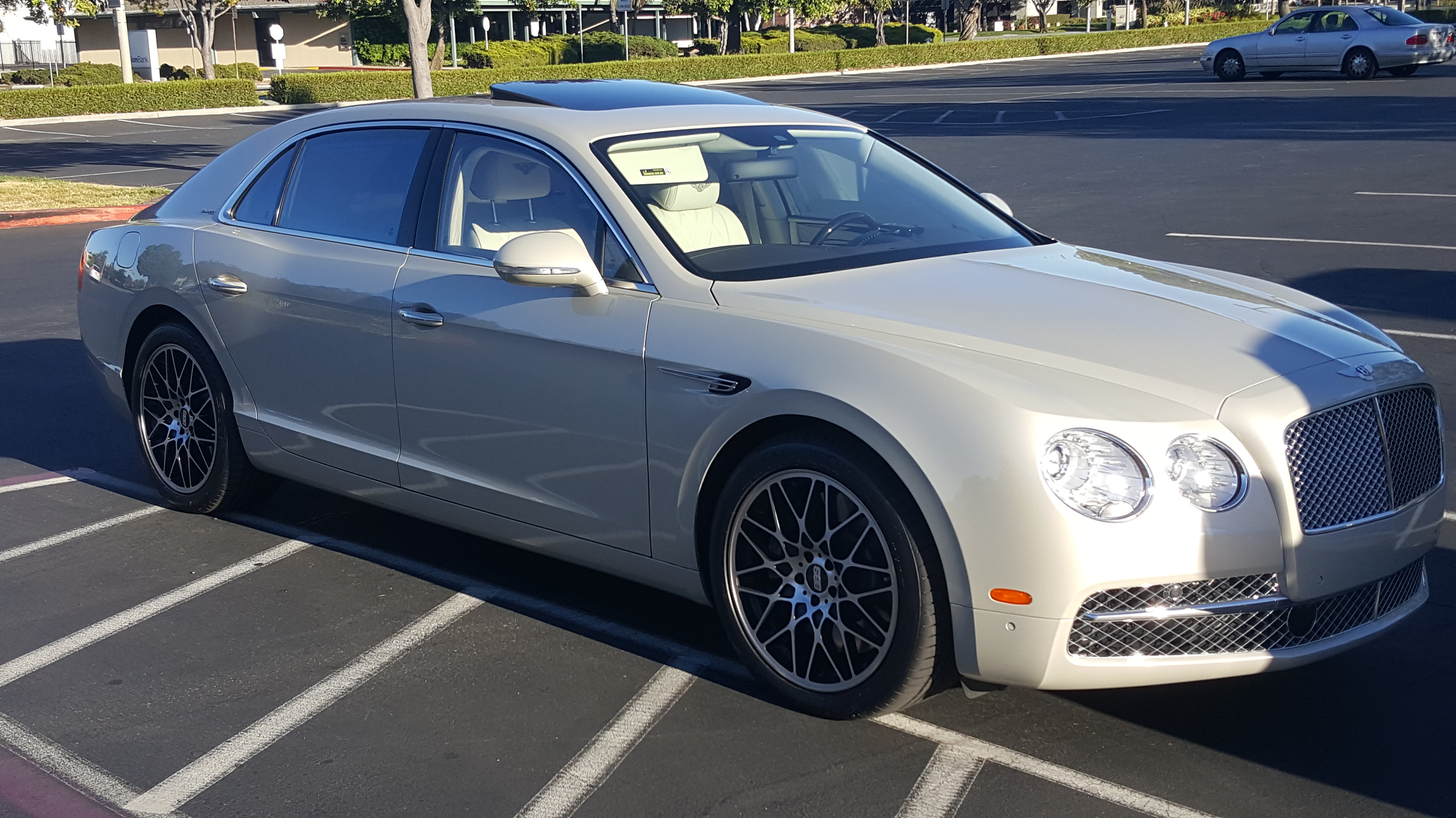

Hello everyone, I always feel my 2015 FS 21" OEM wheels was too heavy, compare to my BMW F01's Msport wheels which about 28lb each, so I bought a set of RXR 20" wheels, like the lighter feel, but was told the RXR's load index is 720kg(1584lb) each, should I worry about the front end weight of FS W12? thanks in advance.

Hopefully the OP is still around the forums to shed some light on the fitment as BBS doesn't officially offer the RXR for the 2015 Bentley Flying Spur so he must have used a wheel fitment from a different vehicle. Telling from the one photo the widths appear to be too narrow & the offsets should also be lower to push the wheels out more.
The 21" vs 22" debate really comes down to what you think looks better. Since these have air suspension you can hardly feel the ride quality difference between those two wheel diameters.
