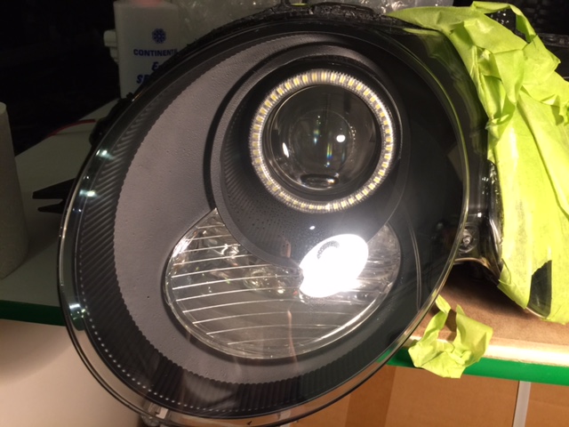

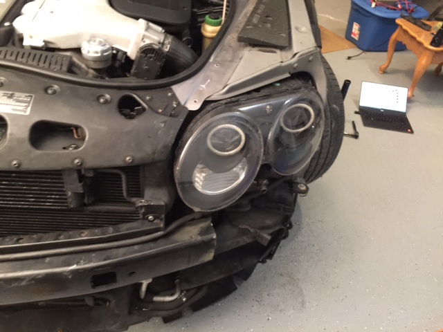

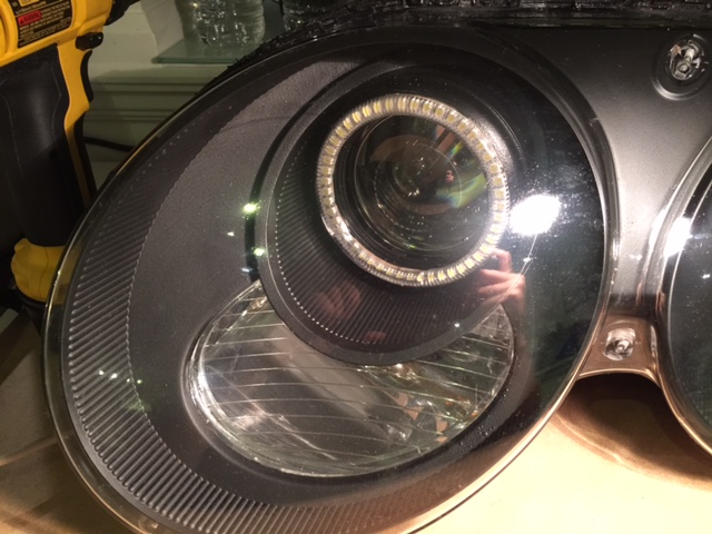

My headlight had some rock chips so I decided to refinish it. I took the headlight off but it is not necessary. It is easier to do it on the car as long as the front bumper and fender is off like this:
Before:

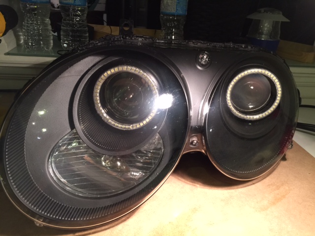

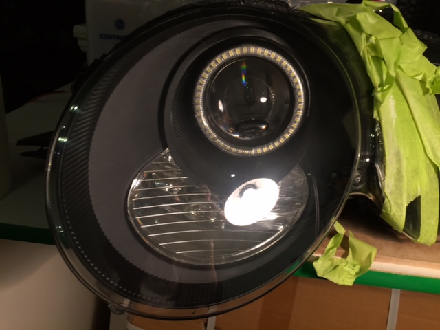

After:

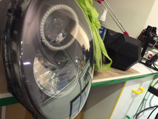

I used a combination of 3M restoration kit, sandpaper, Dual action buffer, and Meguire Ultimate Compound and Polish. The first headlight took forever because I was OCD about getting every sandmark off and wasn't using my DA buffer. I was inspecting the headlight from 3 inches. The second headlight was much faster (2hrs) as I was satisfied with the result from 12 inches away.
Once you sanded off the clear coat, the headlight will be scratched easily and can be UV damaged. As result, I installed a 3M Scortchguard clear protection film. You need 36 inches by 12 inches of clear film to cover two headlights.
