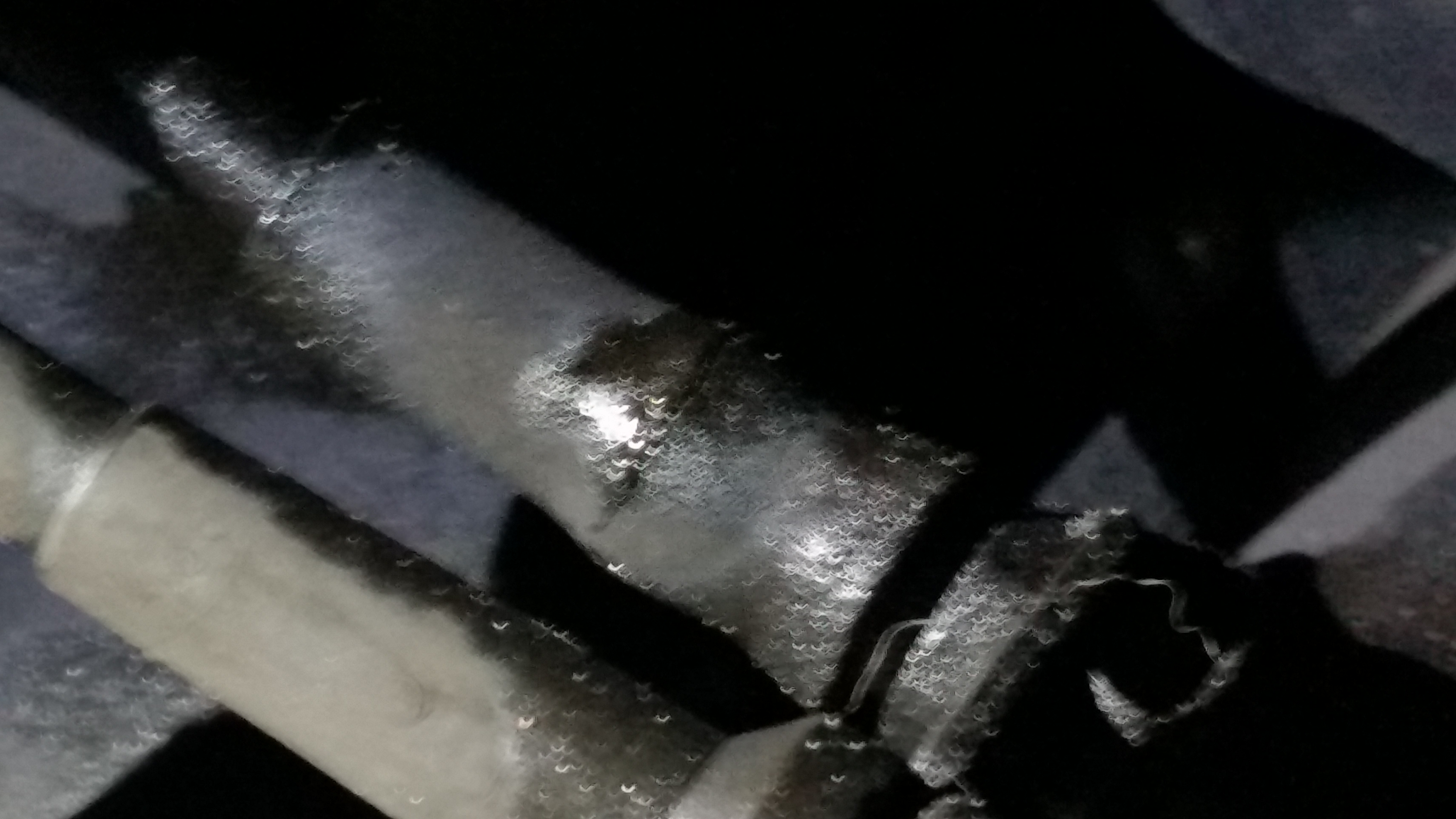

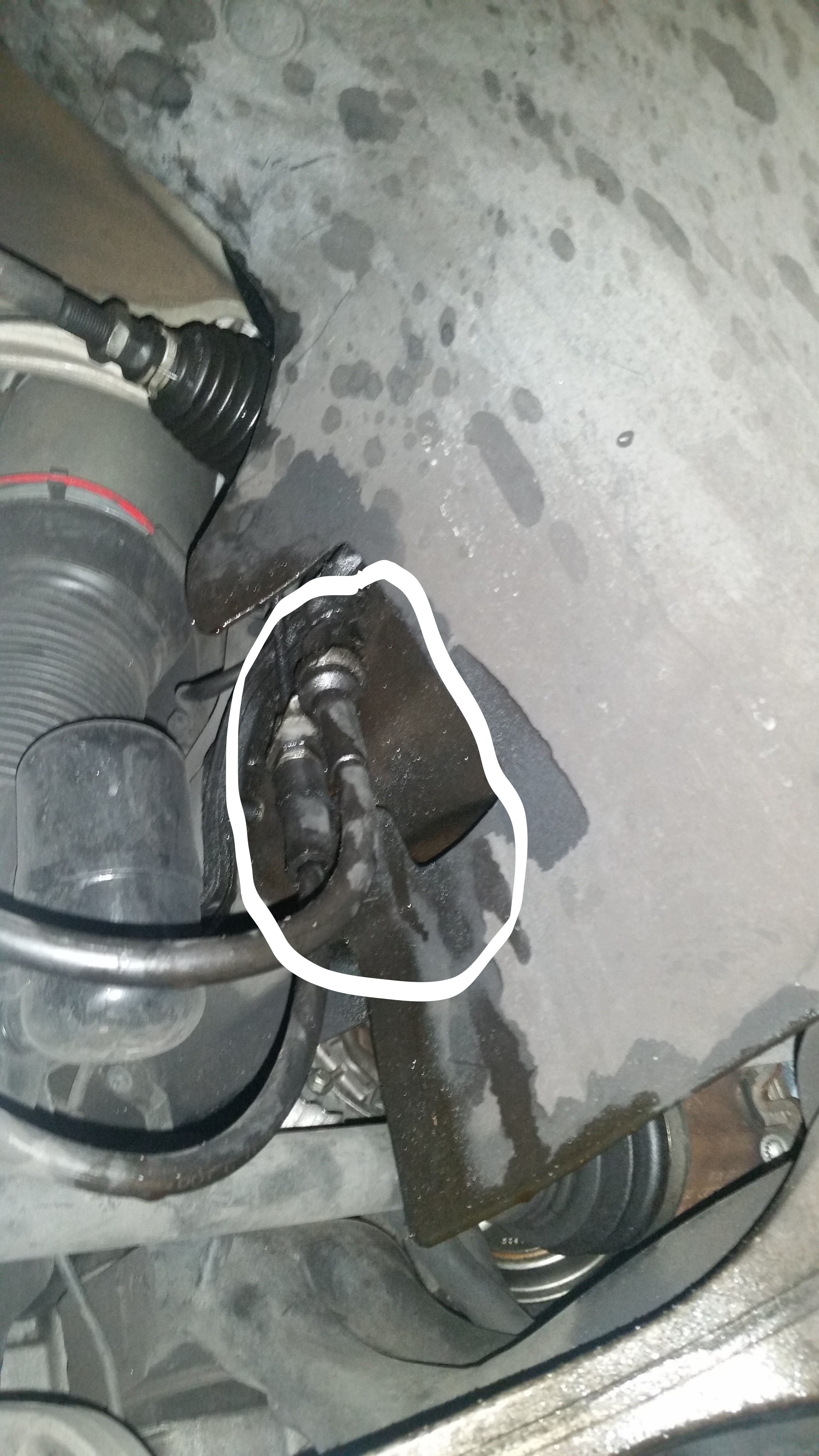

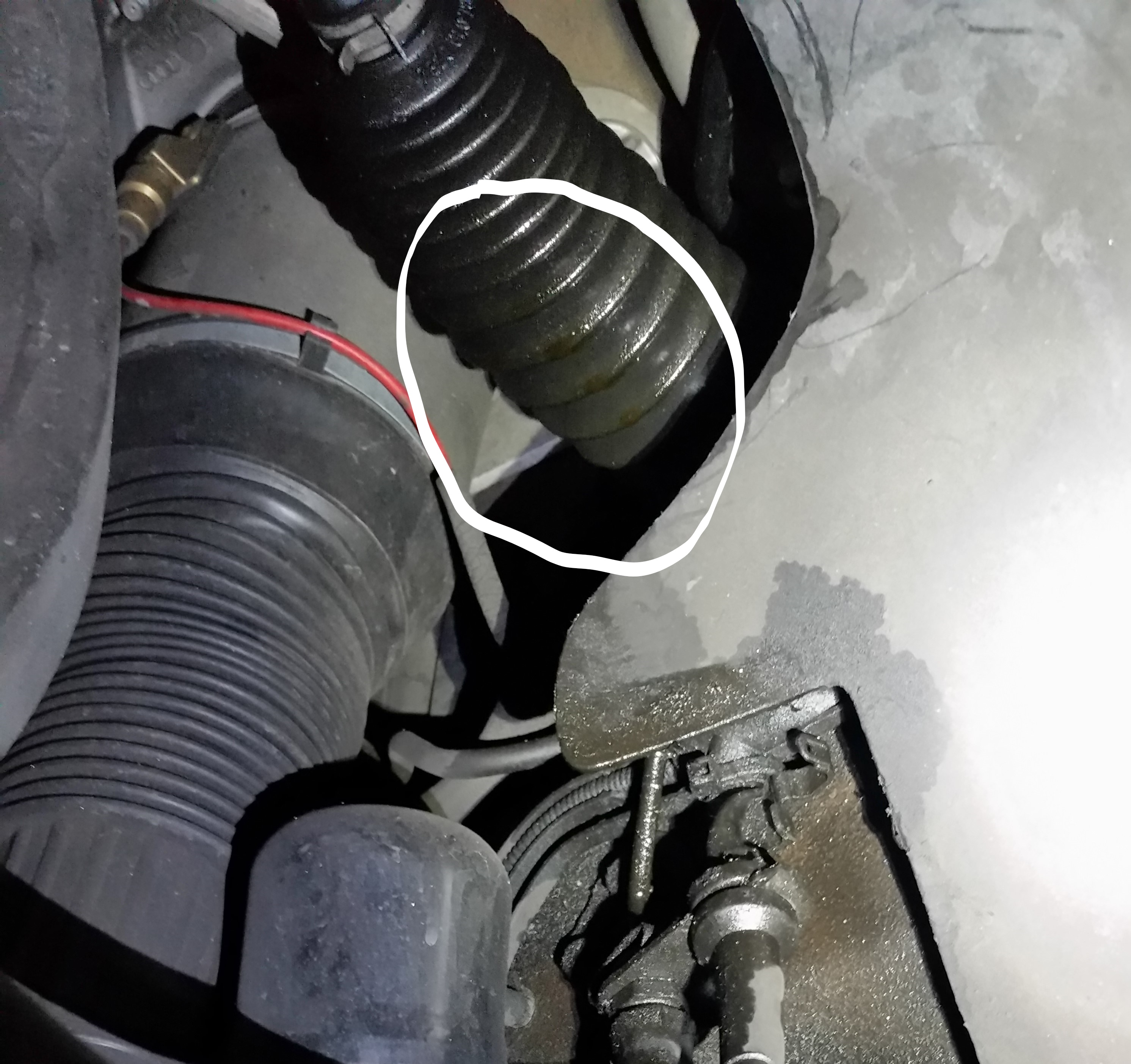

My 05 GTC has been leaking for a few weeks and it appears it might be steering, but not sure. How big of a job is? also it might be hose connectors. Any ideas would be healpful. Thanks

It will take you 6 hours to drop off this steering rack.
it is pain in the neck then sent it to someone can rebuild it.
I heard the Seal kit is the same as Audi A8

My 2008 GTC is suffering the same problem (sigh!).
I'm wondering if there's any chance of replacing the (?) failed seal(?) in-frame/ without yarding out the rack & pinion unit? It's a long shot, but I thought it couldn't hurt to ask.
My leak is on the passenger side.
