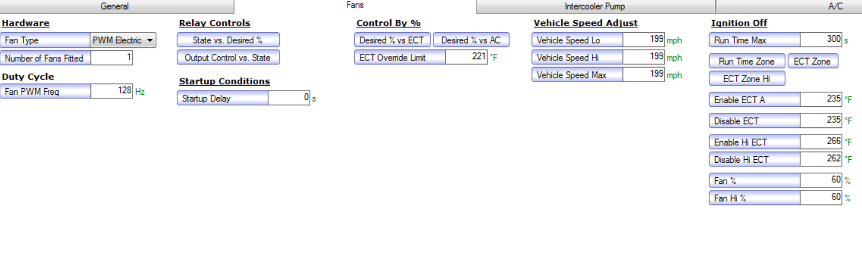

Sounds like normal engine coolant fans "run on" after engine shutdown. The fan motor sounds a little loud, maybe bearings starting to go, but can't really say just through a youtube video.
ALL modern engine management systems program in a fan run on time/ECT/Fan %. These are variable tables and can be modified from factory settings if you can get into the tune files. BUT, entirely not necessary either. Here is a typical tune file with fan settings.
Look at the far right side column. In this particular EMS, the fans can run a total of 300 seconds MAX. The time and speeds the fan actually runs depends on tables the ECU selects from titled "Run Time Zone", "ECT Zone" and "ECT Zone Hi". Also note from the selection boxes, "Enable/Disable" engine coolant temps plus what would be considered a Hi ECT , along with max fan speeds are all variables. In this EMS, and BC of the very high amperage fans draw (40 amps @100% on this car) the max fans speed is limited to 60%
