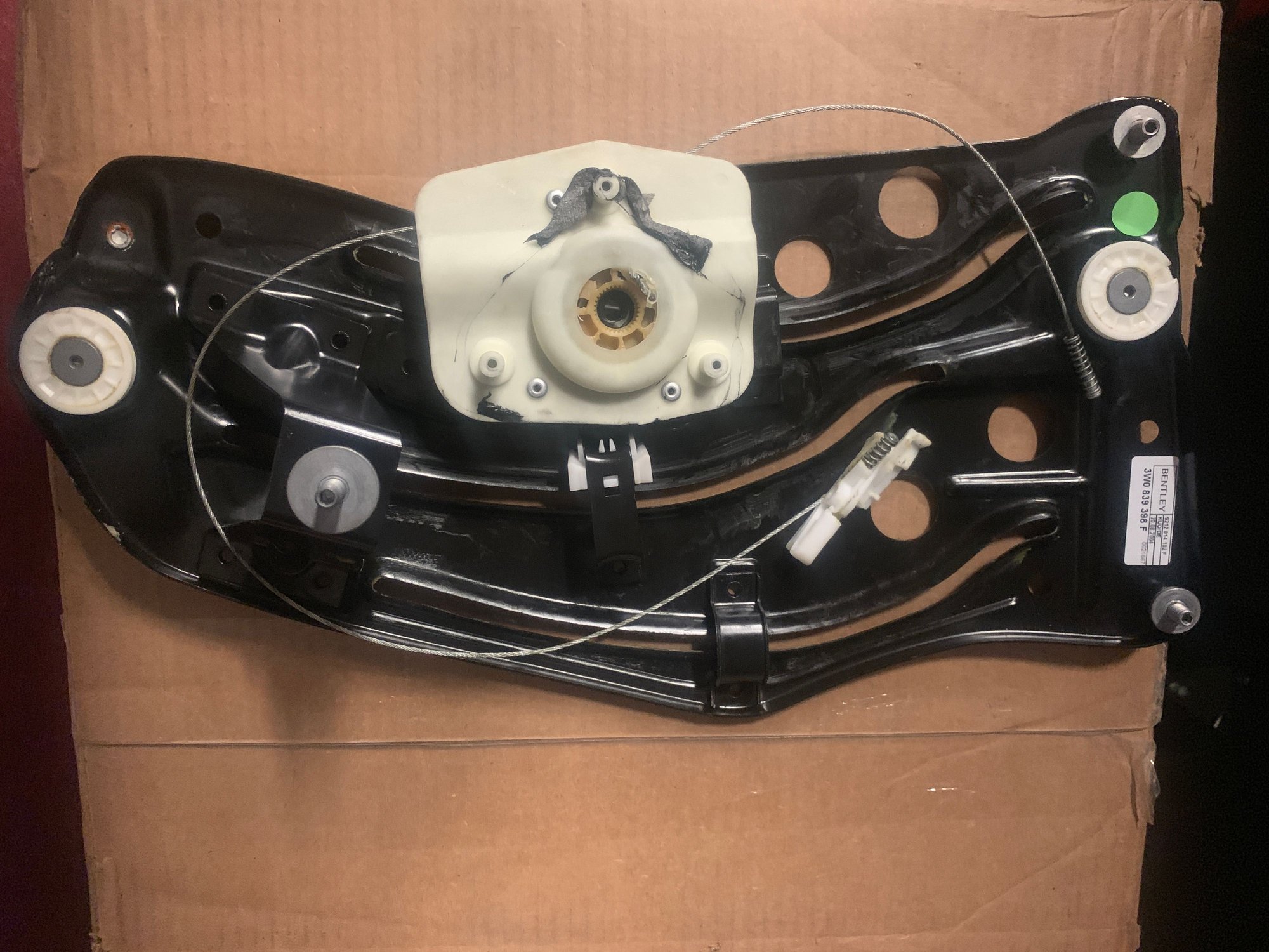

The good news is that I believe most of the cuts I sustained should heal without stitches. Be careful back there as a few pieces could double as razors, it would seem. I took the window glass off the regulator and left the glass inside the car as I saw no need to remove it. As for the repair versus replace, I am providing two pictures. The first will be the regulator out of my car. The second is the repair kit available on eBay. Unless the eBay listing is just a file photo I cannot possibly see how the two are the same. Also, if I repair, it looks like some items would have to be drilled out. Is that incorrect? I would love to hear from someone way more intelligent than myself. Thanks!

That is the correct kit. This is not an intuitive part. I've installed two units using the exact vendor. Since you've gone this far keep going. Become familiar with unit. On Bay look at used unit photographs.
I noticed one white nylon slider on top that looks good. There should be another one on the lower side. If this nylon piece is missing, can try to help you make a new one. The missing sliders cause the window to bind and then break the cable. There are two of these on the regulator. Also the guide wheel becomes convoluted and worn causing derailment. The replacement kit's guide wheel is a stronger material.
The two cables are shock absorbed by the springs in the little flat part. The cables wrap around the guide wheel in a specific order and the ends are tucked in the wheel. The regulator motor spools in either direction to open and close the window.

The two cables are shock absorbed by the springs in the little flat part. The cables wrap around the guide wheel in a specific order and the ends are tucked in the wheeel. The regulator motor spools in either direction to open and close the window.
Here's a good snapshot from eBay.Bentley GTC Right Rear Window Regulator Without Glass 3W7839398B for sale online | eBay https://www.ebay.com/p/Bentley-GTC-R...98647388&rt=nc

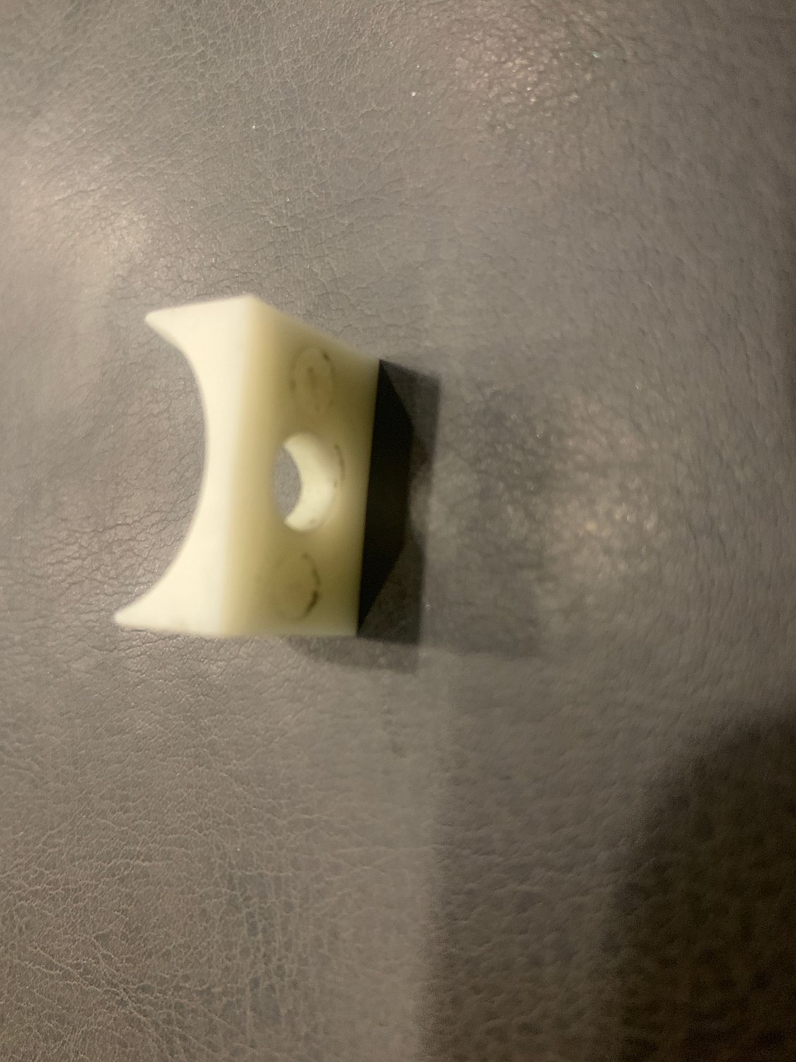

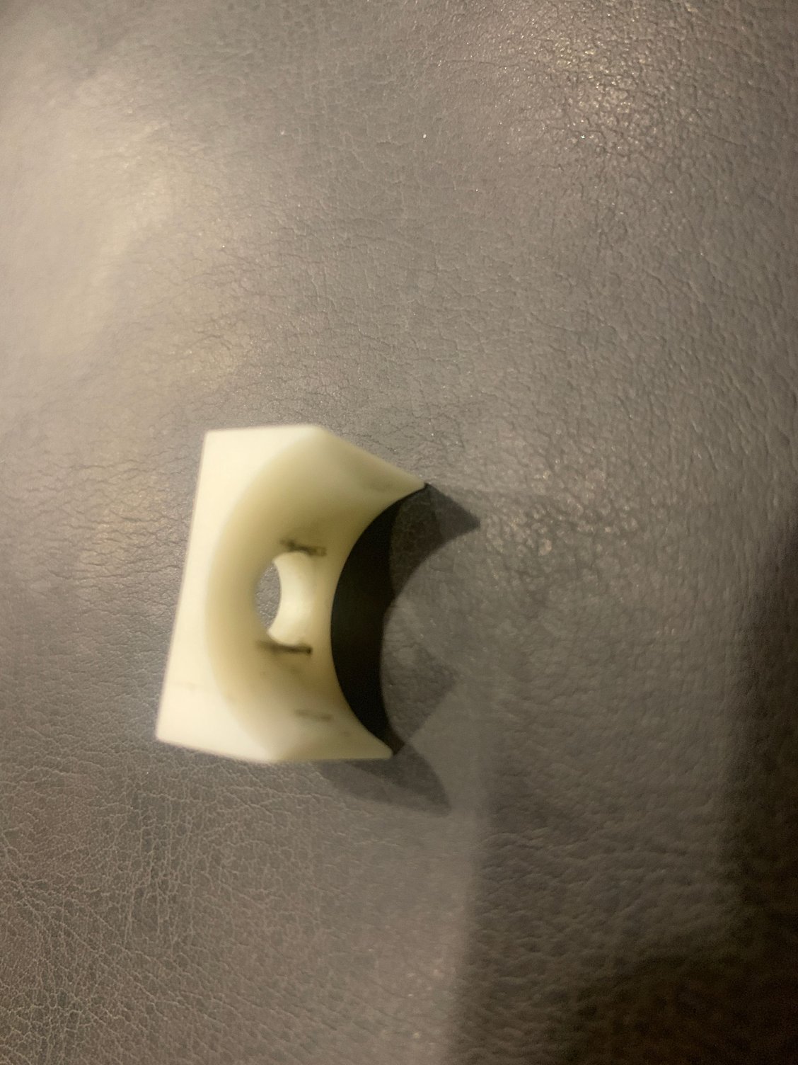

Okay, so the regulator is rebuilt and I believe will work fine. I started to put everything back together and found three of the pictured pieces, along with three silver washers down in the bottom of the opening. I don’t remember seeing these when taking the car apart so they must be from somewhere behind. Any help is appreciated. I feel like I’m close and I just want my car back...🙁

The pictures I see are the nylon sliders I'm speaking about. They fall off. The washers are either part of the fastening of the sliders to your regulator or they are spacers for the glass to the regulator unit. Unfortunately it's been awhile since I had mine apart. There were miscellaneous bits that I found as well.
Post a photograph of those fasteners that might jog my or someone's memory.

More than likely the cable broke because the sliders fell off. Use Loctite so that doesn't happen again.😉
