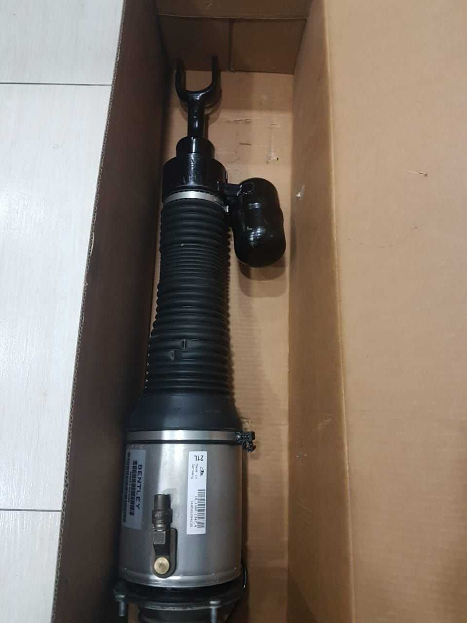

hi, I’ve also replaced my passenger front air suspension as well.
It seems like the air suspension on the front sags if left for few days.
But when i unlock the car, it comes back up without any air compressor input. I put my ear by both suspension and can’t seem to hear any hissing leaking sounds. Maybe it’s by design? My ride height setting is on the lowest level.
