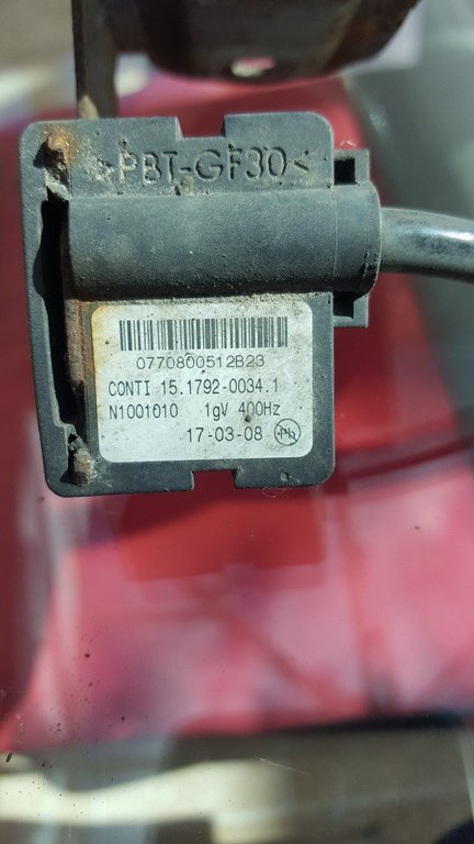

Got the sensor out.
Look at the state of the potting compound:
Just wondering if a Pheaton one will work. Same part number but has a G suffix instead of K on this one. Lots on ebay for a fraction of new price.

Put a 'new' sensor on from a Phaeton. Seems ok so far. No codes. Cost £12 including postage, instead of £170...
