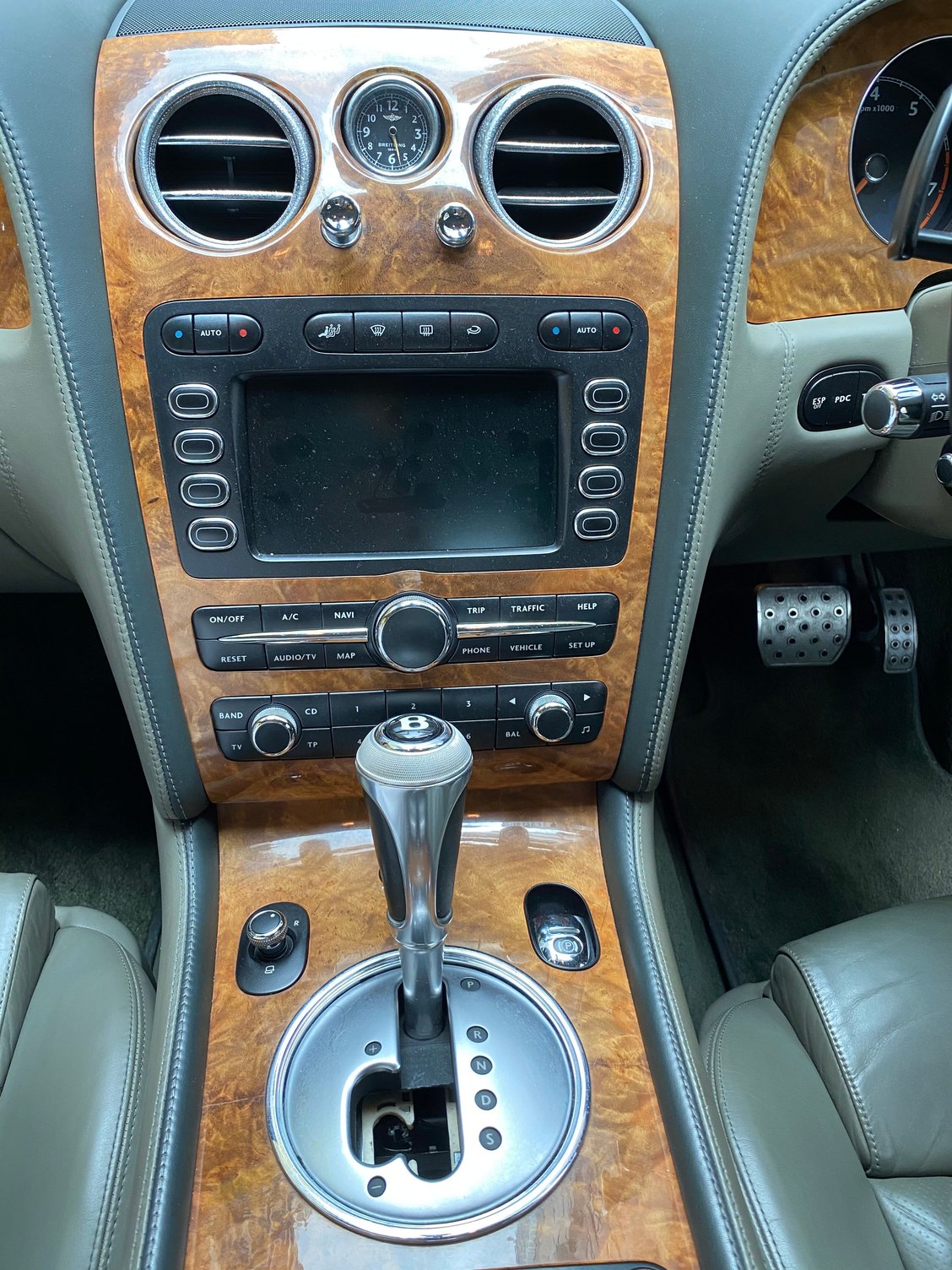

Below are photos of the car I have bought, as of yesterday (the covering below the gear stick has been replaced since then).

That is a GORGEOUS car, you did good. Beautiful paint color.
You do want to upgrade the infotainment. I disagree with "leave it like Bentley intended", Bentley themselves didn't like that infotainment and got burned on it. It has a bad/old screen and is just…old and bad. I don't know, I hated it. I liked everything else about the car, but that infotainment was terrible. When I researched prior to purchasing, I found that to be the most common complaint. So get rid of it.
The prices you were quoted seem too low, unless I am doing the conversion wrong. My speakers, without install, were bought from Britain for 1,000 pounds. Are they just selling you two speakers?
I don't know about the Chinese replacement thing, but for my radio, there was an aux input for the backup camera, they mounted it as I said earlier, in my license plate. Since some of these came with that as an option, you might find a connection on the current infotainment, someone else would know.
Here is my advice:
1. Get rid of the old infotainment
2. Use the Chinese replacement (I don't know enough, if you can look at one, that would be best) or Ben Hur
3. see if they can get a subwoofer installed somewhere. I have a pass-through to the trunk, but you don't. You may not be able to, but that adds to the sound
4. Upgrade the speakers, but only after you put a new infotainment system in. I never knew if it was the infotainment or my speakers that sounded so terrible. Guys on here say it's the speakers, others say the speakers are fine, it's the infotainment. I changed it all out at once, so I'll never know if it was one, the other or a combination. There is a set of French speakers that folks like, they're some the best, but it's probably marketing. They sell them in sets, you need 10 speakers, two boxes. I don't like the tweeters.
Here are the Focals on US Amazon, you can certainly find them cheaper where you are:
Amazon Amazon
TeamJones also bought these after I did, I don't know if he has installed them yet, he will have more information.
Anyway, do it now, that's my advice. It's the first thing I did, make an appointment, got an estimate, bought the speakers on my own (US prices are oddly high for components). If you go Ben Hur, you can buy them direct from Britain and escape the VAT, or at least Americans can.
most important: Get a hard mount for your phone, it makes ALL the difference. I really mean it…get the mount.
I had them also put an HDMI connector and a USB connector in the ashtray, that's useful, I don't know if the Chinese thing has an HDMI input or extra aux USB, my Alpine does.
