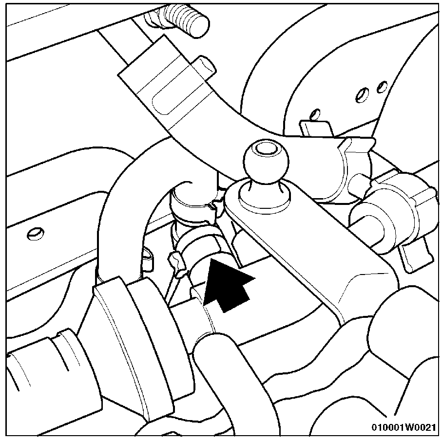

I have a question regarding testing @Johnny Hotspur GT
The Youtube videos say plug the turbos with tennis *****, but is it easier to disconnect and plug the vacuum system from the engine as per the service manual? Looks to me like this way, I don't have to remove the airboxes.

Hello @silvertonesx24 ,
I am guessing that illustration you posted is of the vacuum circuit under the B cover at the rear of the intake manifold, as my video above is about the routing of the vacuum lines at firewall, and the Leak Testing video is Jason Giannetti's, and therefore I personally have never tested for vacuum leaks, I am only doing preventative work on my rebuild, I can not answer your question.
What I will add though, I think I would rather pull the air boxes instead of risking breaking or cracking any of the plastic vacuum fittings under the "B" cover.
