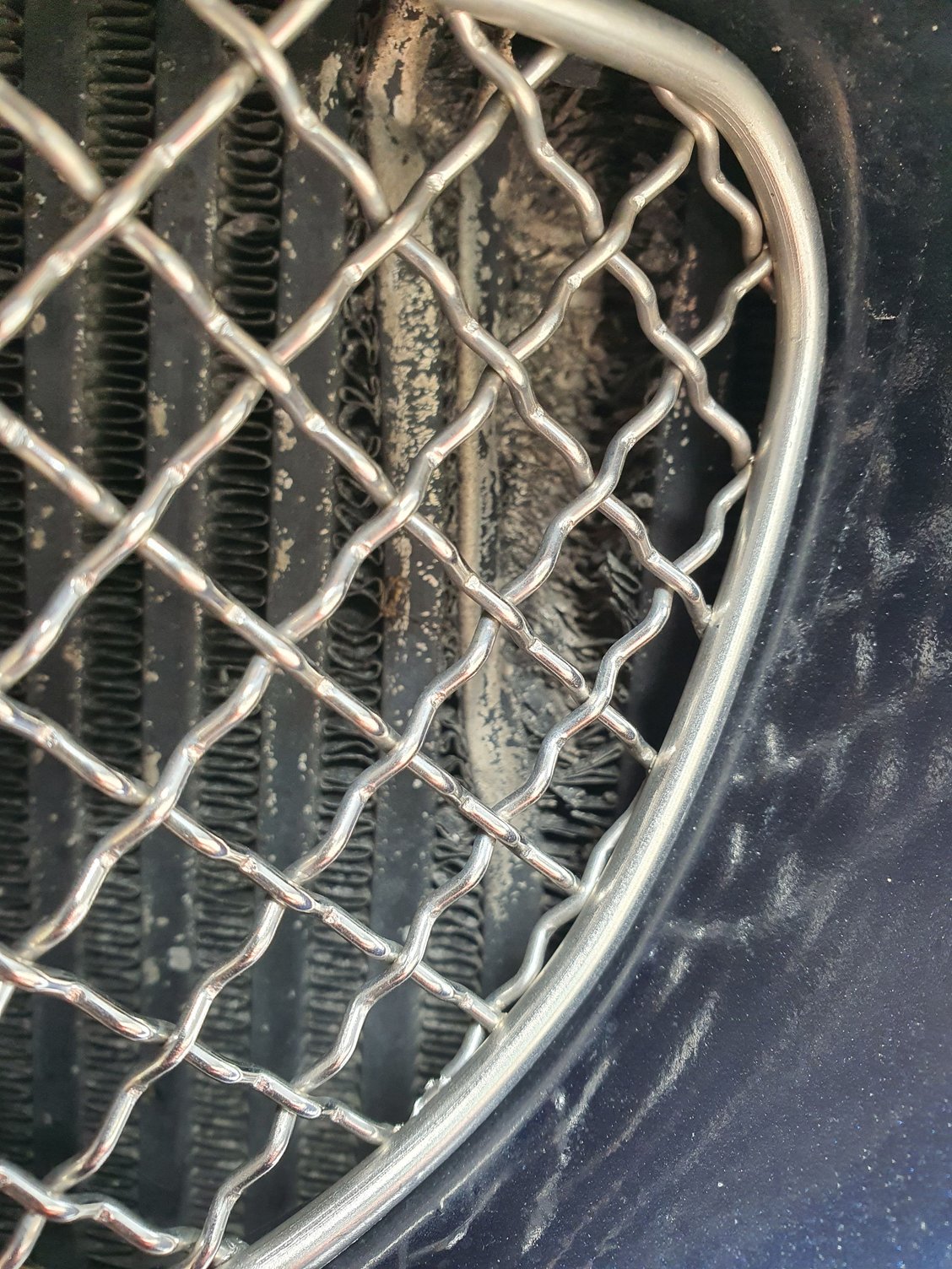

Here's a photo I took of intercooler (what I can see of it through the grille anyway) it definitely doesn't look to be in the best of shape so will definitely have it replaced.

TBH its looks more flattend than split. But a proper inspection and test is a must.
