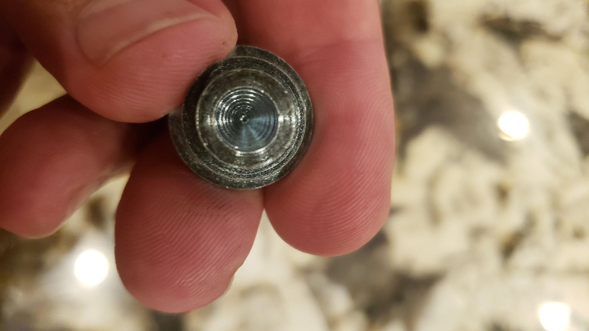

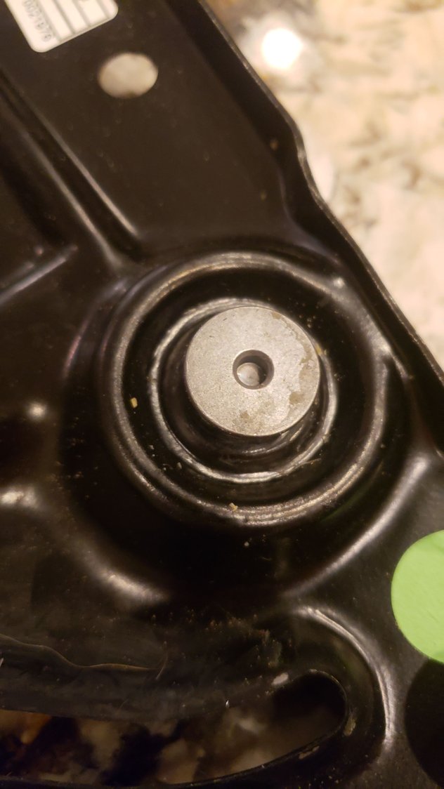

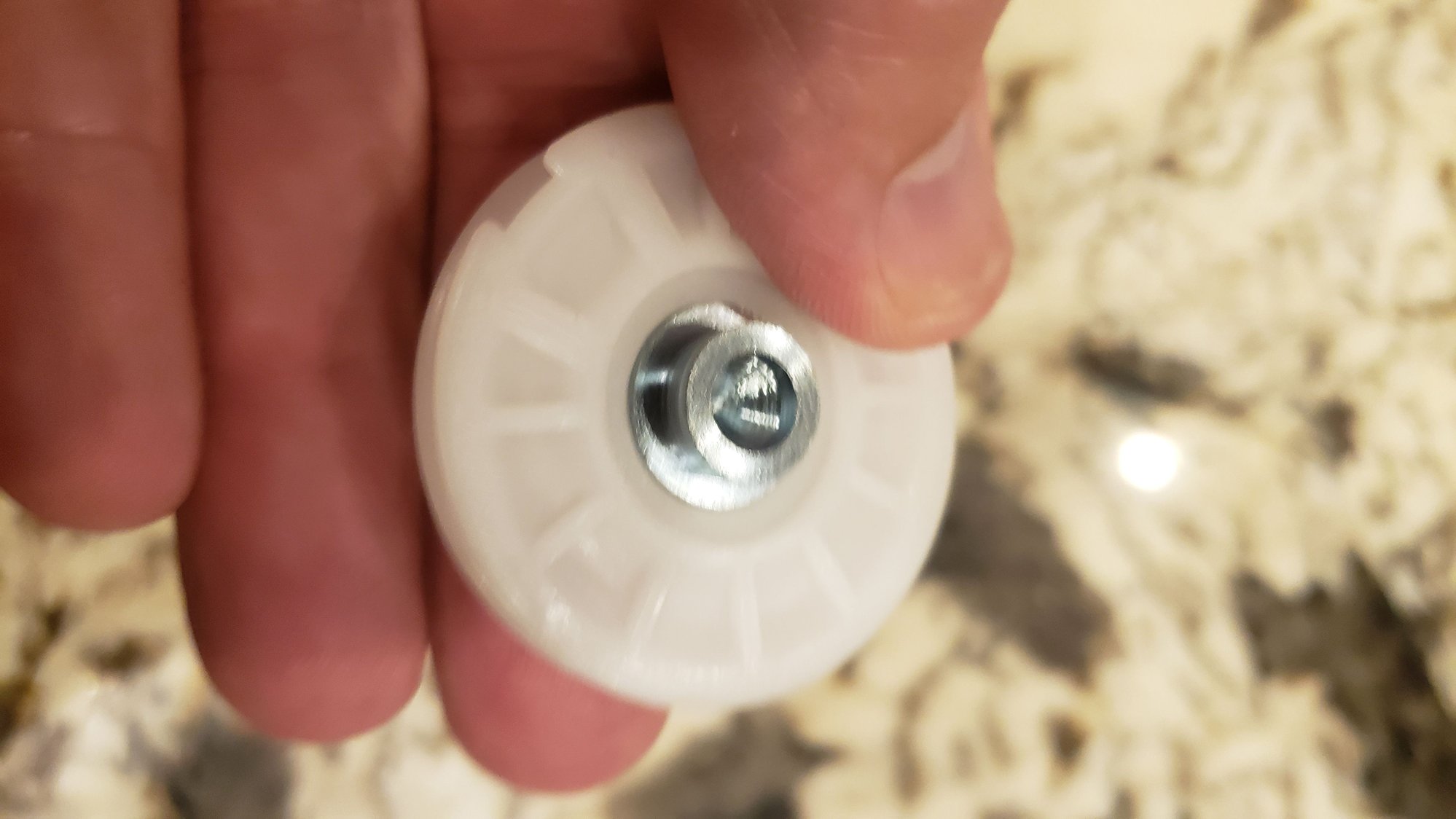

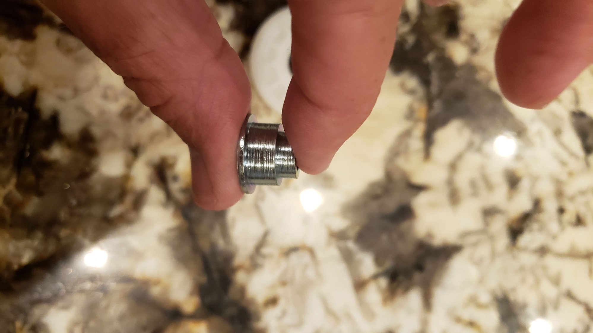

I bought a kit to rebuild the window regulator but I can't figure out how to get the pulley out. I put some pictures of the metal part left of the pulley that's still in the regulator for reference. I need to get that metal piece out. The kit came with the pulley and the metal center piece but no back part. I assume I need to reuse the one already on there so I don't want to drill it out.

Just in time for Autumn I've got a poorly front window regulator on my 04 gt. On mine the white plastic wheel has disintegrated leaving the metal hub as per your picture. The metal hub appears to be swaged in to the regulator, I was going to grind it off and swage in the new one. Where did you get your new wheel from? My 'repair kit' didn't come with one so I am on the lookout for the correct size.

So I managed to get a replacement wheel for my window regulator which also came with a new hub/metal piece. The old one came out pretty easy with a bit of grinding & some taps from chisel. I then mig welded it in place to save messing about making a swage tool. I thought I was on the home straight at this point but I am really struggling to get the regulator wired up again.
