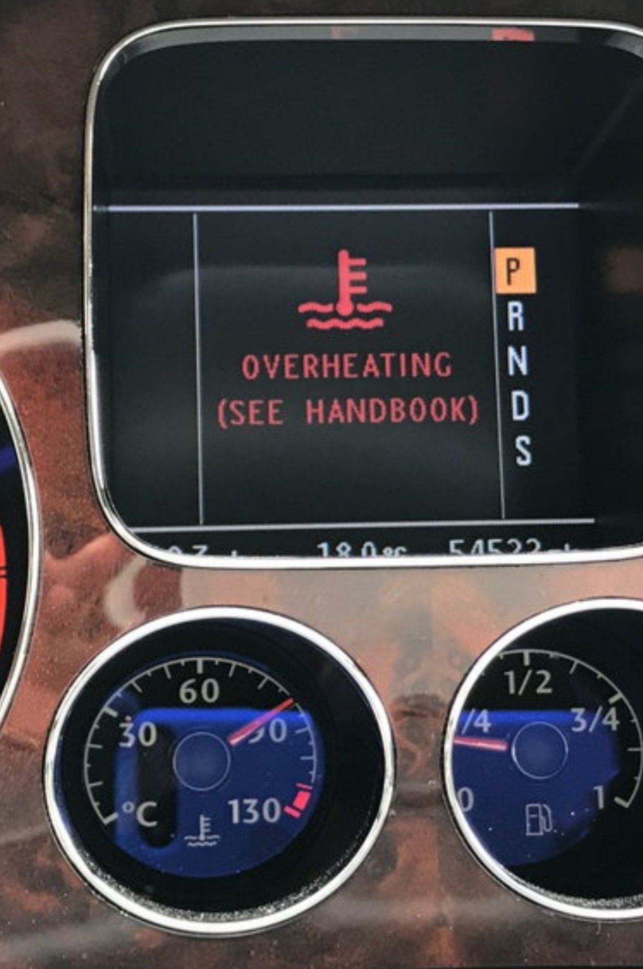

Hello @Niyaz ,
What year is your Flying Spur ?
The 2006 has the electric heating element fitted thermostat, which would have a 100°C / 212°F opening temperature, but the electric heating element opens it faster, part # 07D 121 111 AL, superceded to 07D 121 111 AQ,
sometime in 2007 the engine got the thermostat WITHOUT the electric heating element, and it's temperature is 87°C / 188°F opening, part # 07D 121 111 AR, this AR is the thermostat that was in a 2008 engine I broke down, and is the same that is in my 2011 Supersports engine, and my coolant temperature stays at 202°F, (94.44°C) as shown in my picture.
120°C / 248°F is to hot, even if your local temperature is 33°C / 91°F outside, at 120°C you are in the red zone, SO, you actually have a overheating problem along with the egt P0544 code, as with the egt fault and false warning of overheating, you can see that the actual temperature is still at 90°C as shown in the attached picture.
Can you give us a full scan, do you have Ross-Tech VCDS or VAS 5054 ?
Have you checked for both fans operating, checked the coolant level when cold ?
Johnny
