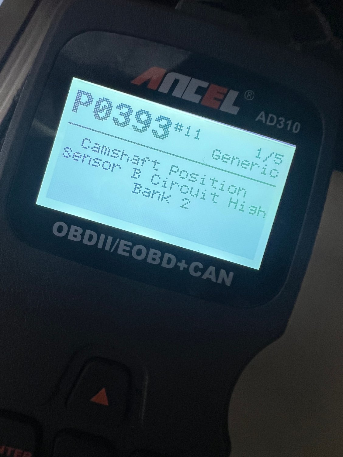

Hello, im getting an engine ck light with error p0393
which is " camshaft position sensor B circuit high input (bank2)
high input correct me if im wrong means back sensor "don't have any performance issues" with light on, what is the best way to replace this sensor?
my understanding is "Bank 2" is driver side, but for "sensor b" is that the inner or outter side of bank 2?
your thoughts? please feel free tell your input best way to fix p0393, thanks

not sure if sensor a and b are correct tho

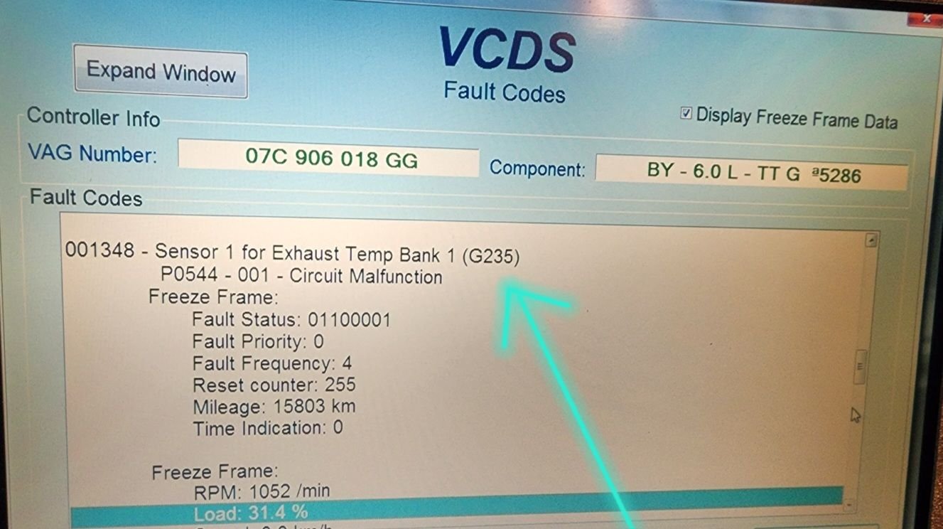

@i.gonzolv ,
Which "G" number does the scan show as the fault ?

@i.gonzolv ,
I just read online where "cam B" is the exhaust cam, so I am thinking sensor "B" would be on cam B, so that is the outer one shown in your picture.
This is why having the proper scan tool is so important, check out Ross-Tech VCDS.
