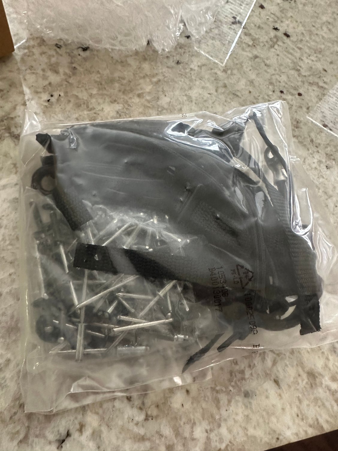

My 2016 never developed the "holes" issue, but I bought the OEM strap retrofit kit from Scuderia just in case. I believe it was around $300. Part # 3W7898025. I ended up giving it to a friend of mine with a 14 GTC who was replacing his top due to the holes.

Thank you, so there is a real retrofit.
I will look into getting that. Seems like it's more than a strap at that price and might explain the $1000 estimate
mentioned in an earlier posting for the strap repair. I'm going to see if the local dealership parts dept knows anything about it.

The tech at my local stealership is very good. He said he thinks there are actually two different repair kits,
but seemed inclined to just look at the straps if I don't have any holes yet. Historically his judgment has been
excellent, so when I need an oil change I'll pay an extortionist price for the dealership to have him also inspect the straps.
The tech has no control over their pricing unfortunately. What they do is look for any and every repair they can find to recommend.
They'll simply charge a lot for the oil change.
No one seems to have the repair kit cited above in stock, but when it was available it seemed to be for GTC thru 2016.
It's got a lot of parts over and above the straps, sort of like a disassembled watch.
