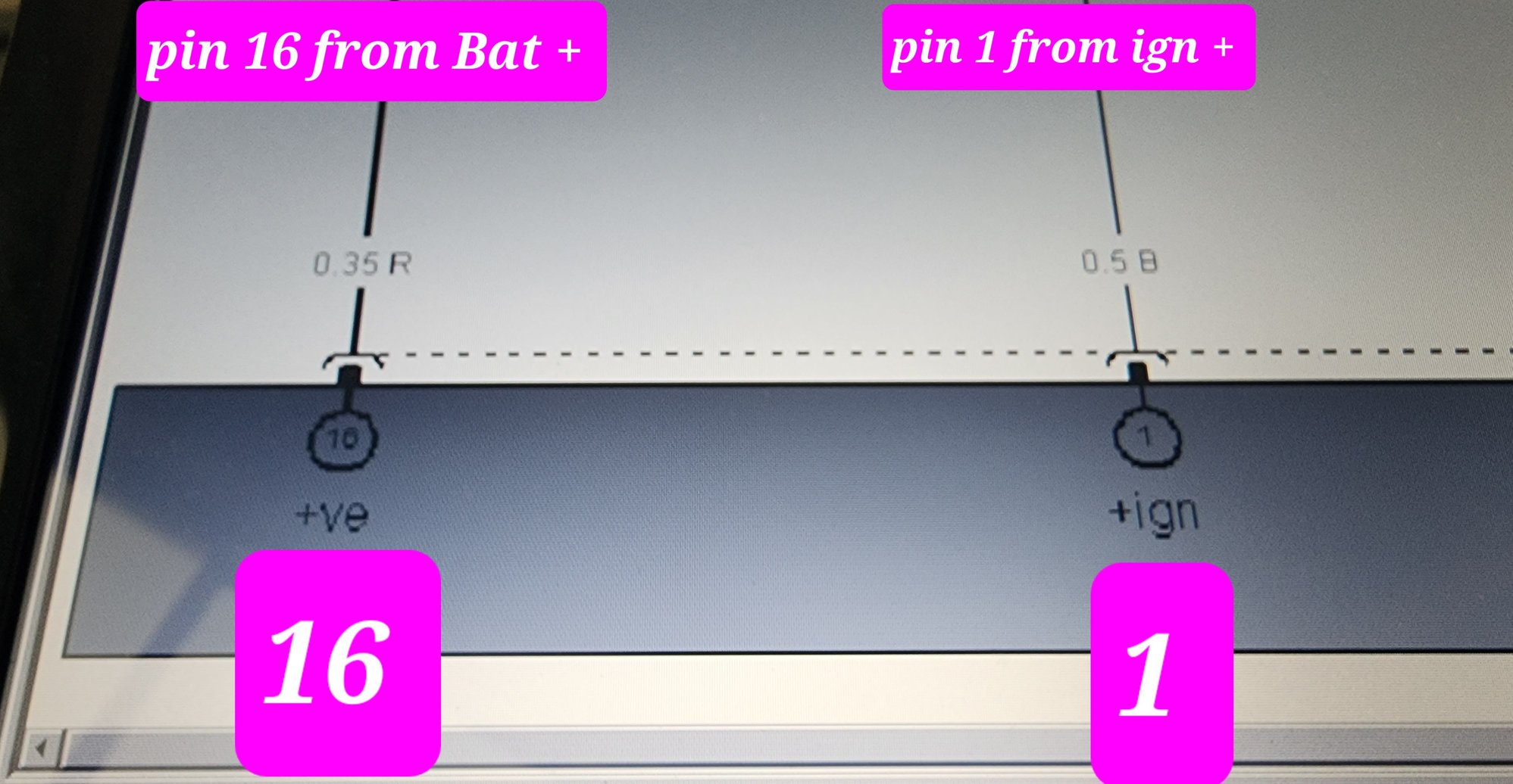

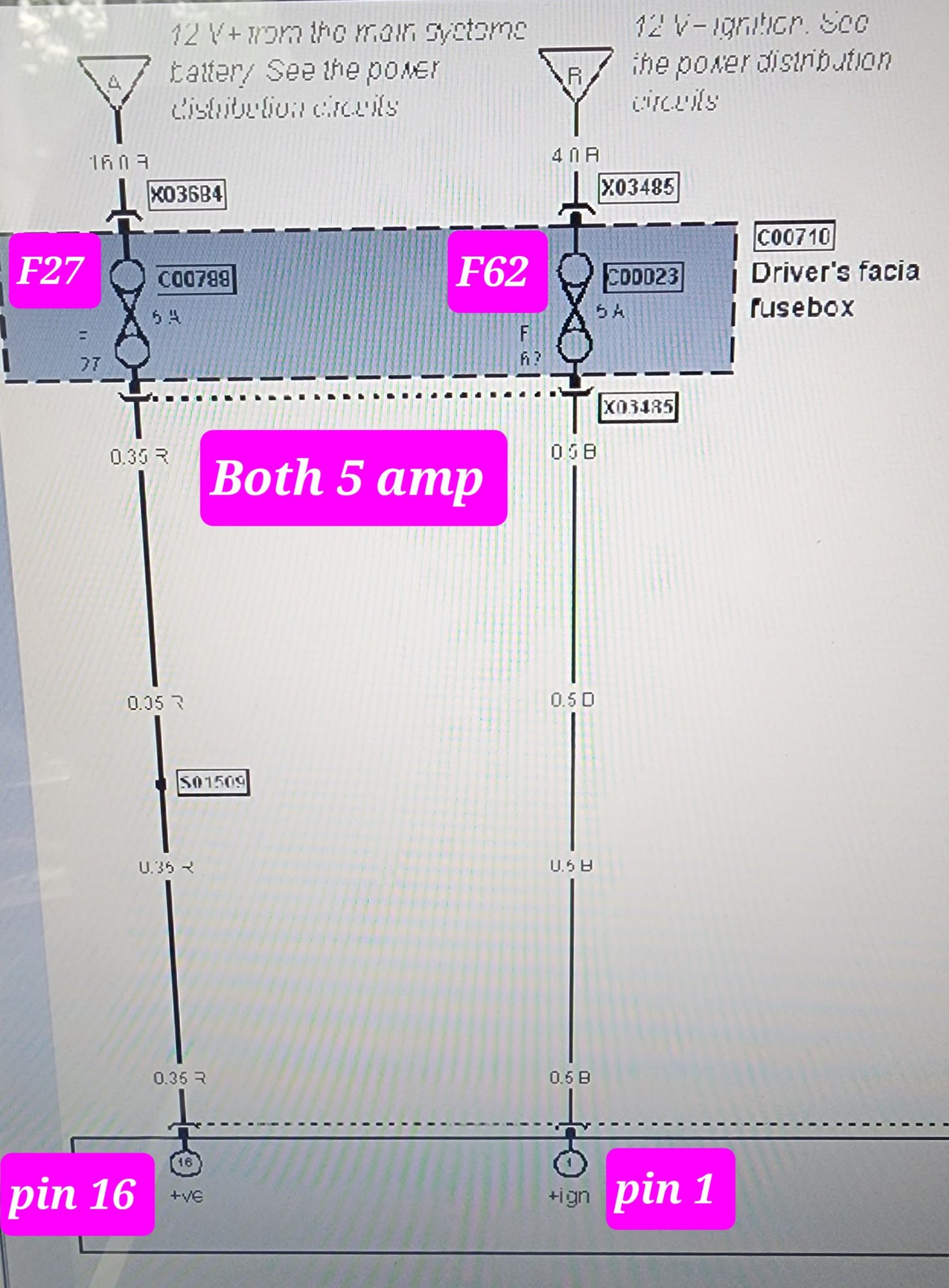

I just learned while looking up the fuse information for you, that the 04-07's only use one fuse in the facia fuse box for the OBD port, that being fuse F-27, this I knew, what I found out was that the 2008 and up, still uses the F-27, but adds the F62 also to feed the 16 pin OBD port, so check both your F27, and the F62.

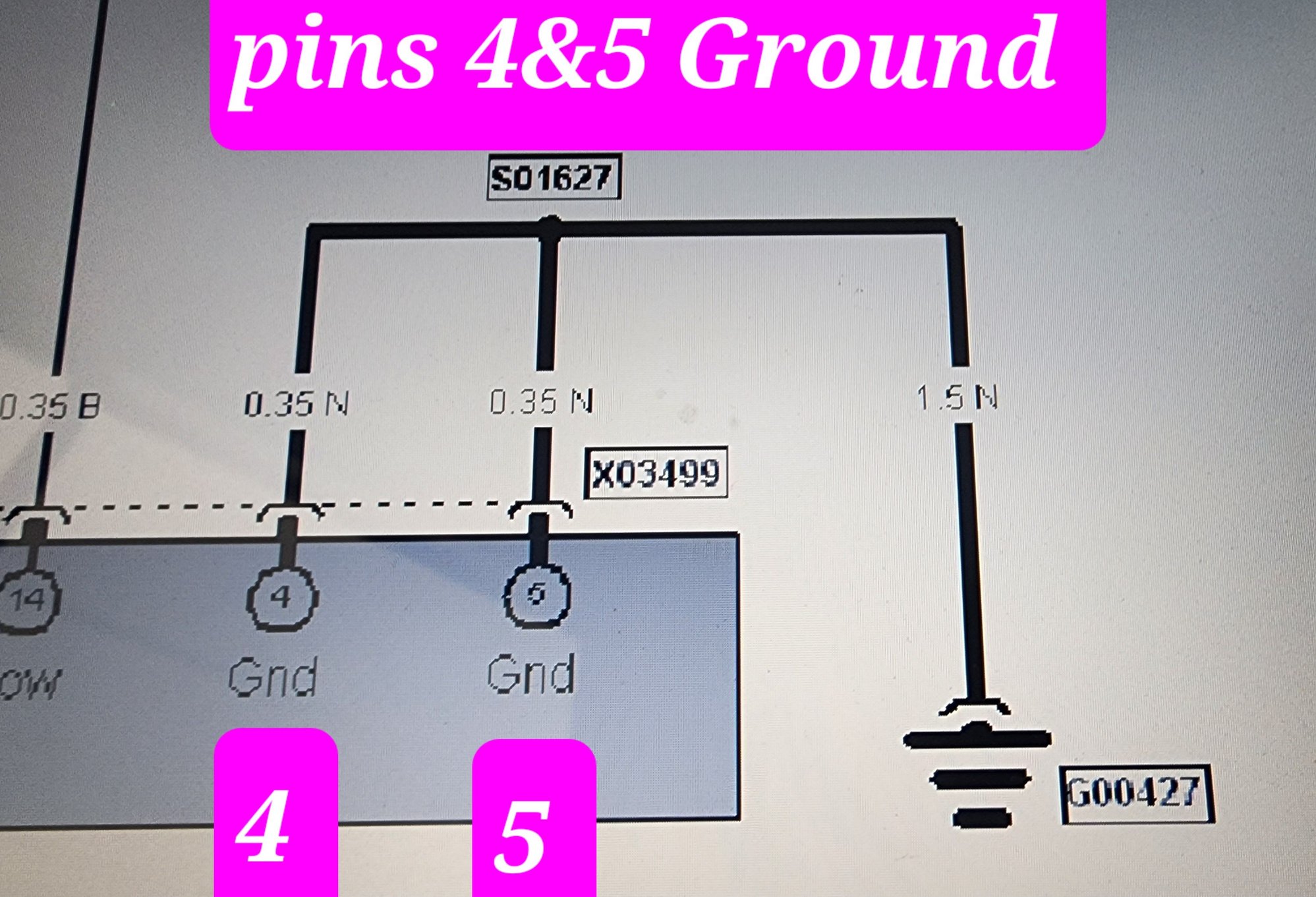

The F27 is constant power from the battery + that feeds pin #16 of the OBD port, the F62 is powered by the ignition + and feeds pin #1 of the OBD port, pins 4 & 5 of the OBD port are grounds, so be sure that your grounds are goods also, as I assume that you are having issues with your diagnostic tool working by lack of + or - pins working.

It was were you said but the fuse position in my car was called C00788 a 5amp fuse.
