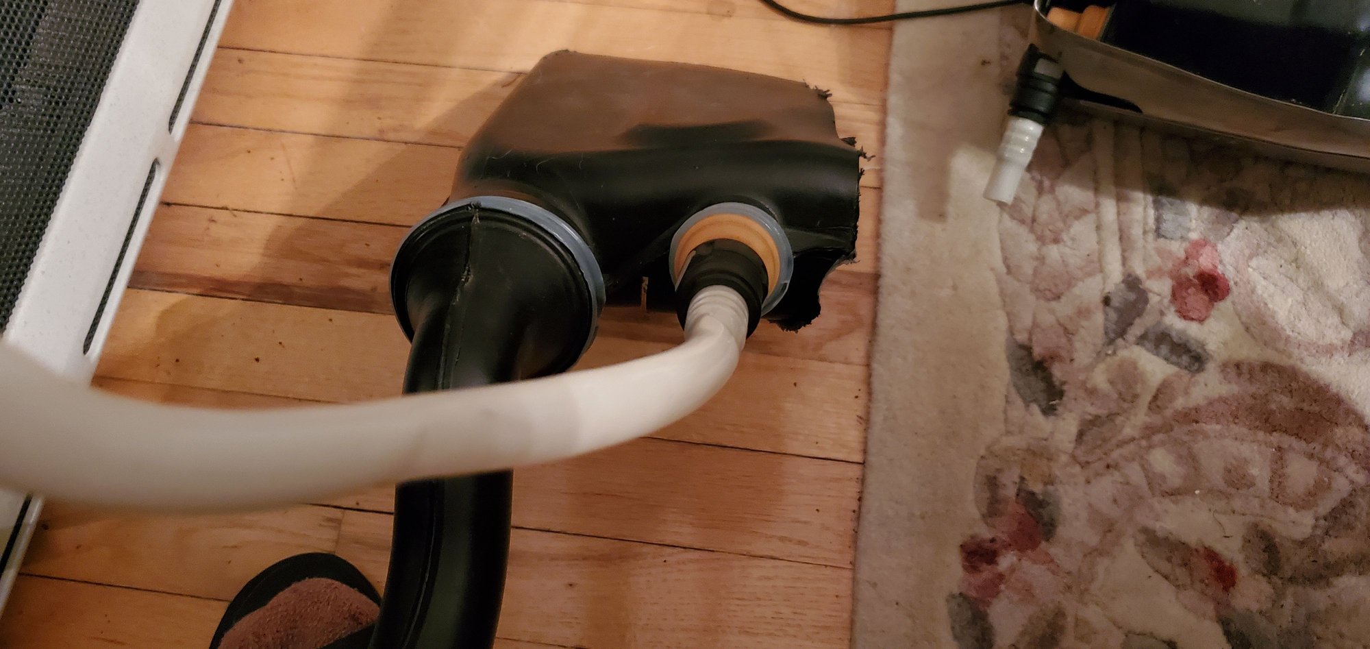

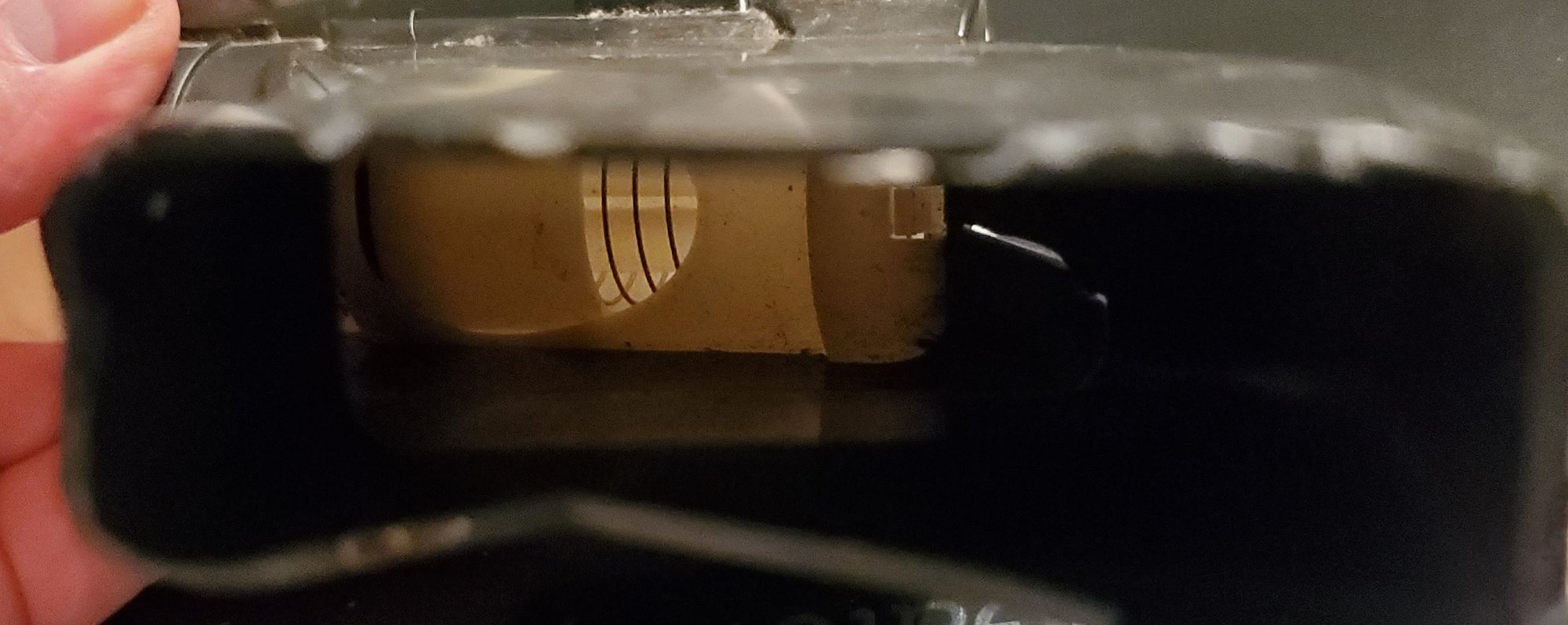

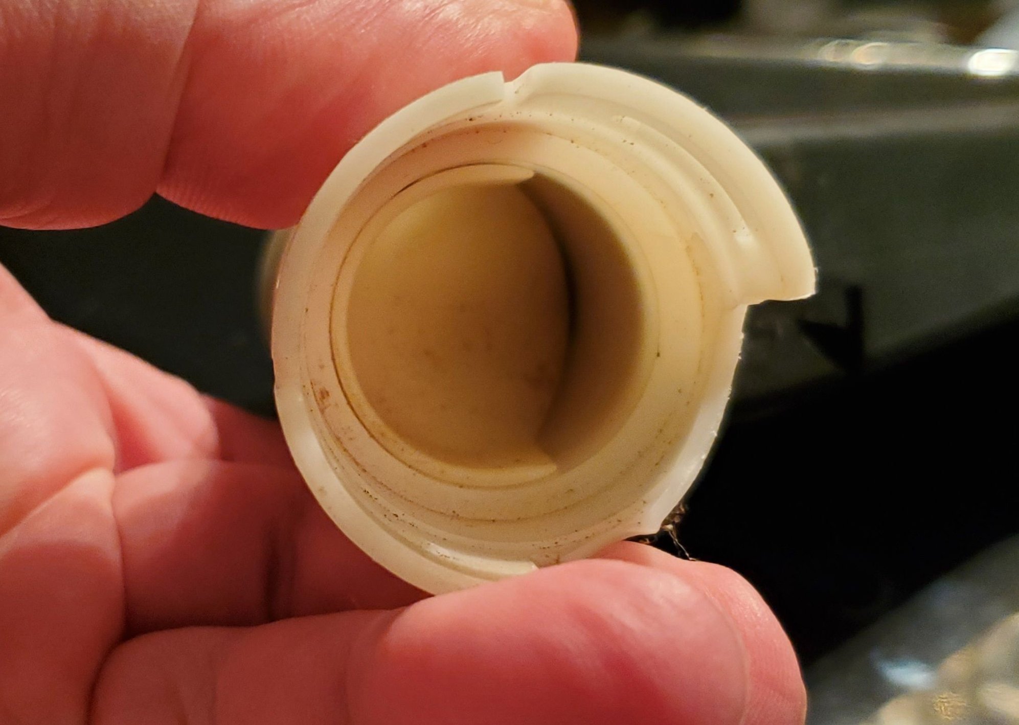

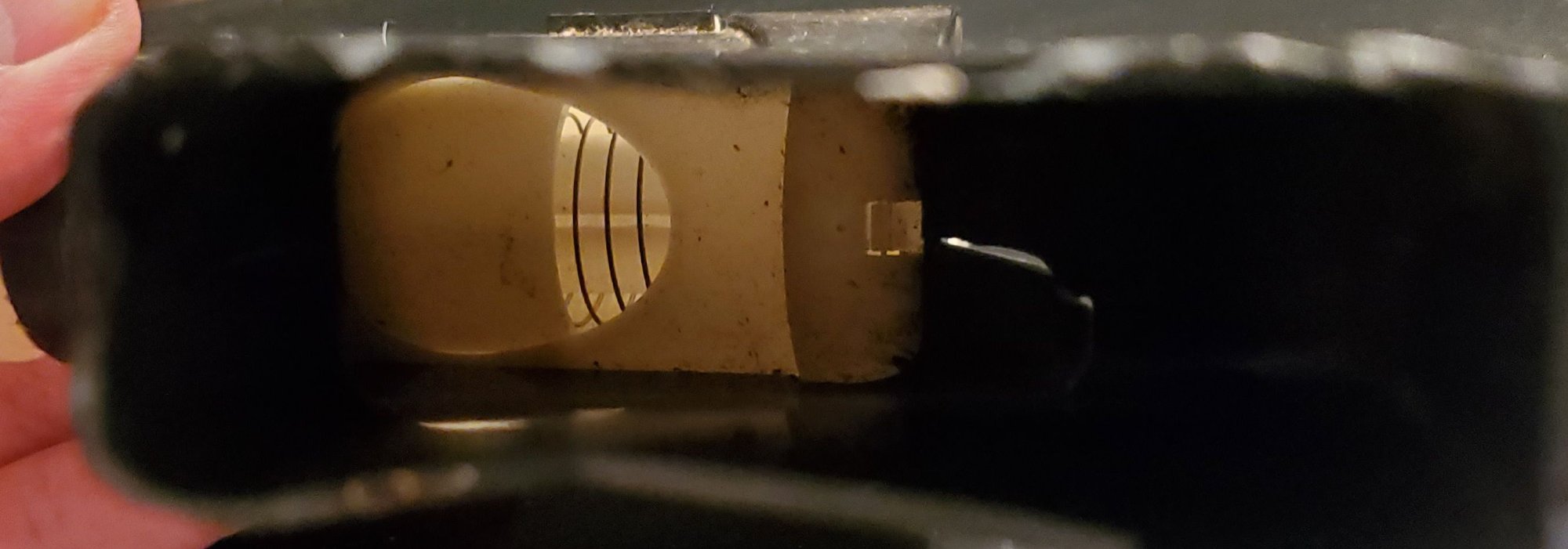

There is no drain plug, and as you found, a siphon will not work, as the anti-siphon / anti-splash back apparatus is in place, see pictures.

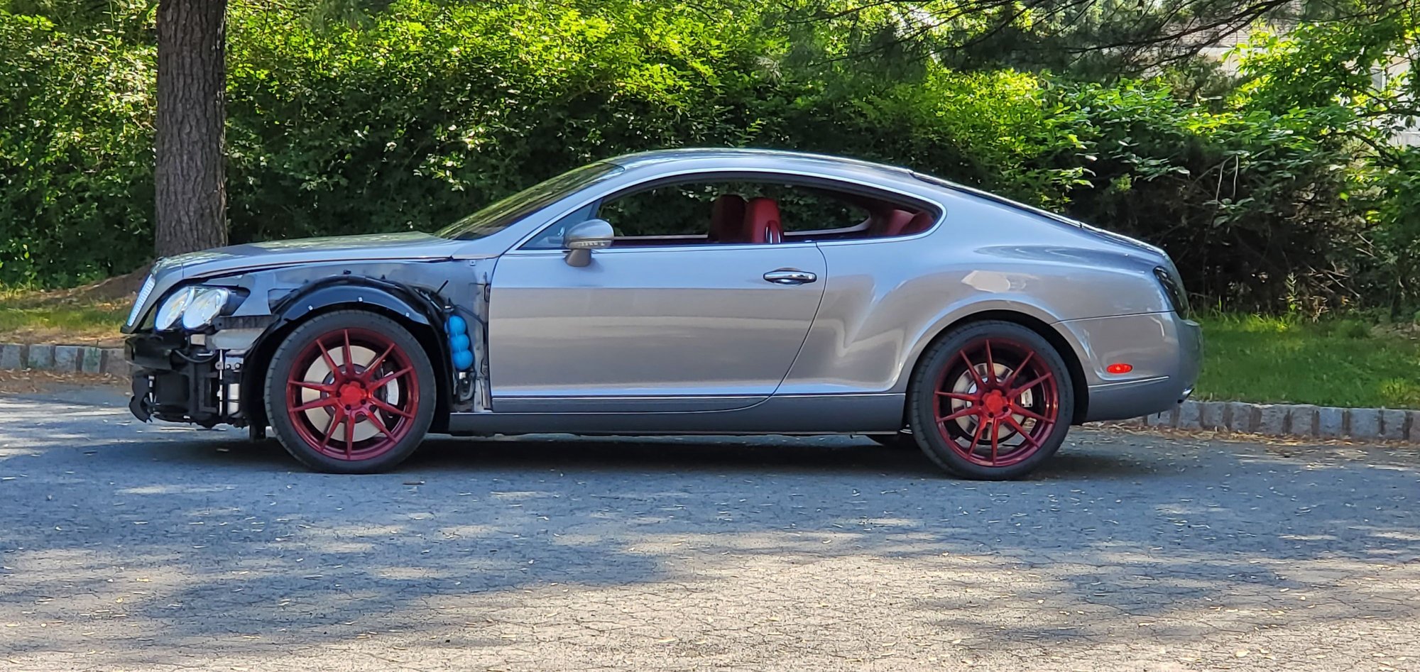

As to the age of the fuel in the tank, 1.5 years should be nothing to worry about, my GT rebuild had 3/4 of a tank in it from sometime before Sandy, being October of 2012, I fired her up for the first time since Sandy on December 21st 2020, so the fuel was over 8 years old, I did pump some fuel into a glass jar for inspection, but prior to that, I had done the smell test at the cap, along with removing both connection plates on the top of the fuel tank in the trunk/boot to inspect the tank for any water or foreign matter, the tank was extremely clean, the strength of the fuel as to vapor/smell, was extremely strong, I was shocked, I test drove the vehicle a few times locally 30 miles or so, then in May of 2021, I drove it to the bank and fuel station as pictured below and filled the tank, never an issue with the old fuel, as my system was sealed up tight, fuel cap in place.
