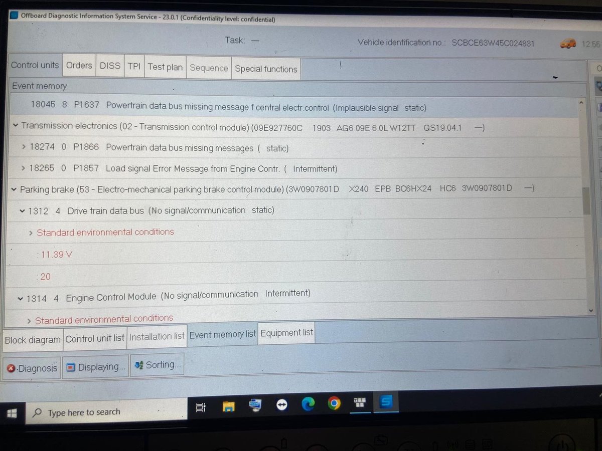

Hi all, looking for advice. I have been working on a early GT which has come in with the following lights on the dash. I have replaced the battery with a new one and still get the same lights. I have then checked the left luggage compartment ECUs which are both fine. I am wondering whether it is the Kessy module but am unsure.
I am wondering if anyone else has any advice or come across this problem before? Thanks

As to your issues, your picture is too small and unclear, please post a larger picture without the glare from the windshield, also tell us exactly which battery you replaced.
If you have a Ross-Tech VCDS or ODIS VAS scan, please post.

Hi, here is the photos of the VCDS scan.

You forgot the picture of the instrument cluster, along with answering the question as to which battery you replaced, the left side (House Battery), or the right side (Starter Battery).
Your pictures of the scan are not really what we are looking for, you should post the full complete scan as if you printed or saved it, just like others here do with a Ross-Tech VCDS scan.
Because your screenshots of the faults are so many, and I assume you are a shop working on the vehicle for a customer, what history do you have to share, what led up to the problems, what happened first, has anyone been at the engine ECU'S at the cowl area, or any other modules, as you have so many lost communications.
