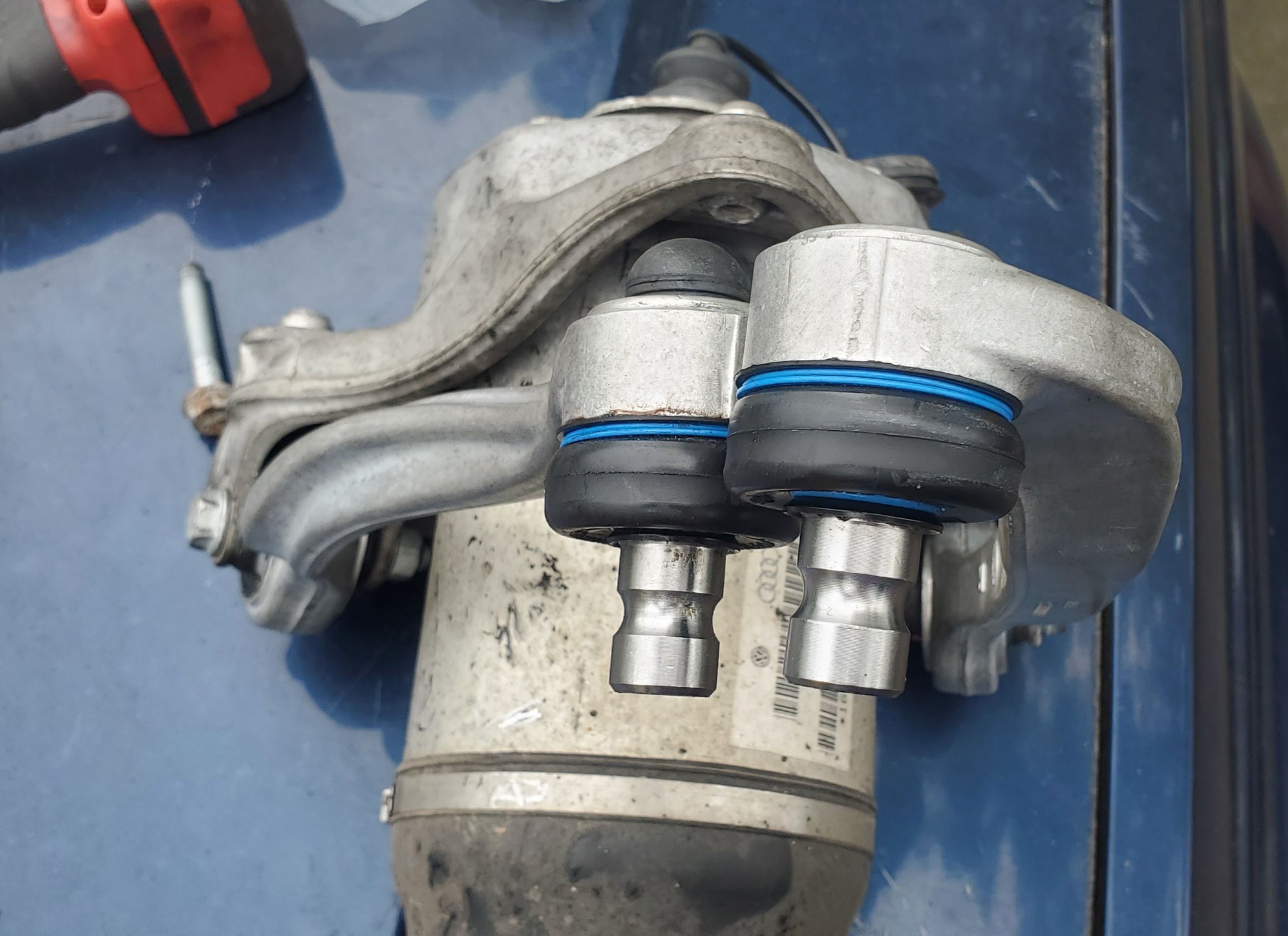

It might seem simple, but check that the droplinks for the sway bar have not been put on backwards. If they are on the wrong way round, they will rub at close to full lock. This is what they should look like - the silver thing is the droplink and the solid part is towards the back of the car like in the photo in the very bottom left.

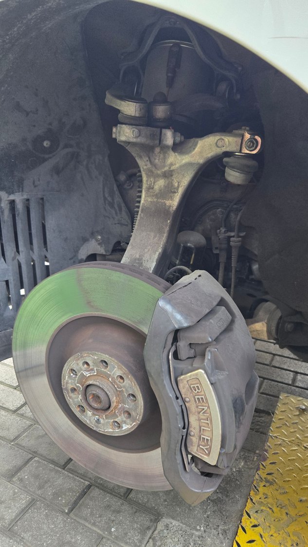

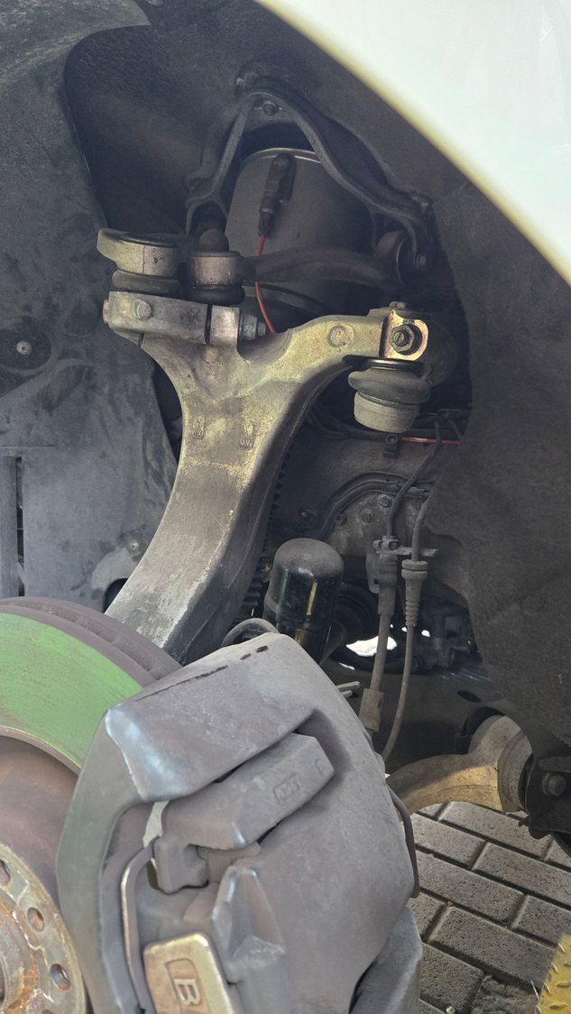

Old Jan 5, 2026 | 03:33 PM
  #29
Gt414's Avatar
Joined: Jan 2023
Posts: 29
Gt414 is infamous around these parts
Hello Guys here is an update in addition to 5 pictures if the car suspension components and wheels as requested previously
Alignment Done - Noise still there
Suspension Ball Joint changed- Noise still there
lubricant oil applied to suspension- noise slightly reduce but still there
my mechanic says my control arms and bushes need all be changed as fheyre slightlty broken, however ive only had them changed when 12 months ago and that literally when the noise problems happened it occurred immediately after changing these parts along with the airmatics...
Guys tell me what is it???
Old Jan 5, 2026 | 04:07 PM
  #30
Johnny Hotspur GT's Avatar
Administrator
Joined: Jul 2014
Posts: 3,956
From: Montgomery NJ
Rep Power: 1002
Johnny Hotspur GT Is a GOD !Johnny Hotspur GT Is a GOD !Johnny Hotspur GT Is a GOD !Johnny Hotspur GT Is a GOD !Johnny Hotspur GT Is a GOD !Johnny Hotspur GT Is a GOD !Johnny Hotspur GT Is a GOD !Johnny Hotspur GT Is a GOD !Johnny Hotspur GT Is a GOD !Johnny Hotspur GT Is a GOD !Johnny Hotspur GT Is a GOD !
Hello @Gt414 ,
Very long time for response...
As to the noise, you did not respond to what @09Speed stated, and being that you now say the noise started upon replacement of those parts, it is very likely that the control arms were not installed correctly, meaning, in the correct position, they are to be installed and tightened in the position as if the vehicle was planted on the ground with the suspension loaded, if the were tightened in the hanging down position, then upon loading the weight of the vehicle on the suspension, the bushings get torn, then become loose with play, and if your technician is telling the control arms are bad already, then that leads to improper installation last time.
Johnny
