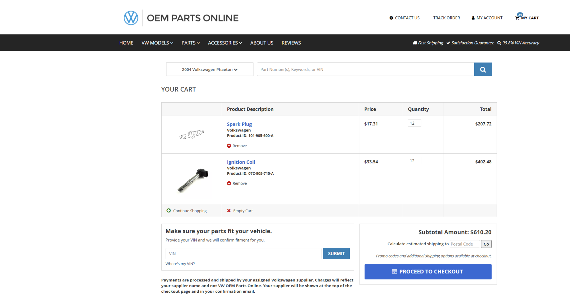

I feel like since my car has over 90k miles this motor will cause the same amount of problems for example if the starter goes out don't you have to remove the engine just to replace it? But i guess you are right, I should just rebuild this engine and tune it up. Also, guys I have an another post, im trying to buy some spark plus and coils and was wondering if there Volkswagen phaeton ones work.
