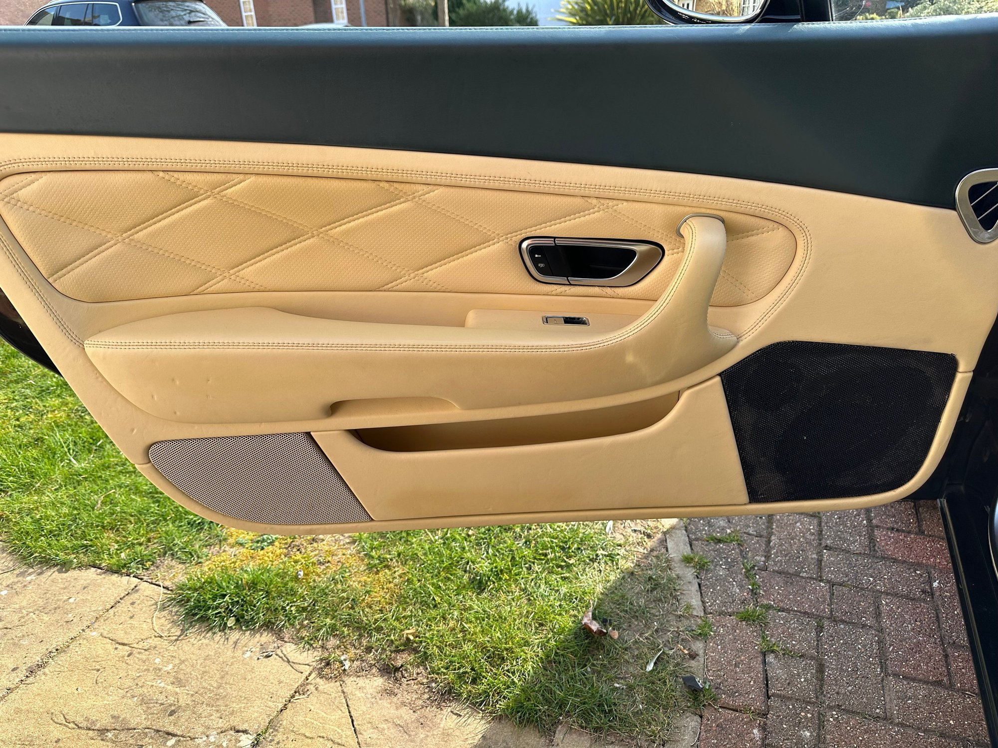

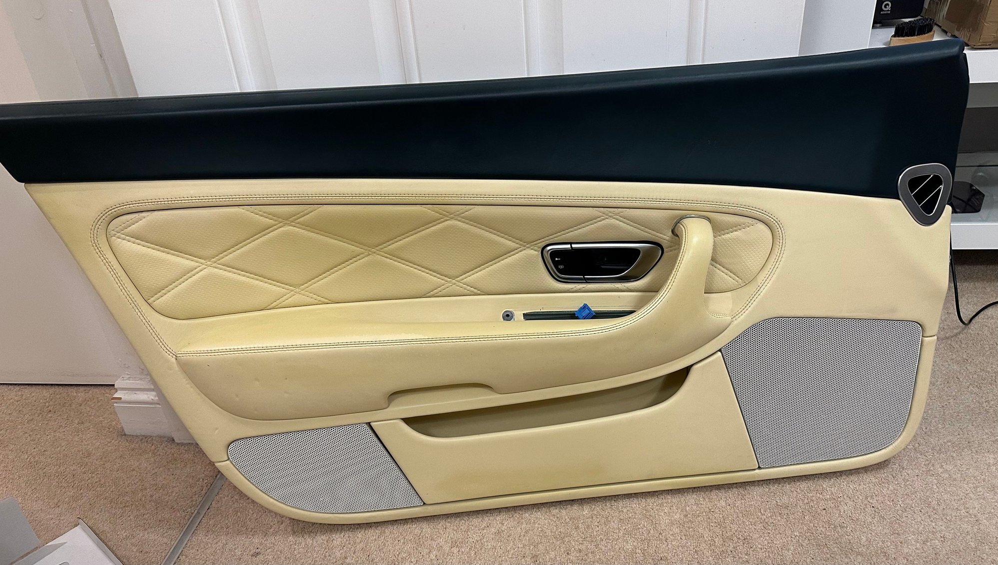

Firstly, something I noticed before buying the car is that for some unknown reason, a PO had decided to paint the foremost speaker grills black…
Looks bloody awful. Not only that, but they hadn’t bothered to take them out of the doors so there were bits of black paint on the corners of the recesses, and in the inside edge of the door pockets. And to top it all off, they’d used a thick black paint, probably Hammerite, and used A BRUSH to apply it!!! This has resulted in thick globs of paint effectively blocking vast areas of the grilles. What on earth goes through these people’s minds?!?
I took both door cards off and removed all grilles. I split them down, used a paint stripper on the metal grilles (this stuff took HOURS to get off) and cleaned up the plastic backing pieces. I discarded the foam (it was ruined by the paint). I used magnolia coloured radiator spray paint on the now bare metal grilles, cut fresh 3mm acoustic foam to size and reassembled them. Now, they’re back to how they should look…
Much better.

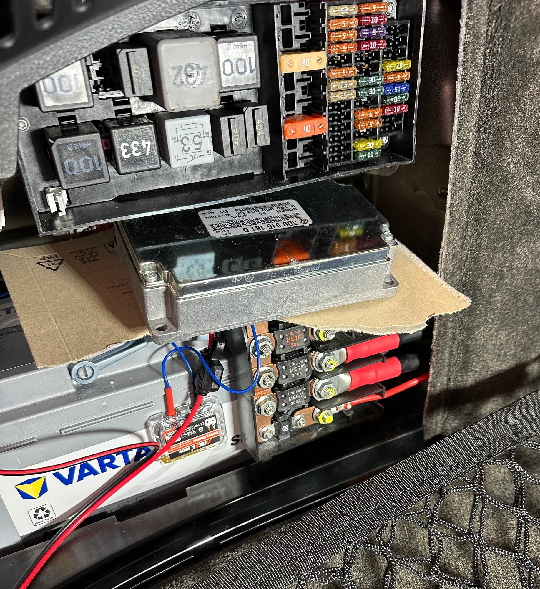

After that, a new battery management module 3D0915181D was delivered, and I was able to fit this temporarily above the carefully insulated system battery:

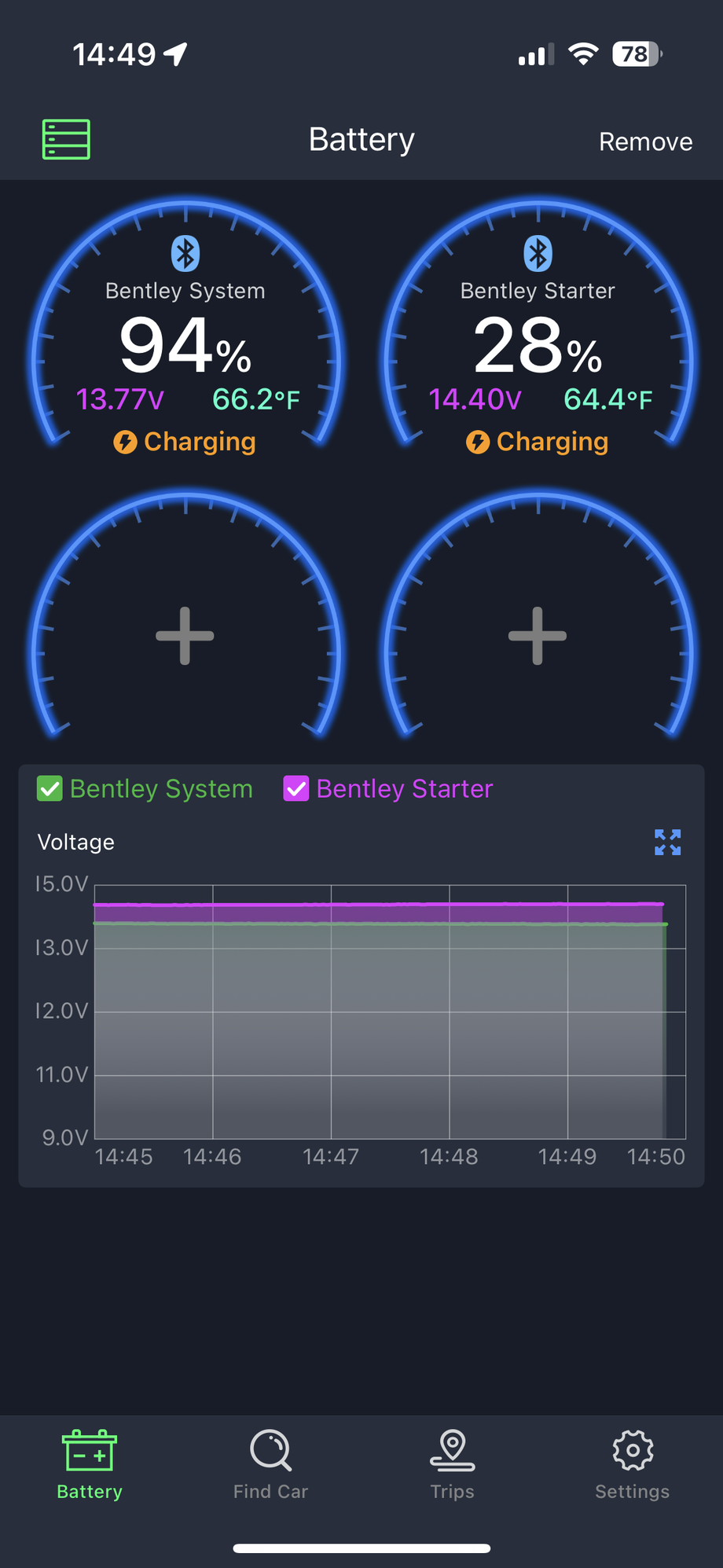

Upon starting and allowing the engine to idle, my Bluetooth battery monitors reported that both batteries were now charging normally - this had never happened before:

The new (used) module is actually from a Phaeton and has the same part number apart from the last letter (D instead of C). I’m assuming there was a revision as this unit has a manufacture date of ‘09, but seems to work fine.

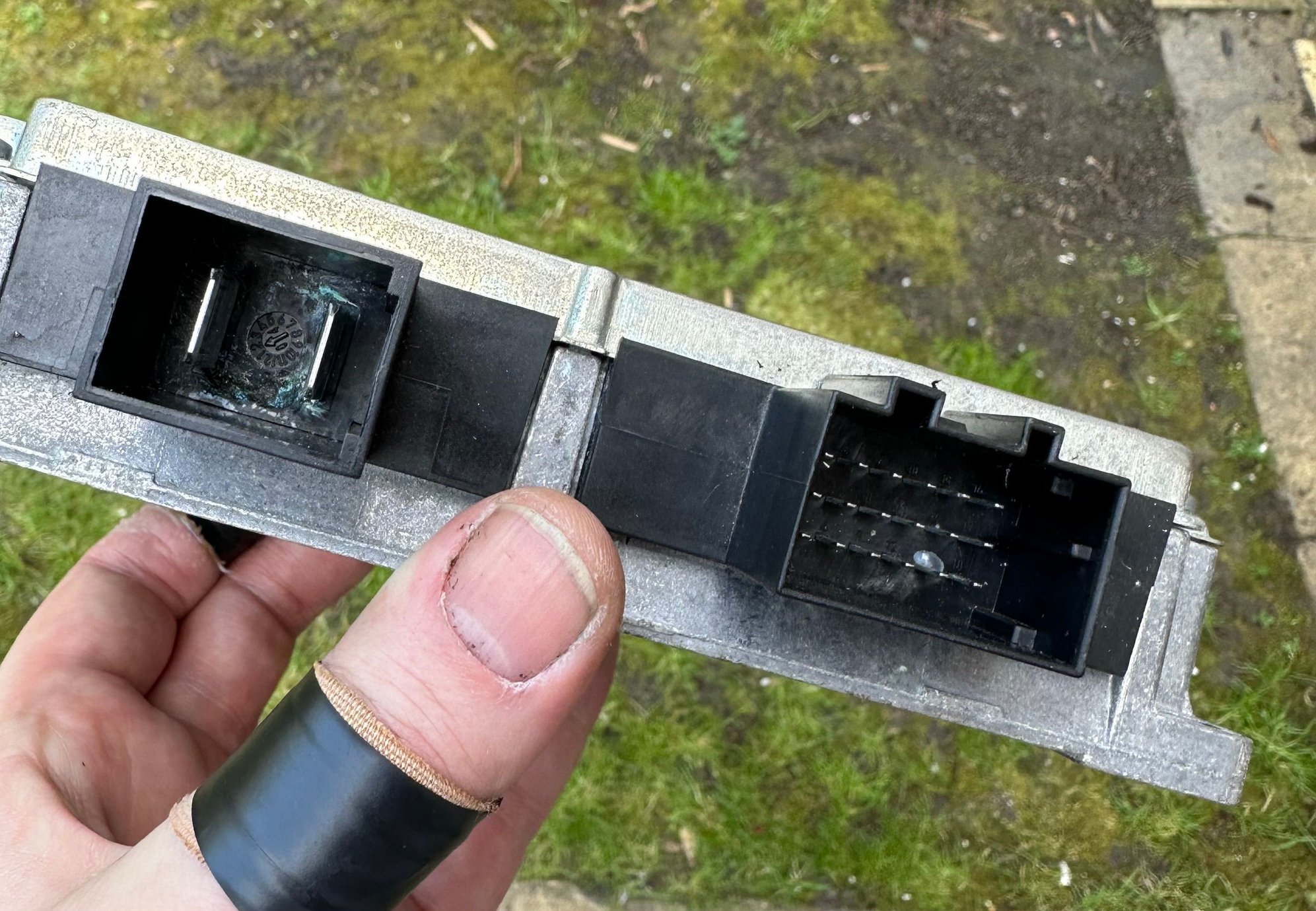

Traces of corrosion at a couple of the terminals on the old module, maybe?

Hello @DanW12 ,
May I ask which bluetooth app and dongle you are using to monitor both batteries ?
Johnny
Old Apr 4, 2025 | 10:05 AM
DanW12's Avatar
Joined: Mar 2025
Posts: 45
From: UK
Rep Power: 13
DanW12 has much to be proud ofDanW12 has much to be proud ofDanW12 has much to be proud ofDanW12 has much to be proud ofDanW12 has much to be proud ofDanW12 has much to be proud ofDanW12 has much to be proud ofDanW12 has much to be proud of
I bought 2x Ancel BM200 units - you can see one stuck to the side of my system battery in the photo above. Very cheap (less than £20 each) and very easy to set up and use.

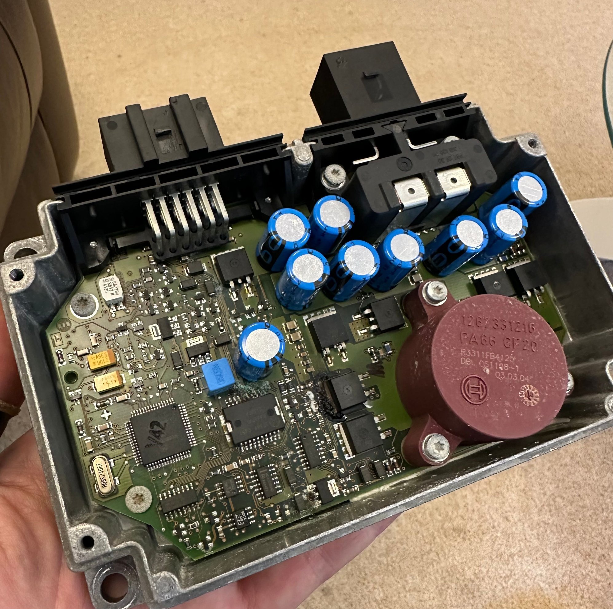

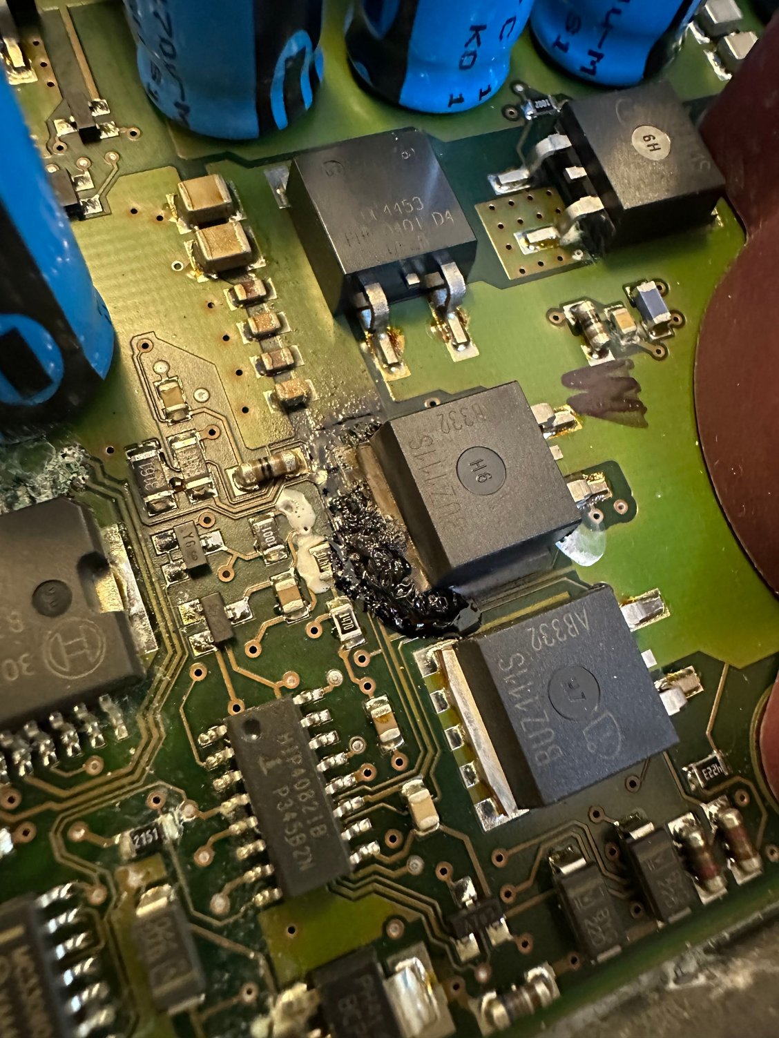

I think I’ve found the failure point of this particular module….

Johnny Hotspur GT Is a GOD !Johnny Hotspur GT Is a GOD !Johnny Hotspur GT Is a GOD !Johnny Hotspur GT Is a GOD !Johnny Hotspur GT Is a GOD !Johnny Hotspur GT Is a GOD !Johnny Hotspur GT Is a GOD !Johnny Hotspur GT Is a GOD !Johnny Hotspur GT Is a GOD !Johnny Hotspur GT Is a GOD !Johnny Hotspur GT Is a GOD !
Simular to this BUZ111S, not sure on the other digits.

@DanW12 About time you had abit of luck Dan ... Whats the story on the fingers with the smart tape wrap
Fookin Hammerite paint proper Bentley Owner then

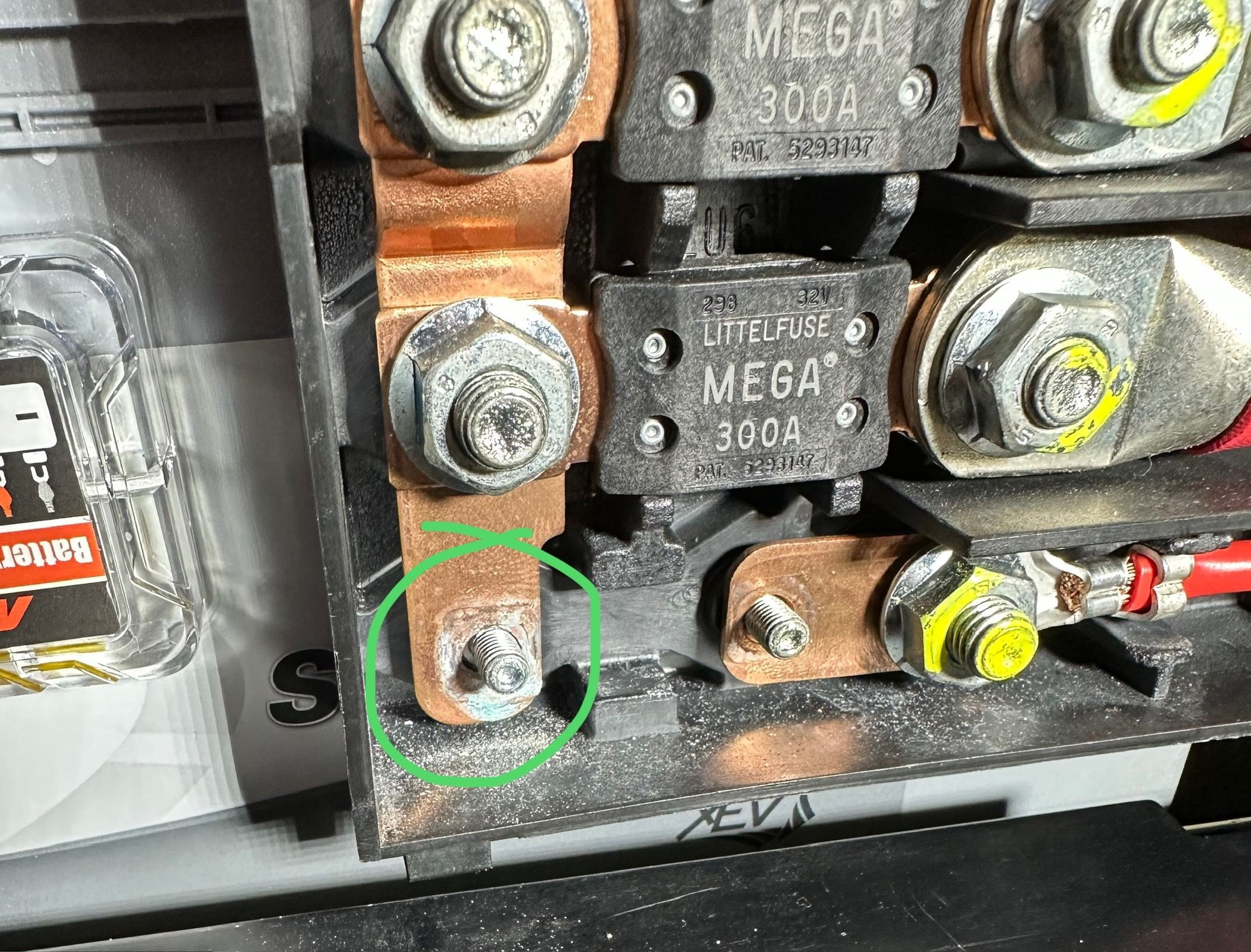

So started at the systems battery and checked all the fuses, starting with the bigguns, and found no continuity on fuse F3, 80A. When I undid the nuts and took it off, I found a load of white oxidisation on the bus bar terminal:
Gave it a whizz over with a dremel grinding bit, same with the fuse terminals, put it back on and since then, no more electrical dropouts! Looks like that corrosion was allowing only a small amount of current to pass through the fuse, but would register faults and shut down the larger consumers (ie seats and amplifier) on the circuit when they tried to draw higher currents. Such a relief!
